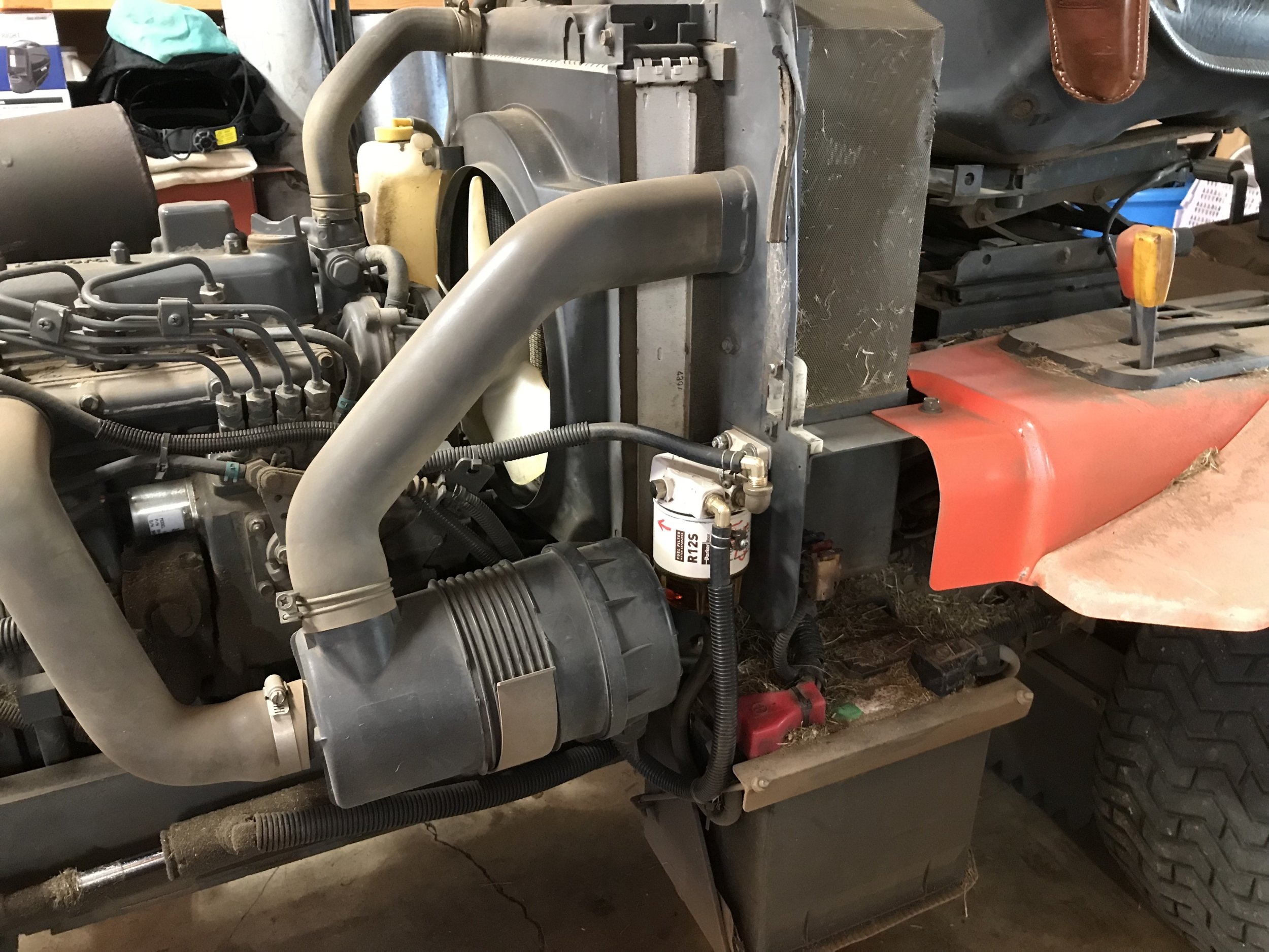

I finally got around to it couple of months ago and replaced the secondary fuel filter on my F3060
Other members have done it and posted in TBN - thank you for the photos, they were helpful!

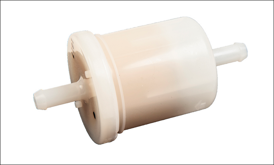

Obviously the factory setup works OK since my mower already has about 3700 hours, but I just did not like how there were two identical (probably 50 Micron?) filters in-series, one before the electric fuel pump and another one after it.
New Racor Secondary Filter:
The original fuel filters:

Nice install. I had to add an additional electric lift pump to my Racor install on my ZD1211. After bleeding the system the engine would run full throttle, but would starve for fuel when under load (one pump).The original pump has 1300 hours on it... I wonder if it was just getting a little weak? If I get (real) bored I may try running it with one new pump.

Thanks,
Yes it's a pretty fine filter - mine has been OK so far and there is quite a bit of "extra" fuel returning back to the tank when engine is idling, which is very easy to check on this model.
No easy way to check the return flow when mowing and the engine is under load.

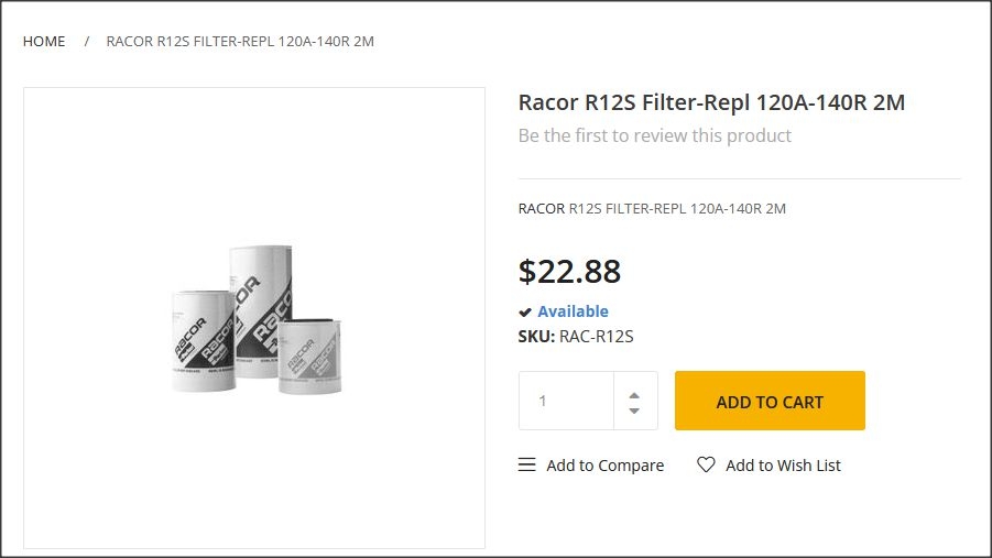

Where did purchase your Racor at and what part number is it?

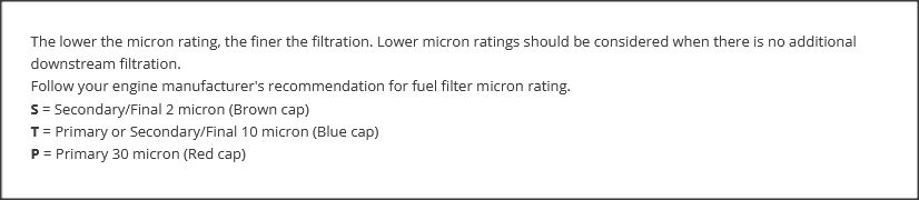

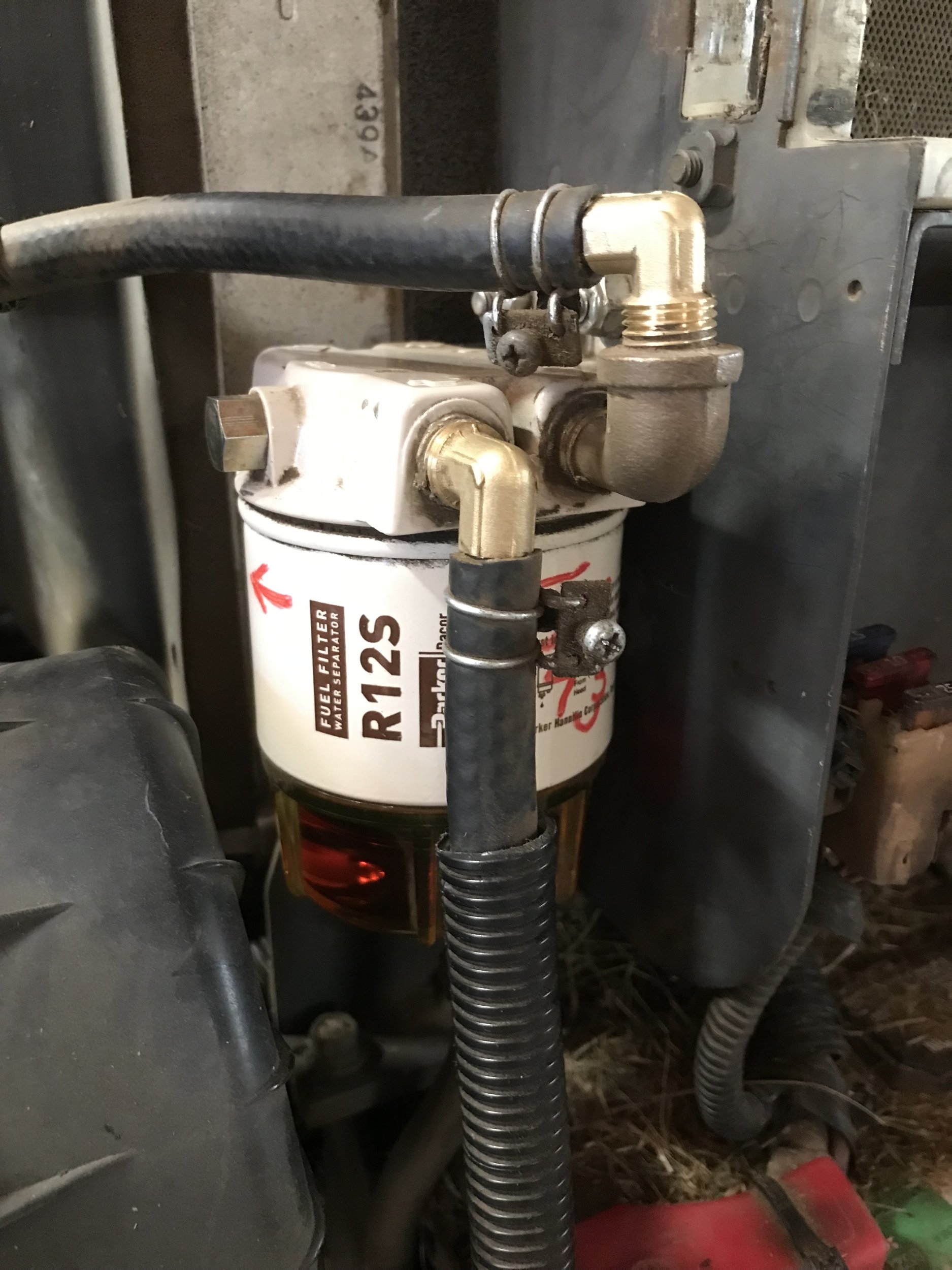

It is Racor 120 series with R12S (2 micron) filter, and they are easy to find at racorstore.com or marine parts store/supplier Bay, Amazon or etc.
Not sure where I bought mine since it's been sitting in a factory box on my garage shelve for many years.
There are many cheap almost identical looking Racor "clones", just be aware some of those seem to have a metric pipe-thread connections in the housing, which will complicate installation a little if you need to use standard 90* elbows etc. like you see in my photo.

Actually, I used IFJF bases with Racor filters and the IFJF bases aren't metric pipe thread but SAE. Heck of a lot cheaper than the Racor bases are btw. Bought mine on Amazon and all of mine have a fill plug on the top of the base so bleeding out air isn't an issue. I just use a Turkey Baster and fill them up and put the fill plug back in.
The IFJF bases accept the Racor filters as well as the clear bowls. In fact I used the supplied with IFJF bowl because mine came with a drain cock built in. Got one on each of my M9's and one on my diesel pickup truck and will soon have one on my F20 when I get it.
It's a Chinses copy but perfect in every way and the IFJF bases come with all the necessary fittings as well. I bought them about 2 years ago and I believe I paid under 30 bucks for each.

I would check Facet brand small 12V fuel pumps for replacement if new pump was ever needed.
The original fuel pump has been perfectly adequate, and in F3060 it's easy to check the excessive fuel flow returning back to the fuel tank, but I have only checked it with the engine idling.
I just did over two hours of mowing yesterday and it worked fine.
PS.
It's easy to switch to Racor 12T (10 Micron) if pump capacity ever became a problem.

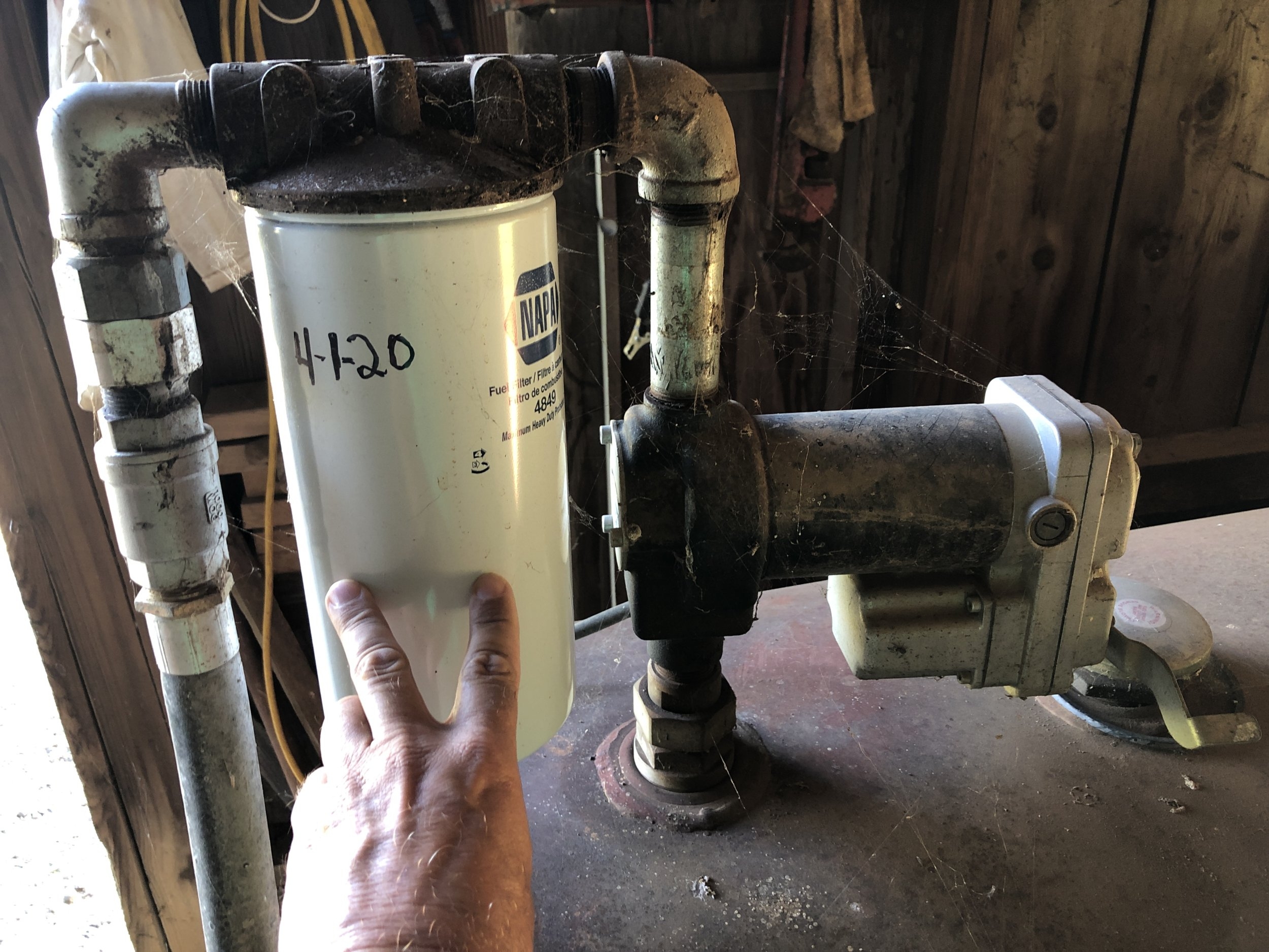

I run a 10micron 3qt spin on filter with hydroZorb membrane for moisture on my 550gal tank.
Both mowers & 3 tractors gets filled from this tank weekly.
This setup was EXPENSIVE but I hadn’t replaced a fuel filter on any 5 units in 4yrs.

This setup was EXPENSIVE but I hadn’t replaced a fuel filter on any 5 units in 4yrs.View attachment 861655
I see you have some galvanized fittings on your setup. I've read that galvanized fitting will shed the galvanic coating over time and will adversely impact high pressure fuel pump performance.
/ F3060 2 Micron Racor installation #19
It’s possible.
The fittings on left side is aluminum.

Aluminum must be fine to use since manufacturers use it in places where there is Diesel fuel.
I also remember having read something about galvanized fittings & Diesel fuel not being good combination so I've used brass fittings over the years.
For me 55 gallons usually will last 10 months, whereas some of you guys can probably use it up in one day...
