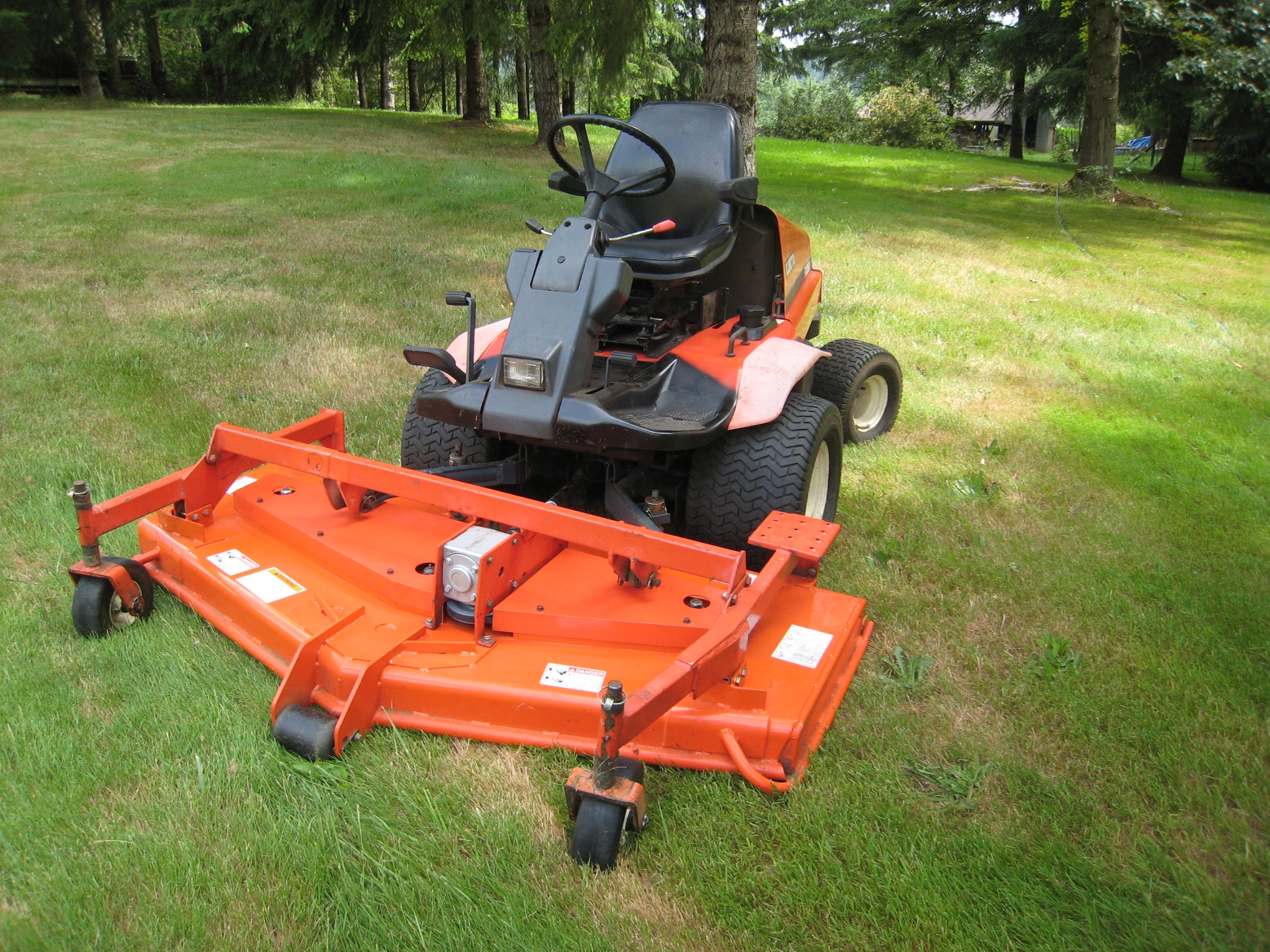

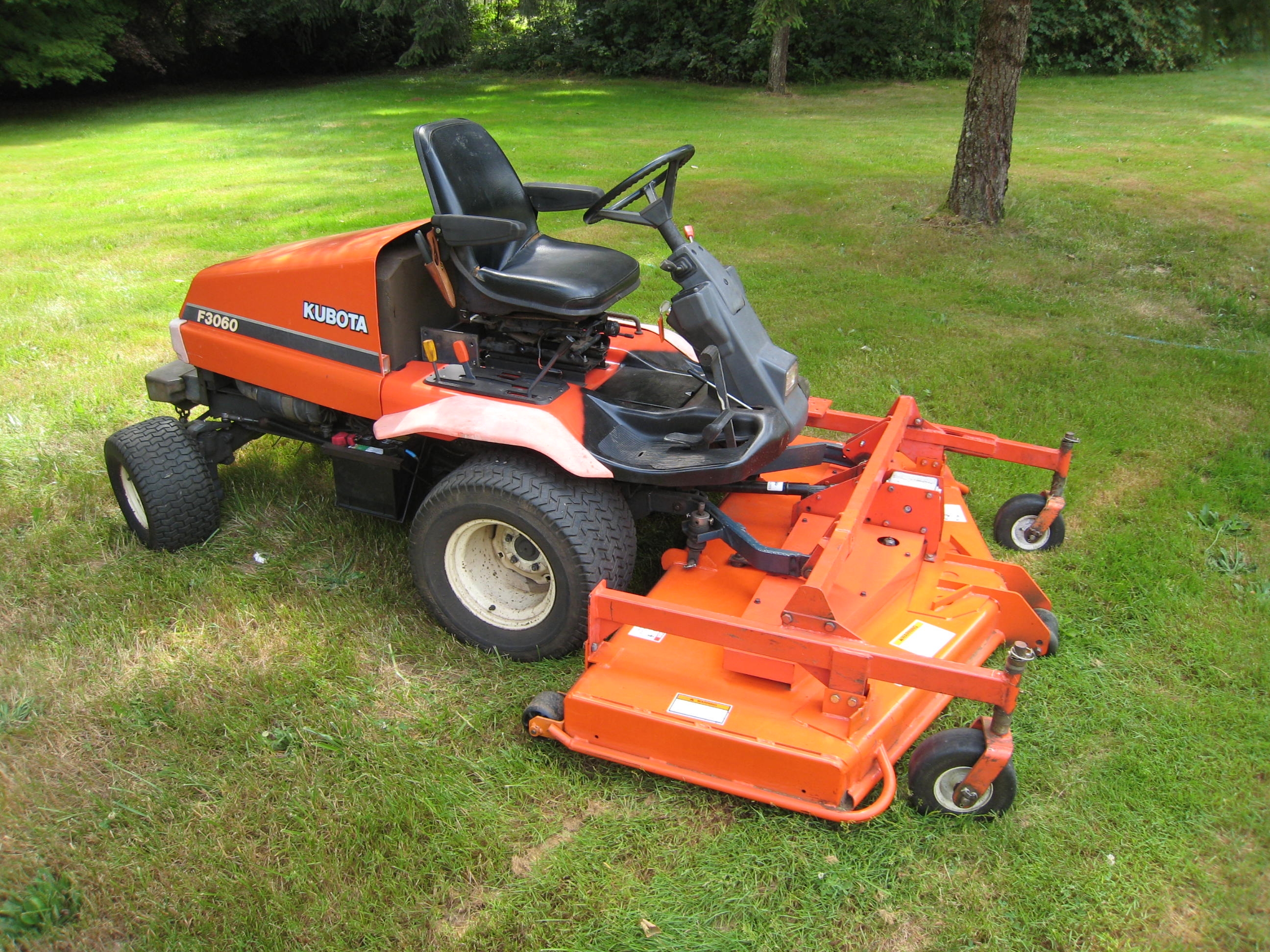

Does anyone with an F series mower have a problem with the left front of the mower deck scalping? I was checking out a new F2690 at my local dealer and noticed the 72" deck could very easily scalp some turf if that front left corner of the deck came up on a small hill/bump. Maybe an extra roller could be mounted there?
This is a 72" RD deck on my F3060 and it's always set to 3.5" cut and has never scalped the grass so far.
Our yard's grassy area is fairly large and not smooth.
Not sure how different the deck you were looking at is, but couple of photos would help.
