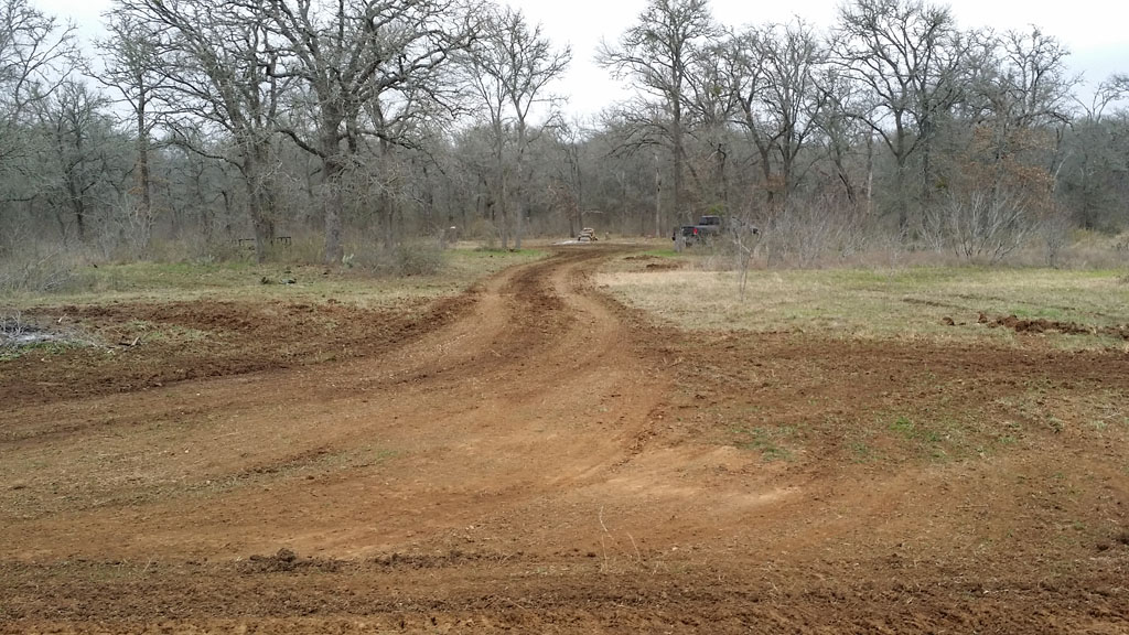

I was hoping I could get some help planning my driveway construction. Searching didn稚 produce any answers to my specific situation but I read many posts about road construction and gained some great knowledge. Thanks TBN.
The initial portion of our driveway is going to be 12' x 200' and travels downhill at a 4-5% slope. The soil is high clay content and has a pretty high rate of shrink / swell. (So the soil reports says.)
For the road subbase, we will remove top soil down to 8 which is where the red clay begins. After the subbase is leveled and compacted we will be installing geotextile woven fabric. Then we will put 8 of 3肺1 crushed limestone for the road base. There is no fine materials in this rock. It will initially be compacted with loaded vehicles. My plan is to get this portion of road built so we can begin construction of the home site.
We hope to leave the road like this (no top coat) for the heavy construction equipment to drive on. Once construction is complete (could be up to a year) we plan to come back, add more base rock to any low spots, reshape, then add 4 of top coat gravel. For the top coat plan to use a 1 3/4" limestone road base aggregate (called city base in my area) containing a lot of fines. I may come back later and add a layer of small limestone gravel for apperance.
My question is, will I be doing any harm to my subgrade and road base by leaving it exposed to rain during home construction? Without the top coat, the water will easily enter the rock base and permeate the subbase. To help with drainage during this time, I plan to put a temporary drainage ditch at the end of the road so that water that makes it to the subbase will drain out and not collect.
Is this an OK plan or should I install a top coat before the big trucks drive on it?
Sorry for the long post, lots to explain. Thanks for any help.

I wouldn't be concerned with getting the top coat on maybe get an extra load set to one side in case any soft spots show up. This is normal practice here in clay so the site is accessible when it's wet. We don't have lime stone but use 3 or 4" crushed rock.

I won't profess to be an expert road builder, however this is what we did with our black clay muck. We did nothing for the road during construction of the infrastructure and buildings, we let the heavy equipment roll right over it and pack it. We did not let anyone drive on it during rain and waited a few days after so it dried a little. Once most of the heavy trucks were done I scarified it to remove grass and leveled it out. We did not use any fabric, just hard packed good road base. It is about 4-6" deep in most places, a little deeper in others. It has worked beautifully, it has packed down with rain and traffic to almost like concrete. The more it rains and we drive over it the harder it has packed.
Start at post 219 here for a better idea of what we used.
http://www.tractorbynet.com/forums/south/313136-small-texas-farm-beginning-22.html
My concern with your plan is without the fines, the sub base will just get pushed to the sides from the heavy trucks and tear the fabric. It is the fines that lock the pieces together as I am sure you know, without them there is nothing to keep the sub base in place. The way we did it may not be perfect but it has worked beautifully. We may go back over it with decomposed granite but we also may not, it looks good and is very densely packed. It has been a great road for being over clay.

Your road looks great Jack! Thanks for the help. I had not considered the fabric tearing under the shifting loose rock. I think your on to something. I already got my truck stuck on the temp road when it was too soft. Lesson learned. I think for our situation, we may still want to get rock down for the big trucks since it typically takes 4-5 days after a rain for the temp road to be driveable. The slight uphill grade to get back to the county road makes things more difficult without some rock to roll on.
After seeing what you did and the good results you had, I think we will still follow most of our plan but instead of 8" of the 3 x 1" crushed limestone, we will put down 8" of city base and have a pile on hand to add to low spots as they show up. Then after construction, I can add a couple more inches of the city base and reshape.

I think you should plan on the drainage being permanent, not temporary, and built to last...the clay will tend to act like a channel keeping the water in the gravel, even after more layers are on. If you plan now on how to manage that water, I think you will be a step ahead...?

I totally agree. I plan on having the ditches set up properly in this first phase. The drainage I was suggesting was because I had previously planned on using the crushed limestone with no fines as the road base and was going to leave it exposed during construction, which meant that water was going to enter the area where I had dug out the top soil to 8" below grade. I didnt want the water to collect at the bottom of the road below the road base rock. However, this is no longer an issue if I go with the city base with fines since it will compact and shed the water to the ditches. Thanks!

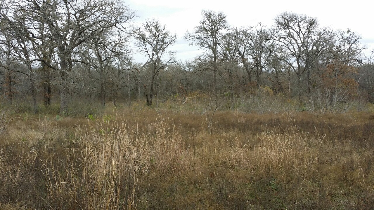

I decided to share a pic of the same area before we started any work. It took a lot of "vision" to see what this place could be once things were cleaned up. Lots of dead oaks and overgrowth to contend with so far. The property has not been maintained, ever. It's a great feeling when things start coming together.

Here you go Brent. I have filled in low spots and leveled as needed a few times.
This is for size reference.
/ Exposed road base - driveway construction question #12
This is what the main road looks like after many years of weather and vehicular traffic. It looks to be the same as what you are going to use for base. I am going to have to take my little tractor out and work on the main road but my list of chores is massive so it will have to wait.
Isn't is amazing how a little time, money and hard work can transform a piece of property? If you go back to the beginning of the thread I linked you can see what challenges we have had to overcome. Be thankful you do not have the cedar mess we started with. We had plenty of dead Oaks but fortunately there are lots of live and mature ones as well.

Hiya neighbor,
I am not a road expert either, but that will not stop me from offering advice--we do have a 3/4 mile road base road on similar clay soil with the same high level of elasticity (not sure if Coupland is on the Blackland Prairie). 4 of us share the road and we have maintained it for the last 15 years.
I am not sure if compacting the "raw" subbase after you remove the top soil will add any value. The soil engineers we used told us that attempting to compact the undisturbed clay was a waste of money. The clay soil was already so dense that it would not make a difference.
Also, I would be concern about putting the road base down over the crushed limestone. I am not directly familiar with the material, but my concern would be that the fines from the top layer of base would migrate down through the gravel. Keeping the fines locked in place is the key to keeping the road in good shape.
I would remove the top soil and just do the road base on the fabric for the build with plans to clean it up afterwards.
