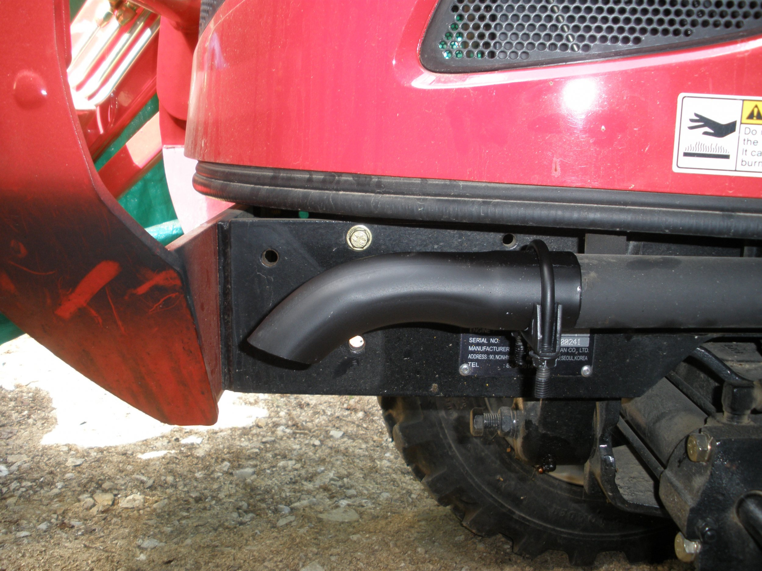

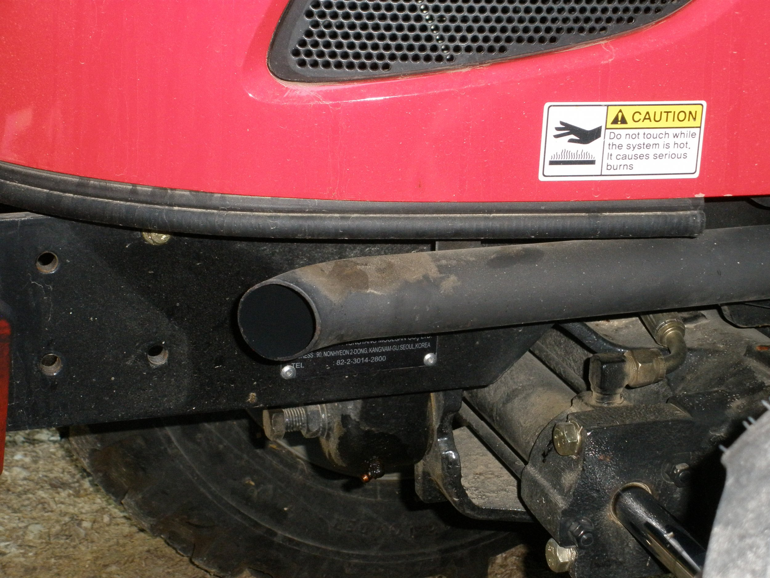

I went to a muffler shop and had them size an elbow to redirect the exhaust on my tractor. Less than $10 with the clamp!

Joeyd looks very good but my concern would be that in dry conditions it will be blowing dust up which gets in your eyes was my experience so I rerouted it from the motor out the back on my last 2 small tractors.
You are right it did, I rotated it 45 degrees to the outside and it is much better.

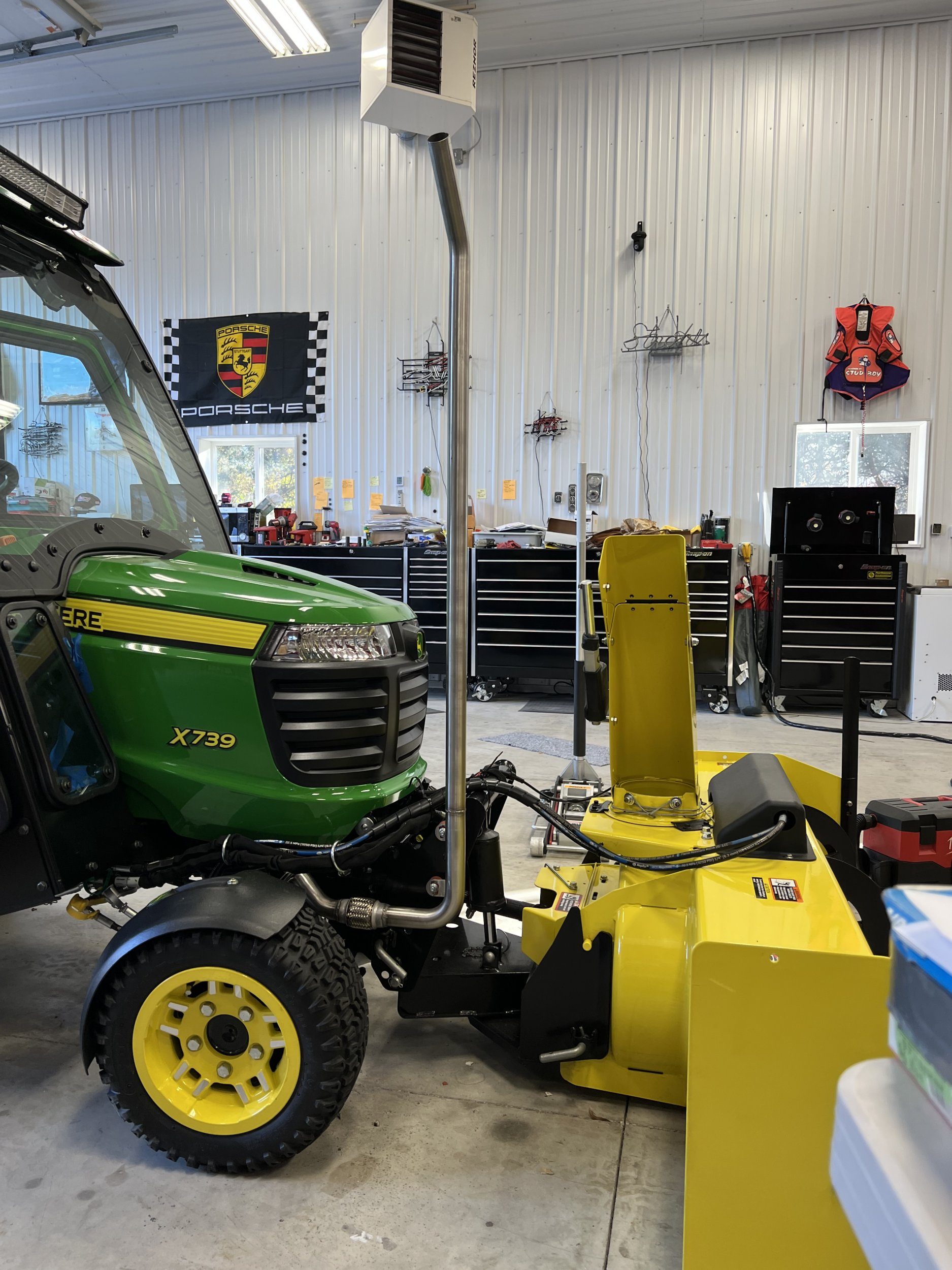

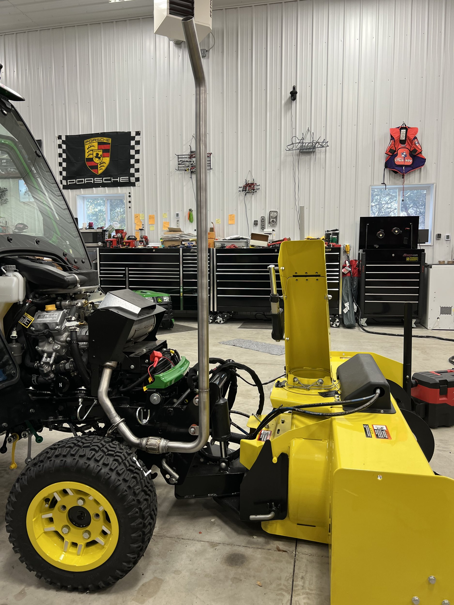

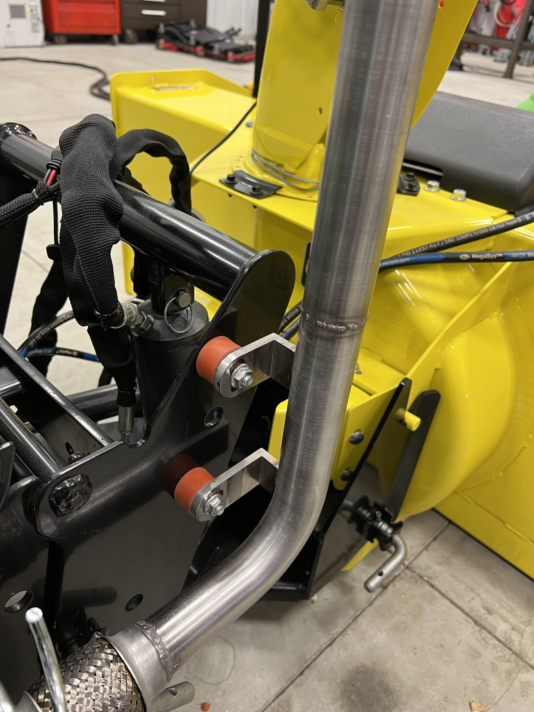

This what I did on my X739 Deere.

That's great. When i was looking at the thumbnails i was thinking 'no way that doesn't break mounts unless they're STRONG' and then i opened that 3rd pic and said 'nevermind!!'. Those mounts look good!
