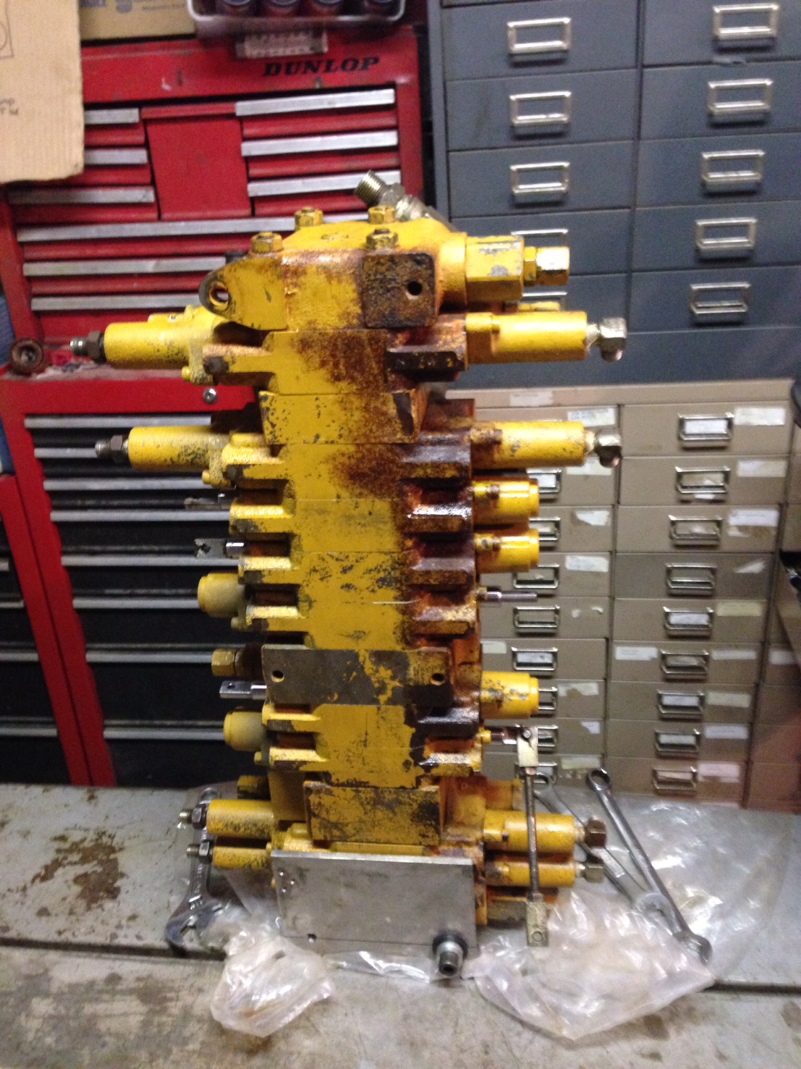

...........and if it doesn’t have a clear open path in neutral and blowing over relief it will heat, or worse go boom. Do you have any pics of said valves you are planning to plumb the gear pumps for drive?

I’m wrong about a closed loop hydrostatic. Like you said It appears that this valve is fed from both ends from your two piston pumps and the common return is the largest fitting in the center, no? A lot going on here, not sure how a gear pump would work unless some sort of unloader valve was used between the gear pumps and control valve.
/ Excavator hydraulic pump help ?
#40
So basically what you are saying is the volume of oil coming in from the pressure side would be too much for the return side.
Yes exactly, it’s fed from the ends and returns from the center
