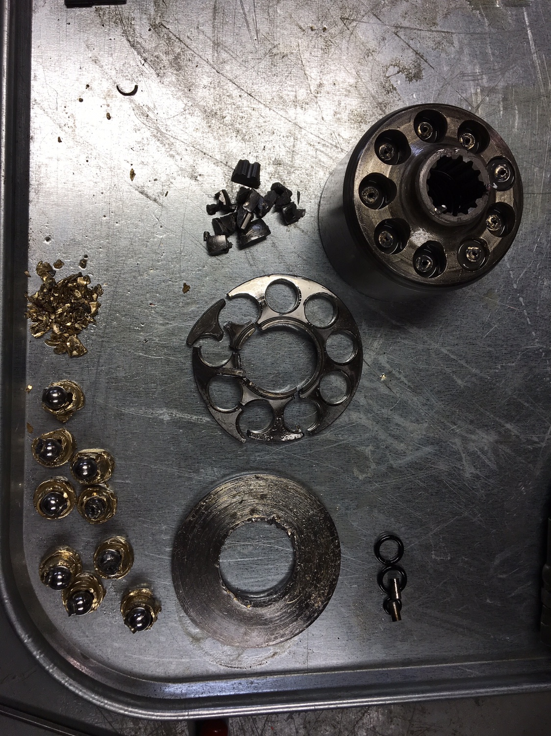

Here is a picture of the latest failure
/ Excavator hydraulic pump help ?
The case drain from the pump is routed into the suction side of the pump. There is no way for it to build case pressure. It’s a Uchida Hydromatik pump. It’s an odd ball even by pump standards. Sure I can put another one on for $3-4K but is it even worth it. If I could slap on a $1000 gear pump and it would work I’d do that. I’ve seen so many pieces of equipment treated like crap, dirty fluid, filters never changed and still going on a gear pump.

Uchida is Rexroth licensee in Japan. They build good pumps. Find someone who knows Rexroth pumps, you likely can find parts or a suitable replacement.
Got any pics of the lens plate or face of the rotary block? You need to look at your case drain and suction side. Make sure you don稚 have suction screens that may be plugged or holding trash. I really don稚 like suction screens. They likely kill more pumps than they protect, IME.
/ Excavator hydraulic pump help ? #12
My first observation was the pistons deheaded and piston retainer ring (ring with 9 holes), they were broken from excessive vacuum on the suction side of rotating group (depending on what direction of movement). So now I see you say the case drain is routed to the suction side of the pump, I can’t see this going too well if a suction screen or filter is plugged or restricted. The purpose of the charge pump is to keep a positive pressure inside the hose loop between each pump and motor rotating groups, when damage/wear starts blowing excessive amounts of oil out the case drain it’s an indication of too much clearance in the mechanical parts of both motor and pump and is suppose to route the extra oil back to the reservoir. I’ve not seen any case drains routed to the suction side, maybe it is normal for this machine but I have not encountered it.
The broken retainer ring broken and every piston deheaded shows too much vacuum IMHO.
You mention rebuilding the pump several times, but no mention of pulling the final drives. Whenever any catastrophic damage like this is encountered it is mandatory to pull the corresponding component to (at the minimum) do an inspection and complete clean out and repair any damage done by fragments running thru the final drive.
The previous owners failed at finding the root cause so I suspect you just unknowingly carried out the problems to this point. Putting in a positive displacement gear or vane pump is only going to work if you add open center control valves and replumb the existing hyd lines. Just retrofitting a new gear pump is only part of the work.

I agree with wdchyd in that this is a system - circuit problem and not a component problem. Case drain connected to inlet is not the best circuit since case drain oil is the hottest and dirtiest oil in the system so running that right back into the inlet of the pump is just adding heat and dirt to the system.

I’ve gone through every inch of the hydraulic system after it fail including the finals. The suction strainer in the tank is new and because the strainer isn’t on the bottom of the reservoir 90 percent of the junk just sat on the bottom. After I had filters on everything returning to the tank the only debris I found was in the area of the pump. The machine was barely above idle when the pump failed.

If I was a betting man it looks to me that the center cone shattered first. I’m only running 3000psi max. Each side of the pump has a main relief at the valve control body. The machine has a big oil cooler on it. It’s has an extra valve for a hammer and I know those make the oil hot. I have never put a hammer on it though.

I respectfully disagree with your failure analysis. My thoughts in looking at those failed parts is that something is causing the slippers to lift off the swash plate. This can be caused by excessive inlet vacuum, high case pressure, pistons binding in the cylinder bores or combination of the above.
What does the bottom of the cylinder block look like and the mating wear plate?
I have experienced suction hoses failing when the inner tube in the hose collapse and the outer hose looks perfectly fine.

Maybe lack of proper charge pump pressure?, or excessive blow by on the valve plates/block contributing to cavitation between the pump and motor. Theoretically to keep the piston shoes tight against the swash plates it would need the positive charge pressure and to prevent excessive vacuum. The pistons can take much pressure but pull apart when trying to suck oil from a starved loop.

I would still like to see a pic of the lens. I am guessing it will show significant cavitation.
Another possibility was the pump was not primed completely before engine start. I have seen pumps fail similar to that when they started dry. A lot of equipment has marginal head on the reservoir to pump inlet and don稚 prime the pump without help.
Or the suction line is restricted in some way.
