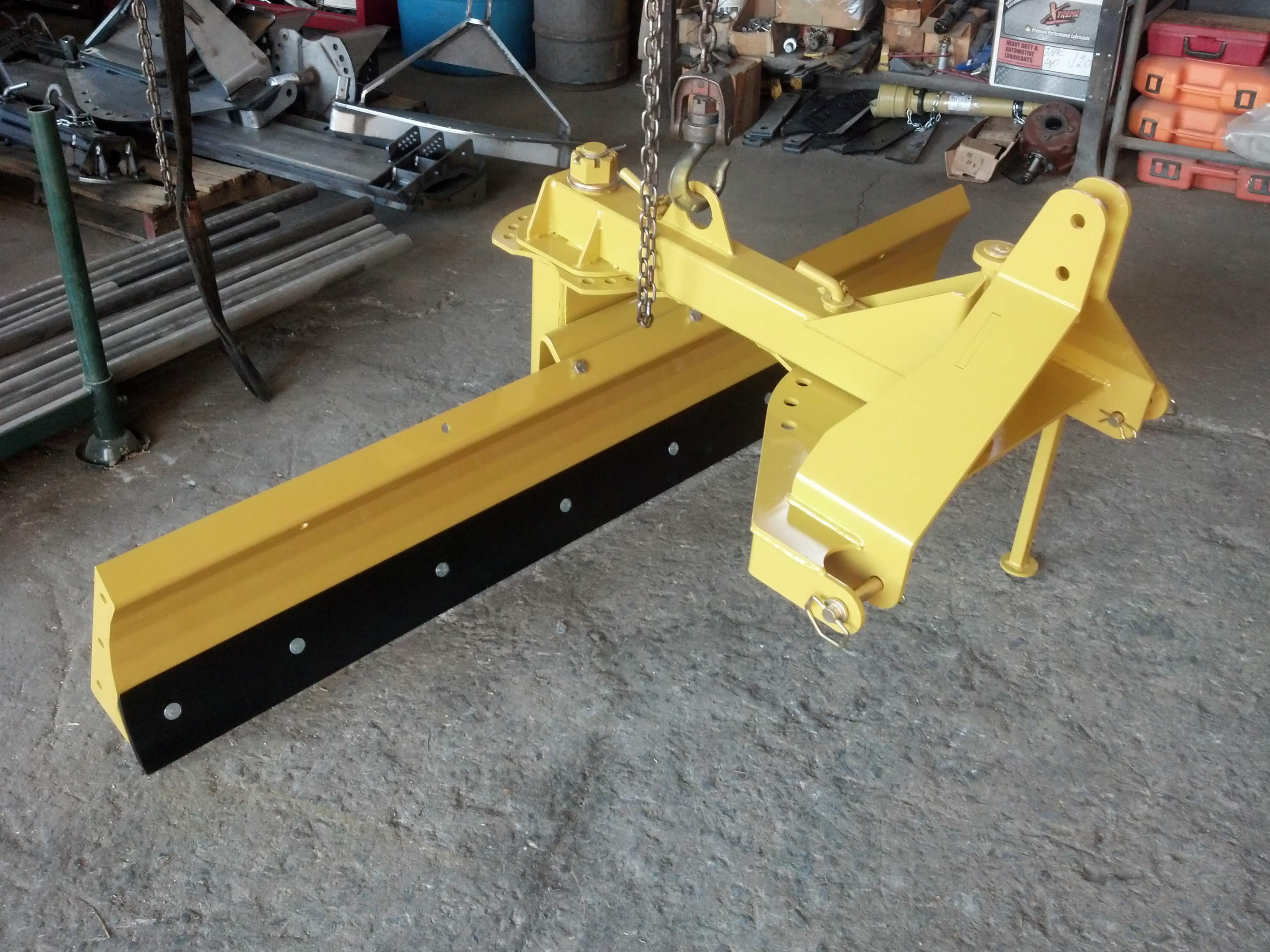

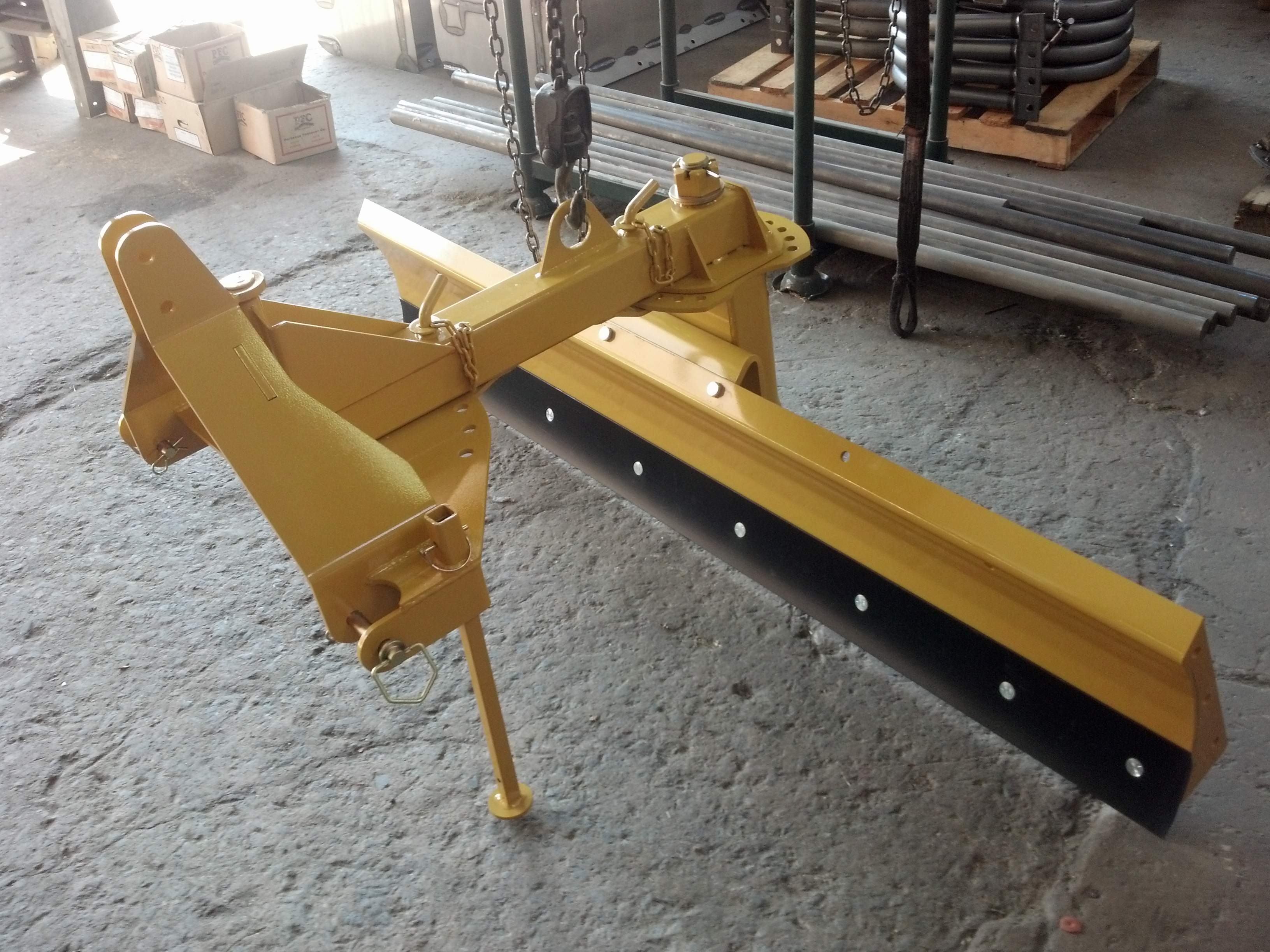

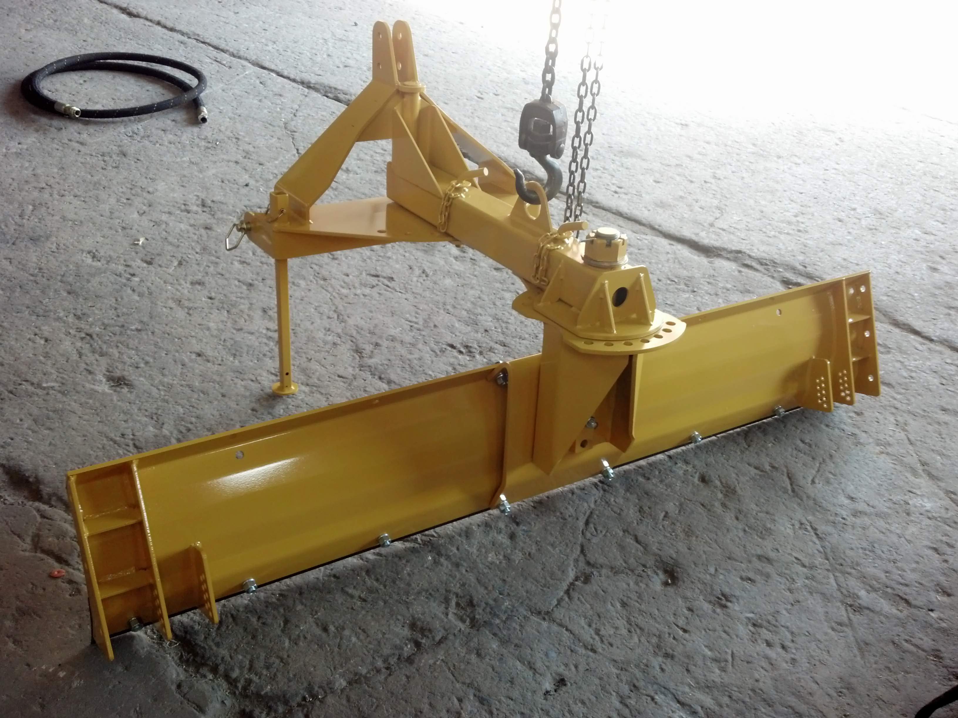

I was just down in our shop and noticed our new EverythingAttachments Xtreme Duty scrape blade is painted and ready for the photo booth and the video shoot.
Look for it, complete with prices, on our website soon. See the "sneak peek" below!!
Made from 3/8" American steel right here in Newton, NC and weighing in at 465 pounds(for 7' Blade). We have made the ultimate scrape blade complete with tilt, angle and offset features to ensure it can do any job you need it to. Also available with side walls and rounded skid shoes to make it even more versatile. This scrape blade should be available for sale within a couple weeks.

I'm not seeing how it tilts.?
I think its in that backing plate. I dont think you can see the holes where it locks in though. But I could be wrong.
Does look like a decient blade though. 3/8" steel....:thumbsup:
I wonder if they got any HP ratings for it.
465# is pretty hefty. But I still like a MUCH heavier blade simply for ballast purposes.

This blade will be rated for 30-80hp. 30 is pretty low but will be fine on older 30hp tractors and large framed newer CUTs. I will be making a lighter blade for smaller tractors hopefully in the near future.
At this time, I do not have plans for cylinder brackets but that is an idea that we will consider for the future.
The blade has 5 tilt settings on the rear backing plate like LD1 said. It also has 7 forward and 7 reverse settings AND 7 offset settings.
It is also quick hitch and I-match compatible.

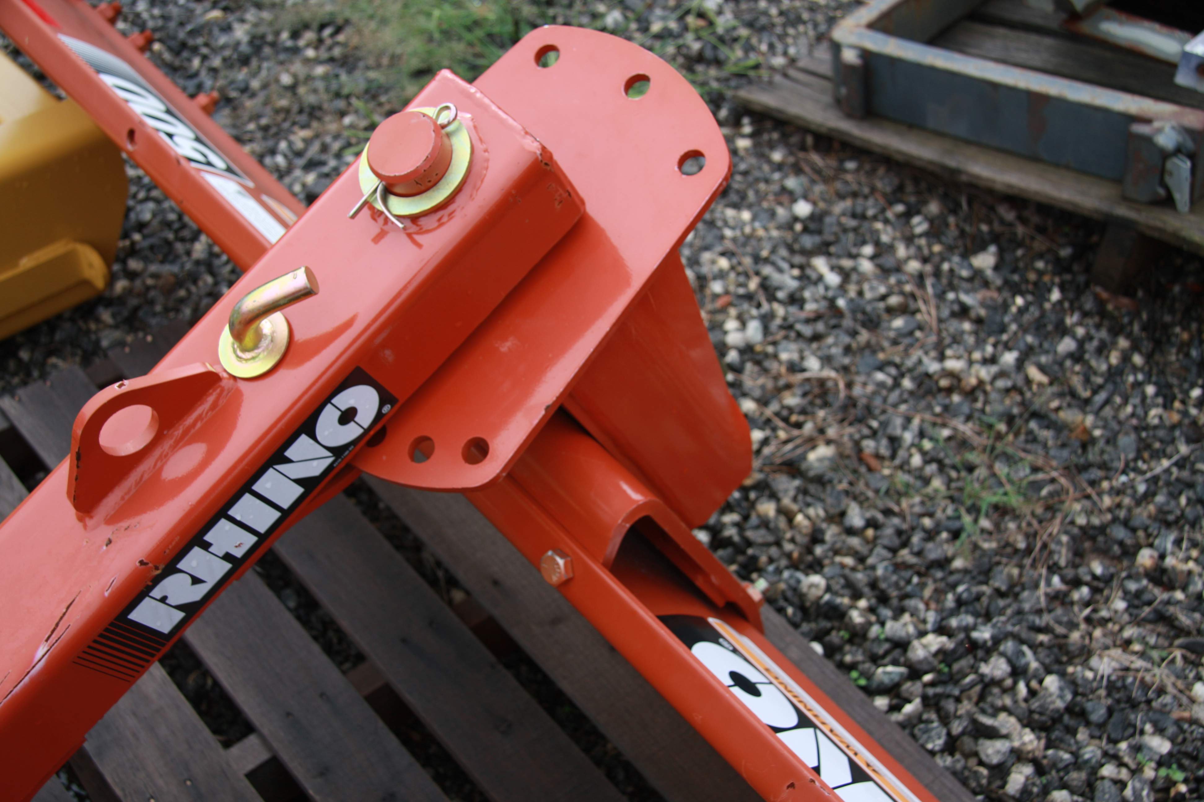

That is one really nice and heavy-built blade, EXCEPT, I believe you will find significant force and wear aroung the 4 bolts attacking the frame/carrier to the blade. Both my Freeman and my old International Commercial HD blades are constructed almost identical (even down to the way the International swings/offsets) and I cannot keep those bolts tight. In addition, both blades have developed a slight bend to either side of the attaching points. As a result, on the Freeman blade I rebuilt the top attachment to include about 2 feet of angle, welded to the carrier and bolted to the blade and rebuilt the bottom with about 4 feet of angle, again welded to the carrier and bolted to the blade. Have to do the International soon! You have included so many heavy-duty aspects to this new design, unfortuneately, I think time will show the blade connection as the weak link.
/ EverythingAttachments NEW Rear Scrape Blade
#20
At Everything Attachments we used the basic design with a lot of improvements in strength and options from a blade we have been selling for over 40 years. The pictures shown are the Rhino 500 series, with a dealer cost of over $1,400, without it being quick attach ready, which they offer a kit for an additional $350. If you notice we have added an extra plate with braces around the kingpin, where the rear blade adjusts and the 4 bolts you are speaking of, if kept tight, should not be a wearing issue. The reason it is bolted is because there are holes to the left and right for extra offset if needed. We are rating this blade from 30 to 85 horsepower. The only thing i can think of having a wear issue there would be if the bolts are a low grade and stretch which would let them become loose and wear but I have never seen one wear there
