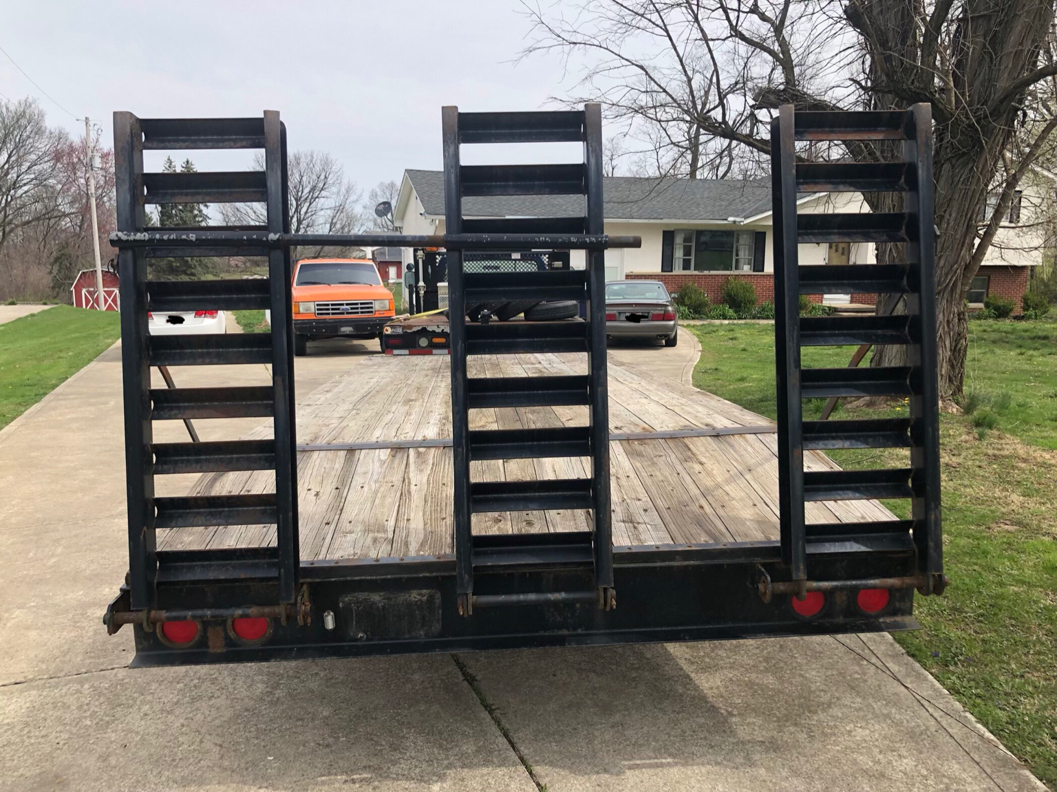

Place trailer tongue jacks on both ends of the back end ot the trailer. Once set on the ground, this will prevent the lift you are seeing on the tow vehicle.
/ Everything Attachments #1,305
Or, just a pair of jackstands, set them 2" lower than the trailer so that they don't get stuck under it.

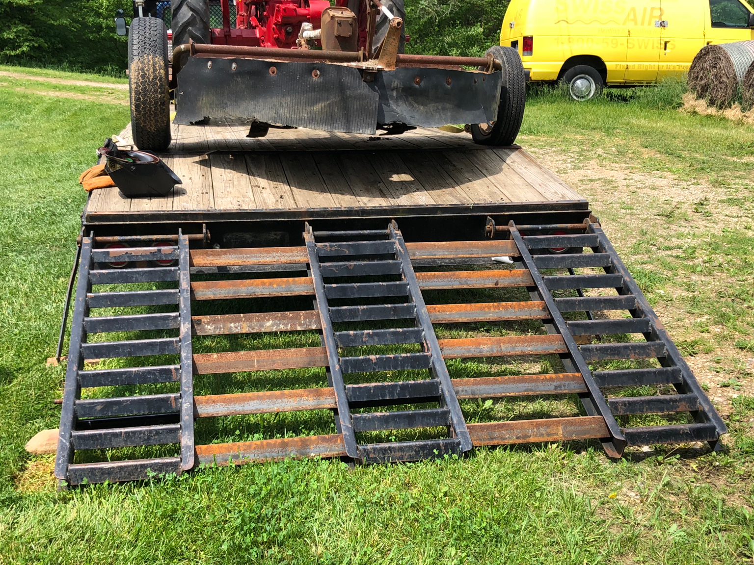

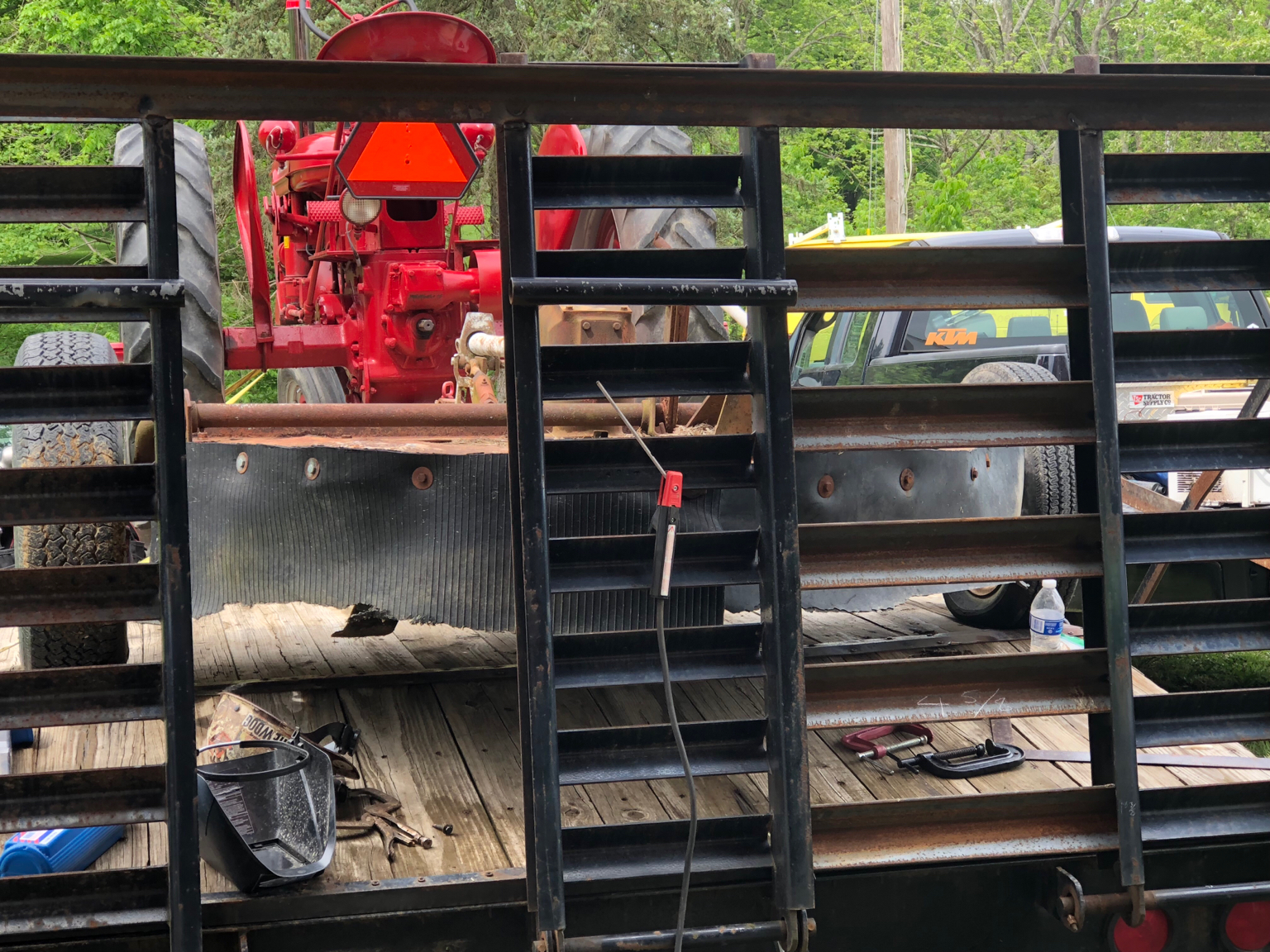

I learned today that the 208-230 that’s at the barn works lol. A buddy was off today and came over to help get the gate issue resolved. That’s about what she’s gonna look like, angle on hand was larger than the gates so its spaced wider.
Now the gate feet and springs.

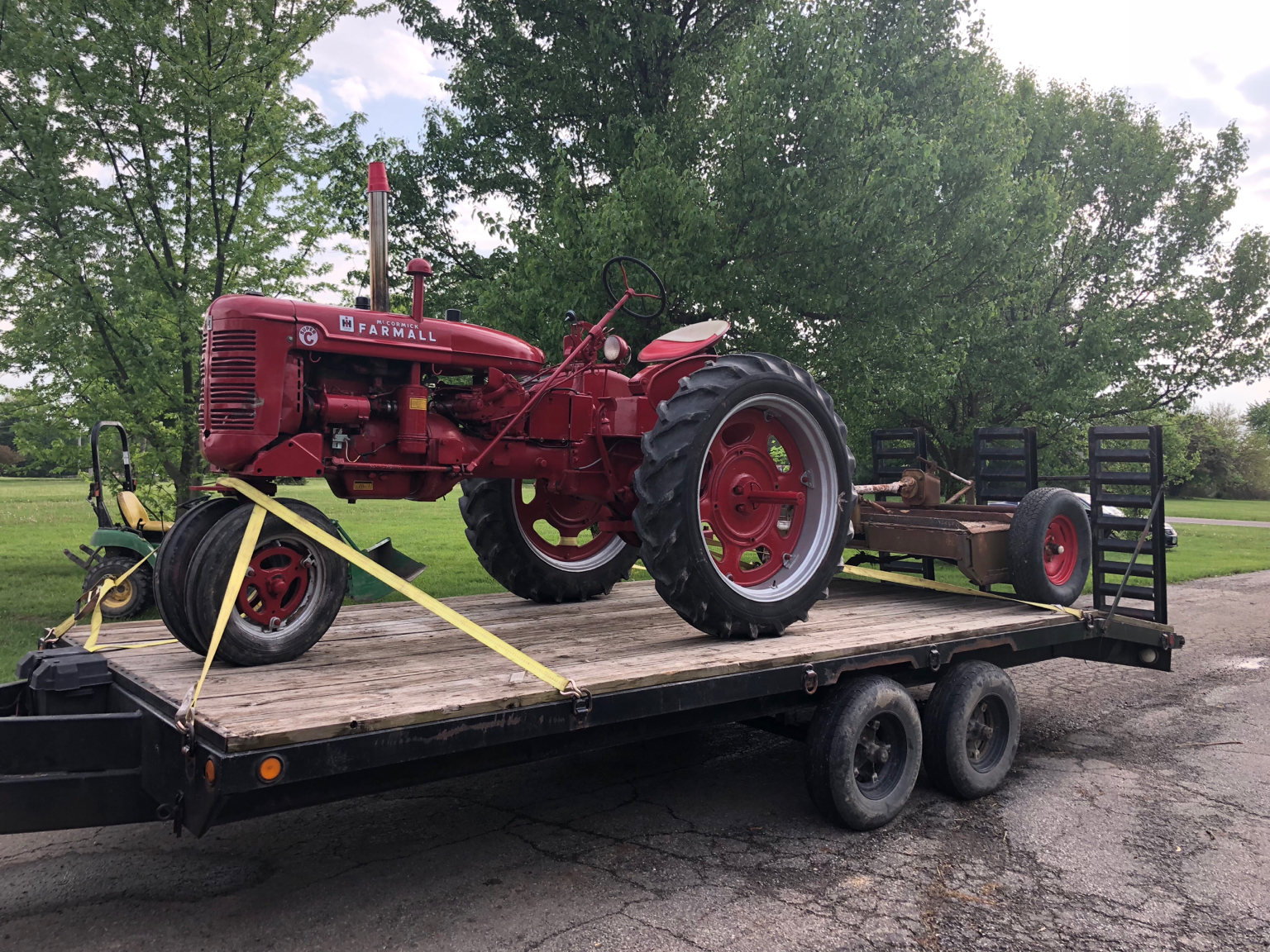

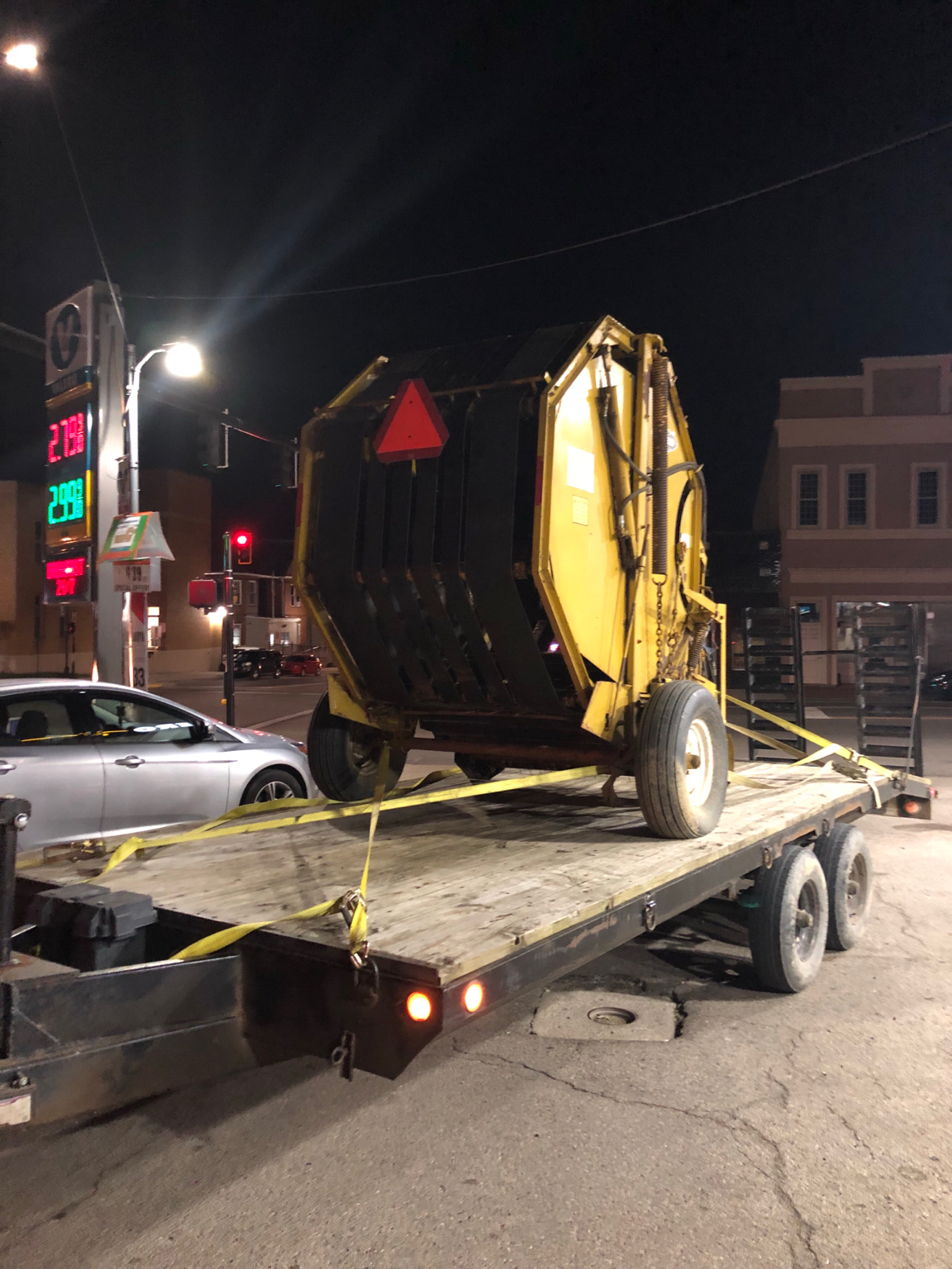

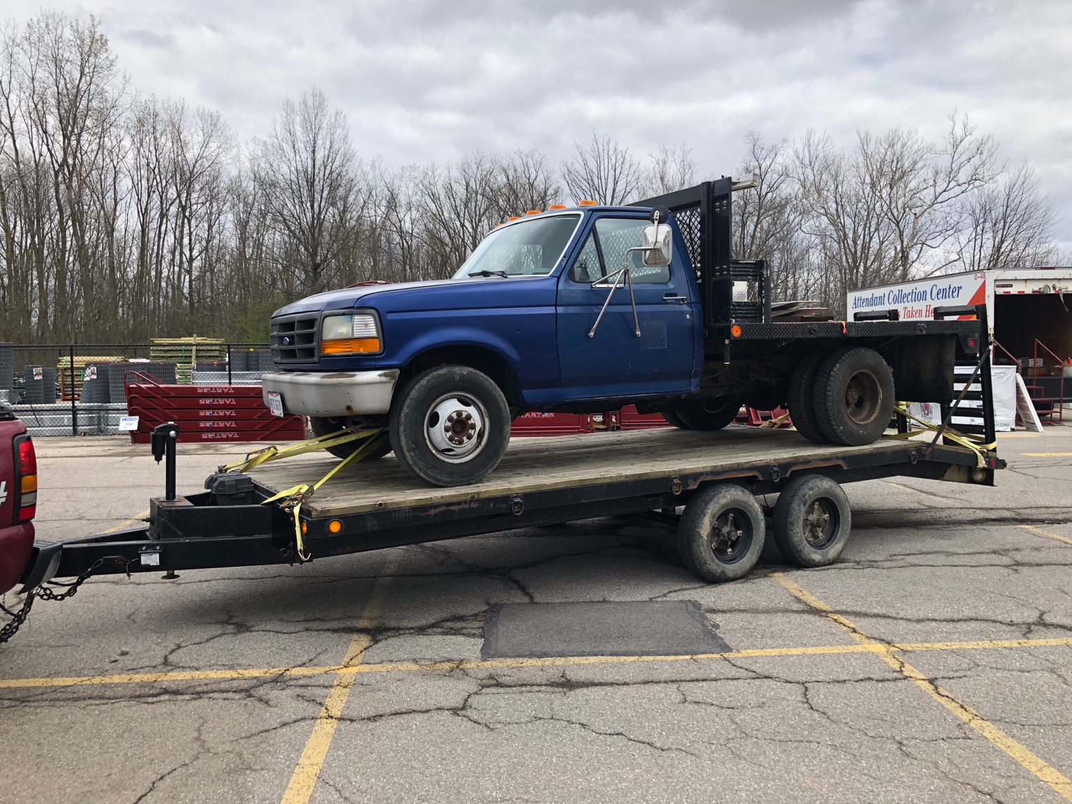

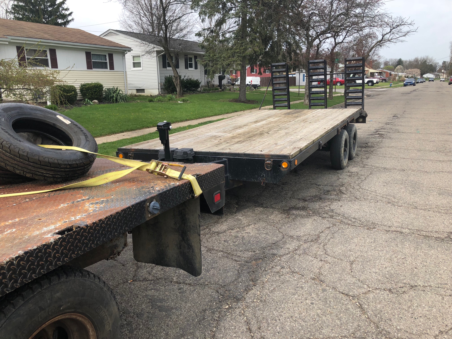

I have a similar issue with my trailer, I actually have a few issues with the trailer. Mine is a 20ft deck over with 3ft dove tail, my gates aren’t that long and the climb up is steep. I have yet to haul my tractor with it but fear I may run into this issue.
I also have an issue of the rear of the tow vehicle, being lifted while loading the trailer, my buddies 2500 HD has been pushed on multiple occasions while loading things.
This is a new to me trailer. So I plan to add springs to help lift, I plan to add angle iron in between the 3 gates on the rear to make one large gate. Then I plan to add the feet on the bottom so it doesn’t raise the truck. I may extend the gates as well but idk.
View attachment 554519View attachment 554520View attachment 554521View attachment 554522View attachment 554523
The deck over rocks once things are up their, way better than the last trailer, it just needs a little work to be more useful is all. It was built to haul tricycle tractors.

But just wanted you to see the ramps after they basically got done, still have to have the feet built so it doesn’t raise the truck up so much.
This was relevant to this thread because without new ramps my tractor tires didn’t hit the old ramps well, now I have one large gate my tractor and this are mobile.
/ Everything Attachments #1,314
I moved this party to the trailer section of the site.
Crank-down legs on a pipe stub swivel work great front and rear. Swing up out of the way when not needed.

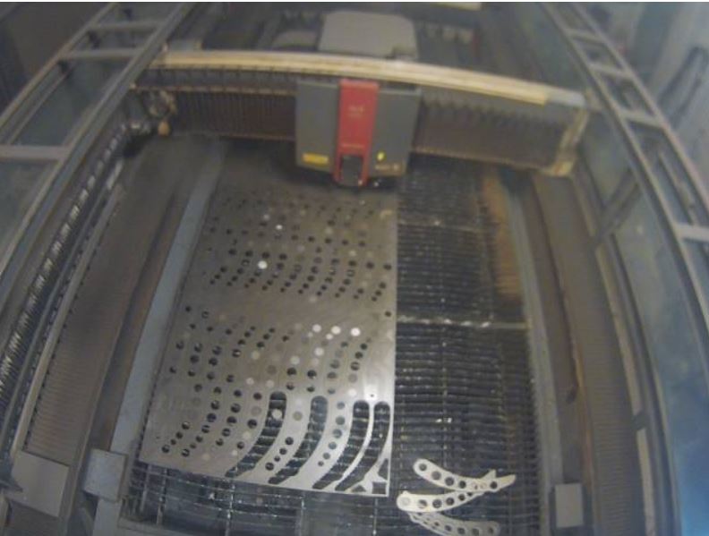

Well the cutter is doing a batch of Grapple teeth as we speak.... yea... I'm watching... :eek:
