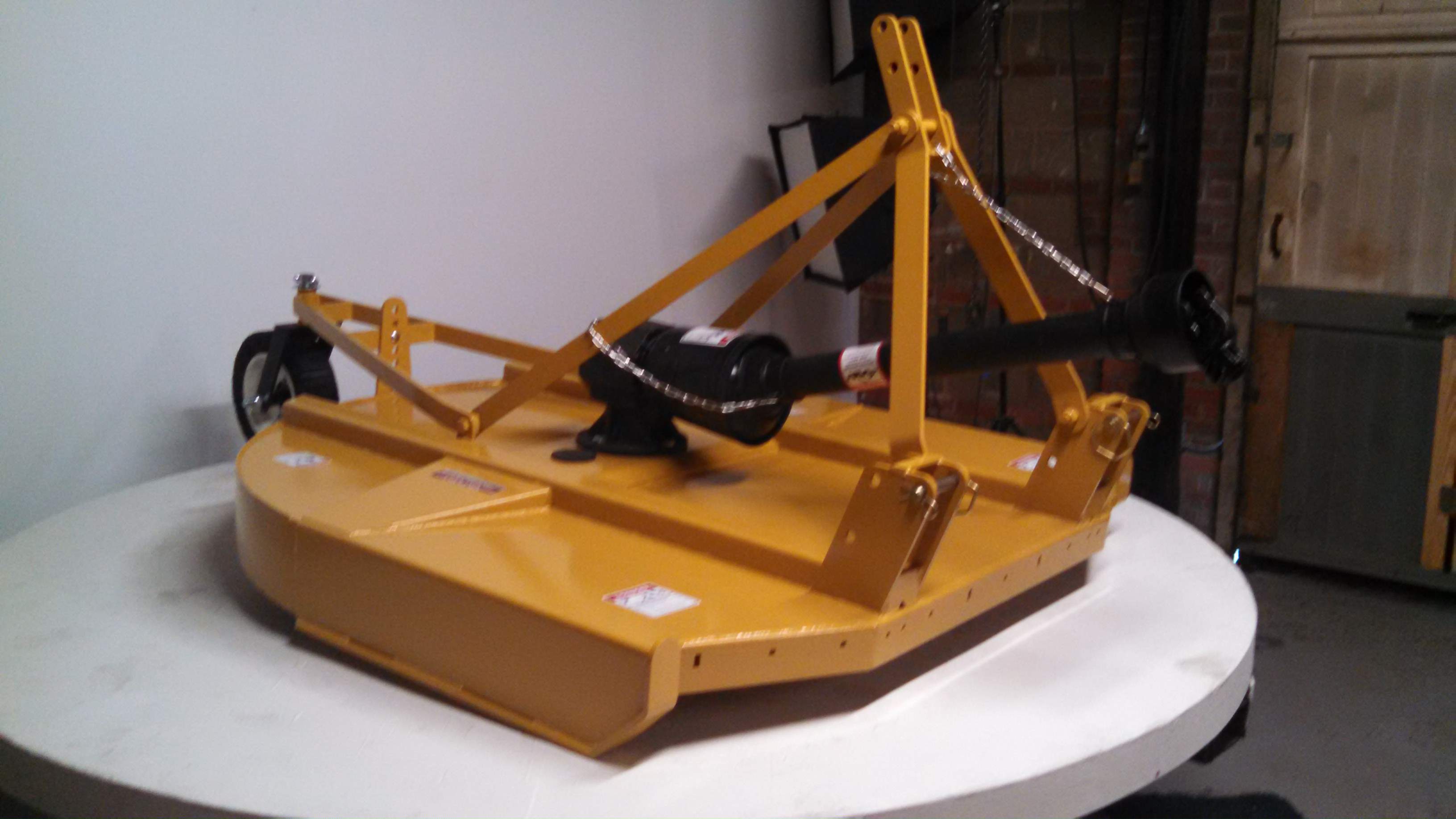

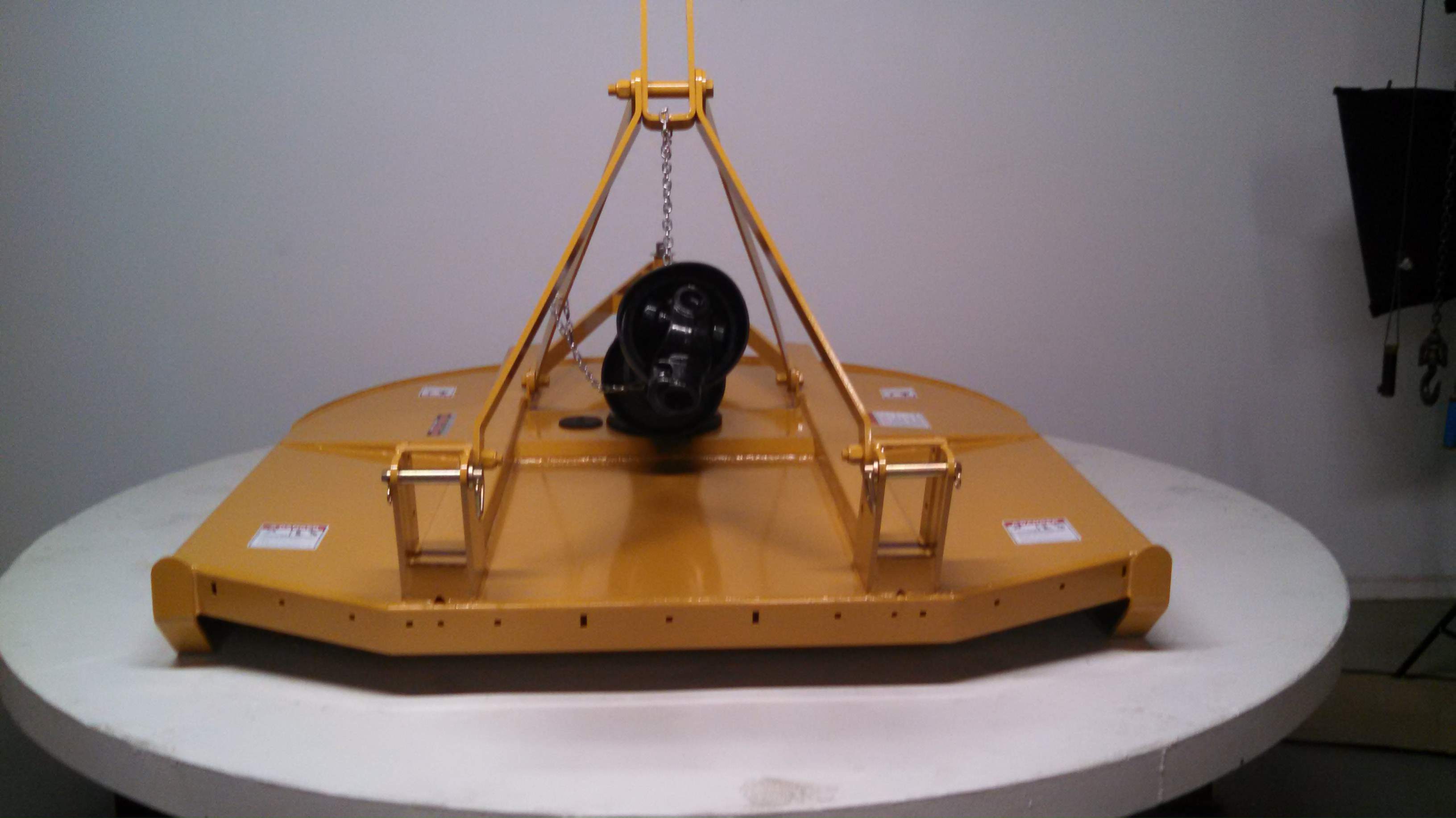

Here are some pics:
   / Everything Attachments Rotary Cutter....FIRST LOOK!!!
#28
Here are some more pics of the fully assembled 60" ETA Rotary Cutter.
I'll post more info. as it becomes available.
Travis

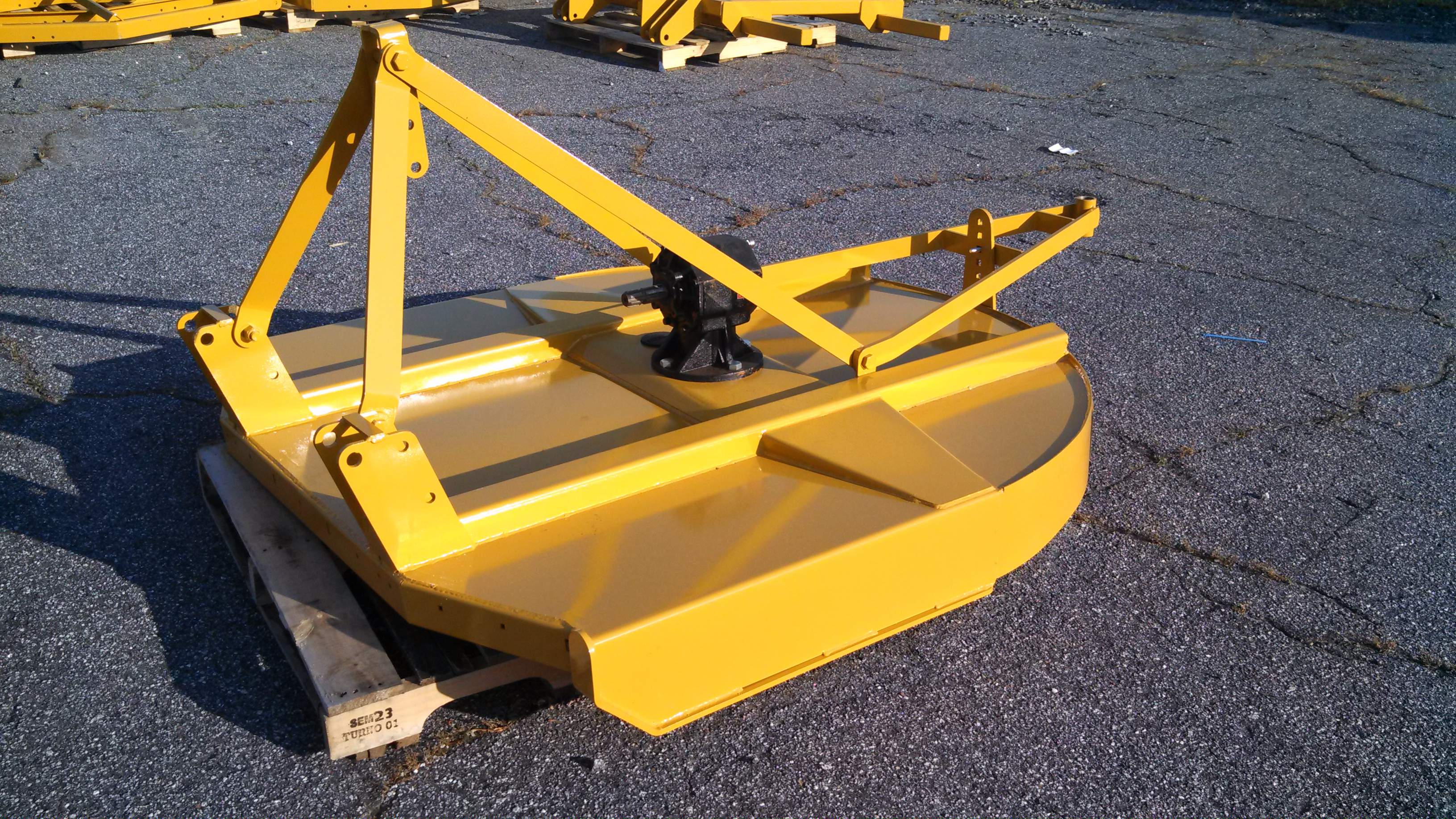

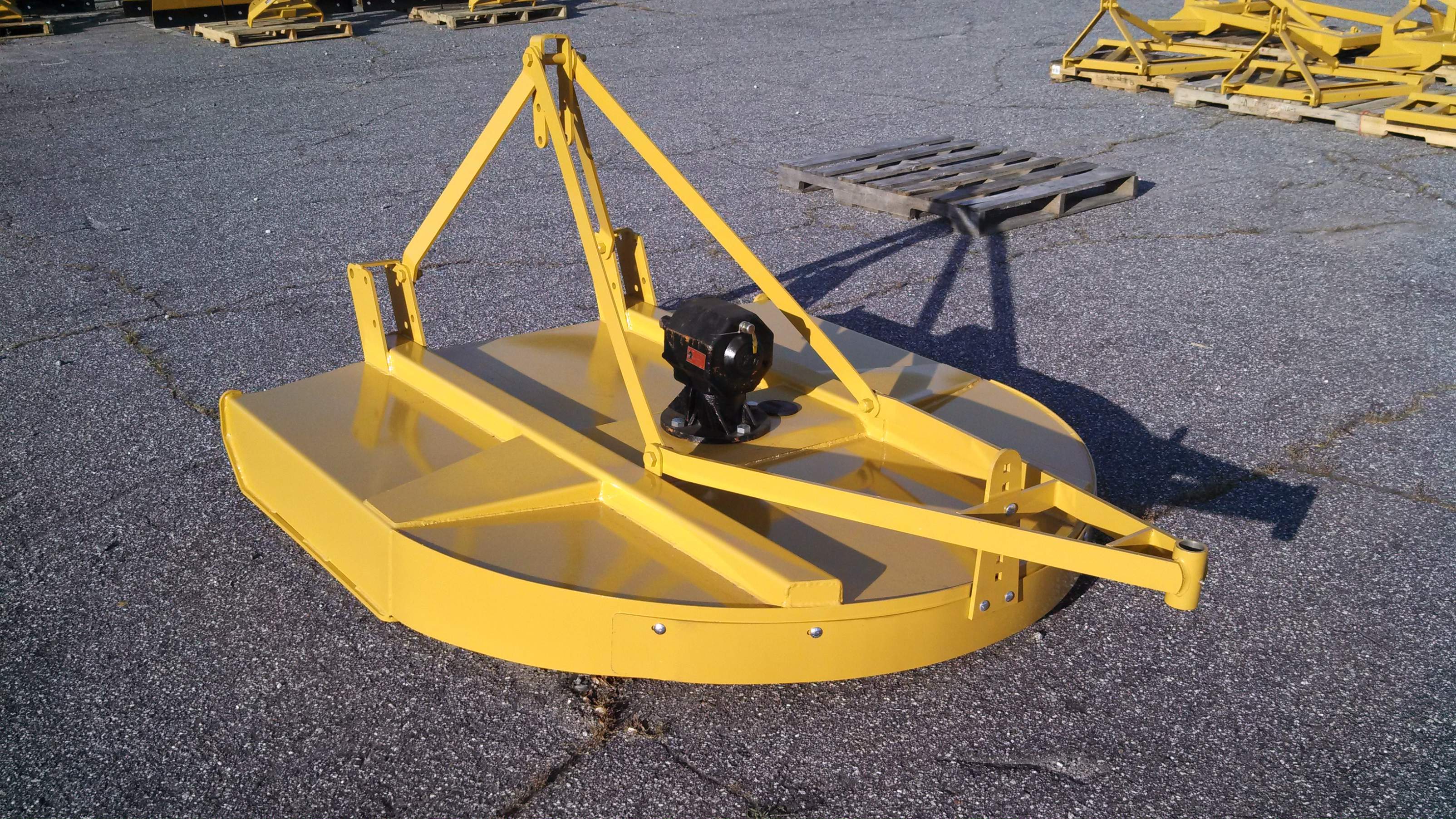

Looks really good, Ted! I have one comment... is there a lip at the top of the deck all the way around the back (curved) part of it? If so, will that hold water when it rains?? I say that because a rusted deck is one thing you see on a lot of old mowers that have sat outside for many years. Is there a weep hole somewhere for the water to drain out? Or maybe a gap in that lip for it run out?
Also, you gonna put the little plastic containers on them for the instruction manual? Some folks like to keep extra shear bolts and spare lynch pins them.
Overall, a great looking, well made piece of equipment that will probably outlast a lot of us forum memers LOL.
