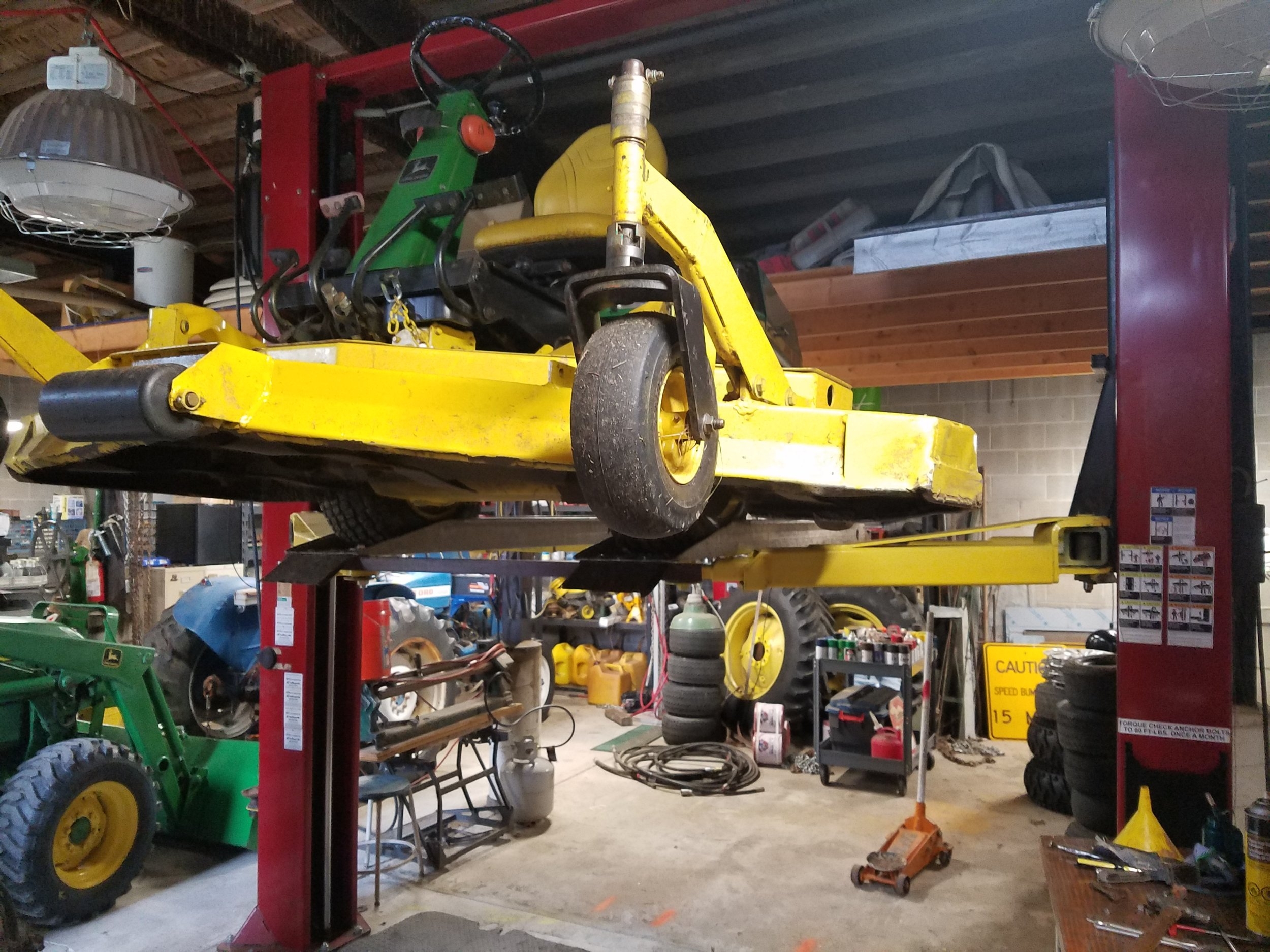

I use mine for lawnmower storage & maintenance.
