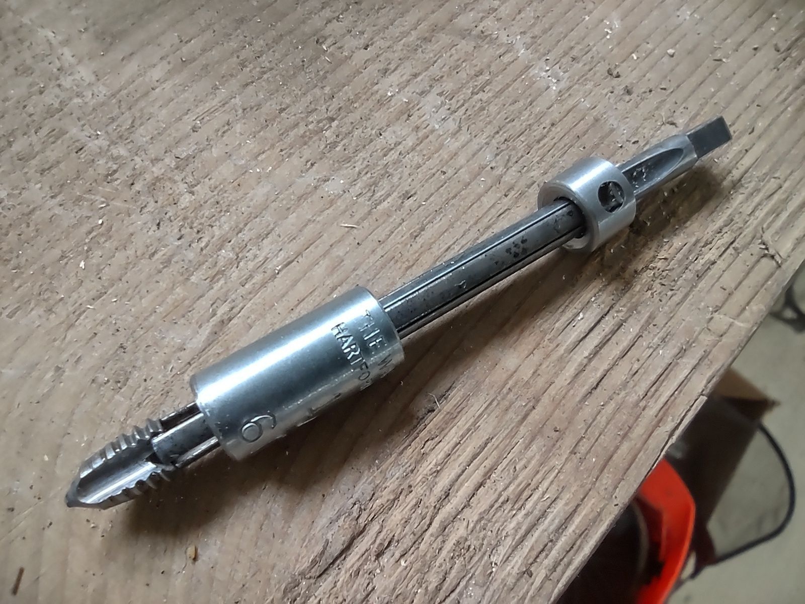

Success! Walton Tool. USA made and it worked perfect. I had real easy access, so that helped.

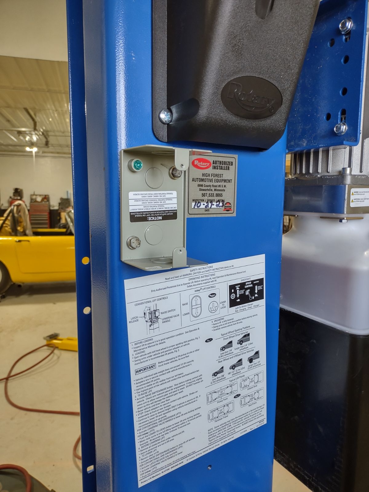

👍 However I'm slightly envious of your two post lift lol. What brand and capacity is it?
Thanks. It's a Rotary, 10k.
Just saw this thread,,, Walton Tool... Great Company!!! They are in my area & a few yrs back I broke a tap off; tried to purchase one of their extractors from a local dealer but they didn't have what I needed & recommended that I check with Walton directly, as they were local (which I didn't know). They were awesome to deal with & allowed me to purchase direct being the local dealer did not have what I needed... Again a great American Company...
Glad it worked for you!!!
