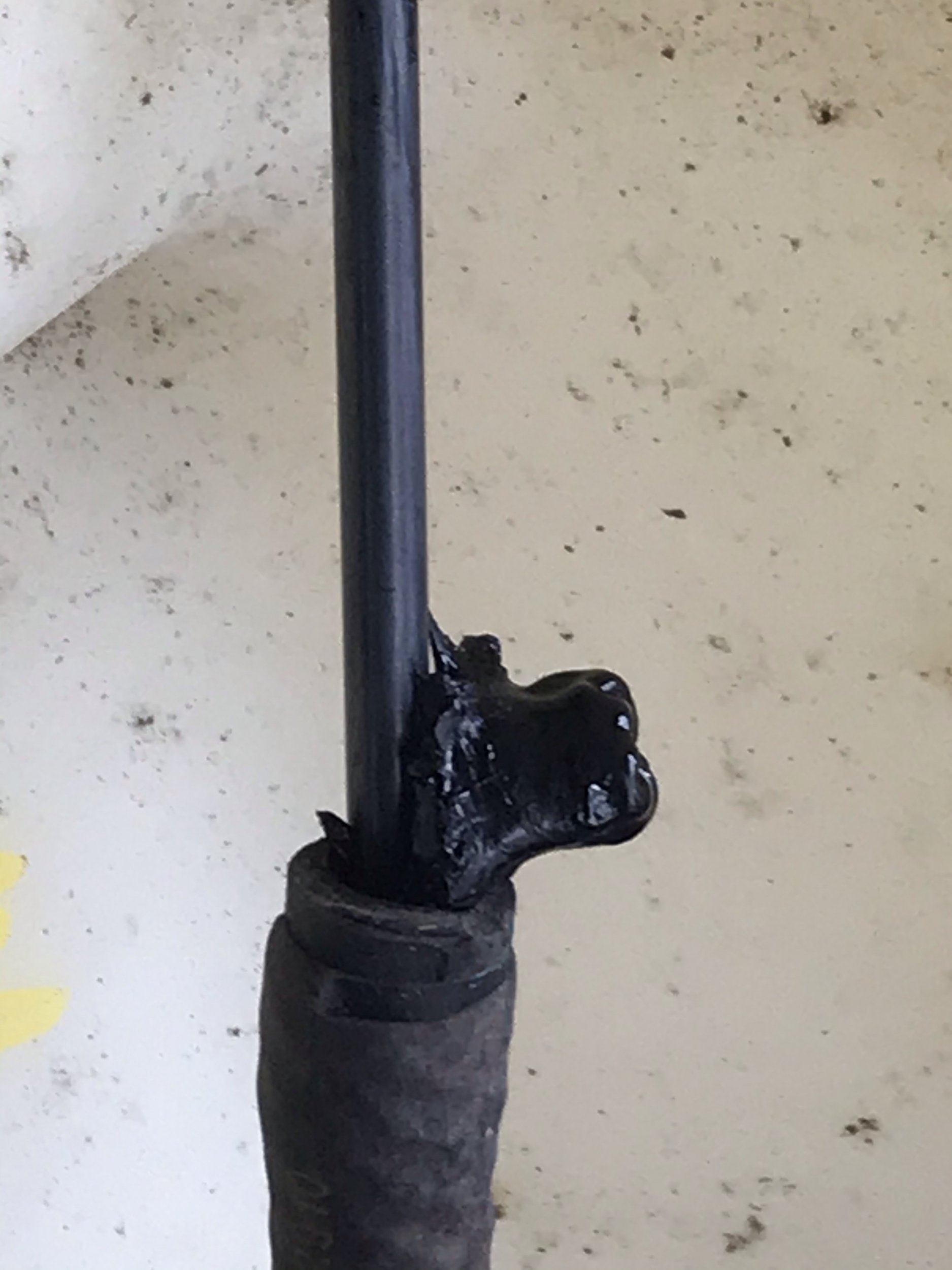

I bought a walk behind mower yesterday and started messing with it today.
It ran last season and was left with ordinary pump gas with 10% ethanol.
Not only the bad gas, and cleaning the carb bowl, main jet, float, etc.
Look at this nice surprise from the plugged up fuel line.View attachment 695196
That’s a longer drill bit it used to go through it ramrod style. This came out the opposite end on the first pass.

It appears to be the original fuel line. I had heard of this happening with ethanol gas is why I think this is what caused it.
