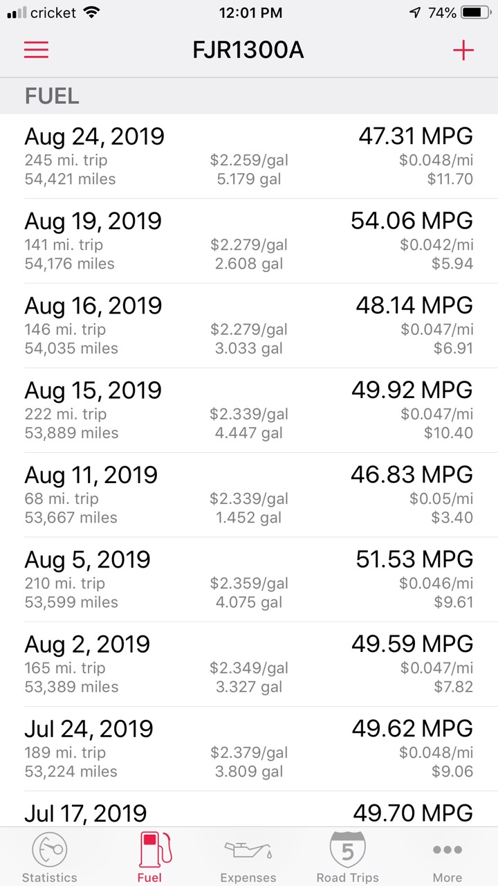

When comparing MPG you need about 5 tanks to get the old out and get a good average. And that means you need a logbook of what your car was doing before you changed fuel source so as to know what it was doing.
The MPG display on the dash is commonly called a Fool Computer because it lies and will make a fool of you. Is nice for a quick approximation but there is nothing like a logbook with miles divided by gallons. I can't explain these variations. Rode different roads but similar speeds and 90% of the time I buy gasoline from exactly the same pump and hose, 99% from the same station.
I don't have a MPG display. I always hand calculate. I've checked my mileage every tank since new and have a pretty good handle on the mileage. The biggest variation that I can't control is how full I get the tank. Plus or minus 1/2 gallon can really throw off the calculation. I've actually thought about using a dipstick in the filler neck to get more precise but thought better of it.
