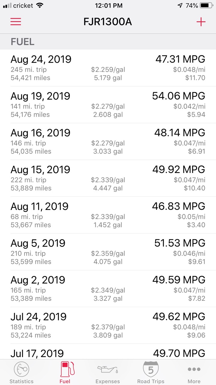

When comparing MPG you need about 5 tanks to get the old out and get a good average. And that means you need a logbook of what your car was doing before you changed fuel source so as to know what it was doing.
The MPG display on the dash is commonly called a Fool Computer because it lies and will make a fool of you. Is nice for a quick approximation but there is nothing like a logbook with miles divided by gallons. I can't explain these variations. Rode different roads but similar speeds and 90% of the time I buy gasoline from exactly the same pump and hose, 99% from the same station.
