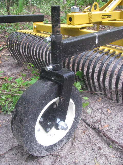

If I can ask, why do you only have one gauge wheel, instead of a pair?

I managed to bend support arm on other gauge wheel assembly on first outing. It was a the welding shop having the bent pad replaced. Heavy duty does not necessarily compensate for careless.

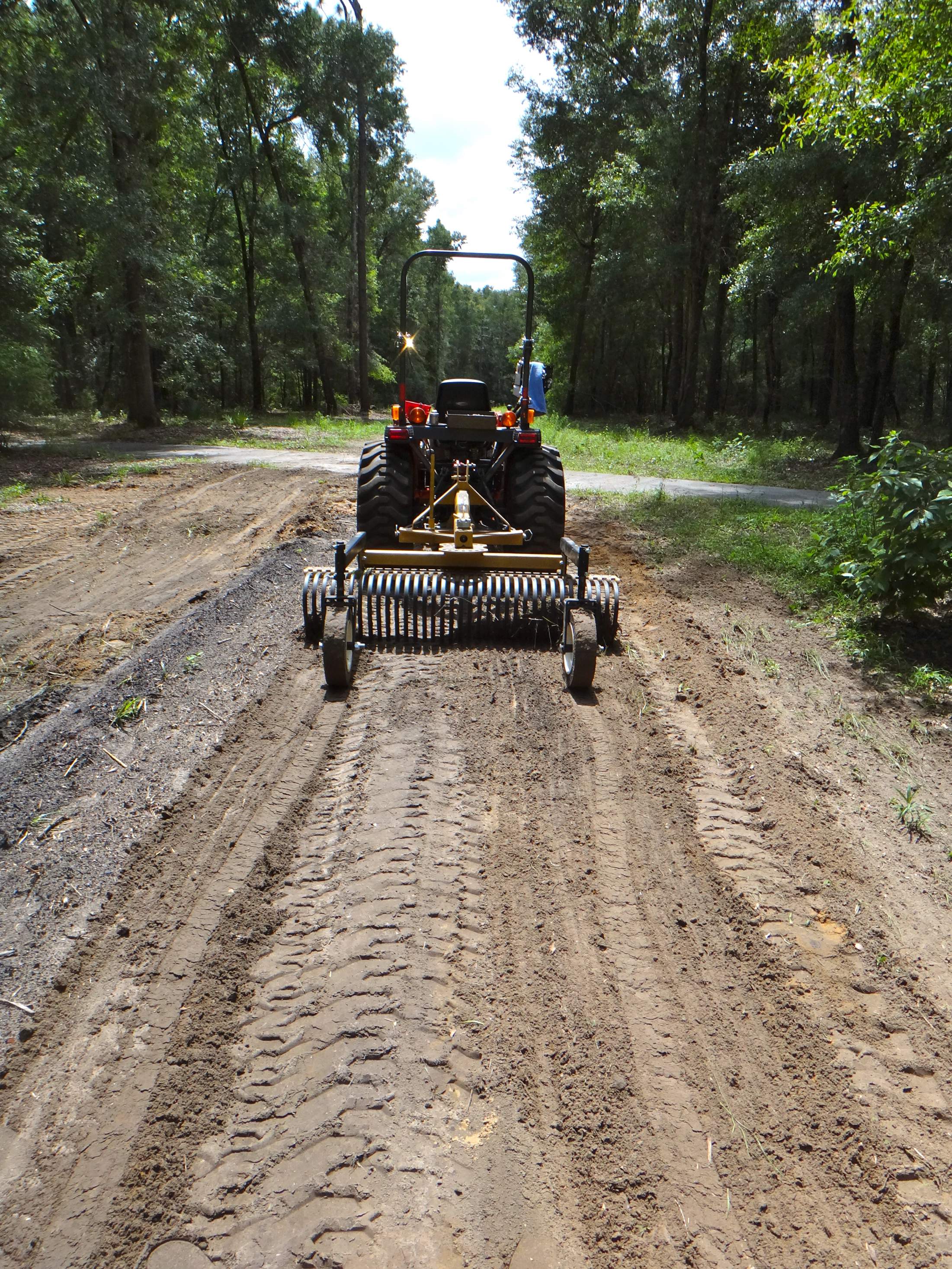

I am ascending the ETA Landscape Rake learning curve.
At times it has been a challenge to get the gauge wheels to castor and rotate on axles. On occasion one or the other wants to drag sideways, stationary, leaving a furrow. To encourage castor the Top Link is lengthened to put more pressure on the wheels, or the lock collars on the gauge wheels raised, which also adds pressure to the gauge wheels; or both. Lengthening the Top Link makes the rake skive more aggressively.
Adjusting the trailing edge gauge wheel of the angled rake to hold the trailing end of the rake 1" to 1-1/2" higher, allowing the rake to filter, is also tricky, as trailing gauge wheel adjustment interacts with 3-Pt. hitch lifting-rod adjustment, which is also used to tilt rake.
Generally speaking you use more angle and tilt for moving dirt across the face of the rake. When using a lot of angle the leading gauge wheel assembly sticks out awkwardly and vulnerably beyond the rake. (See Post #22.)

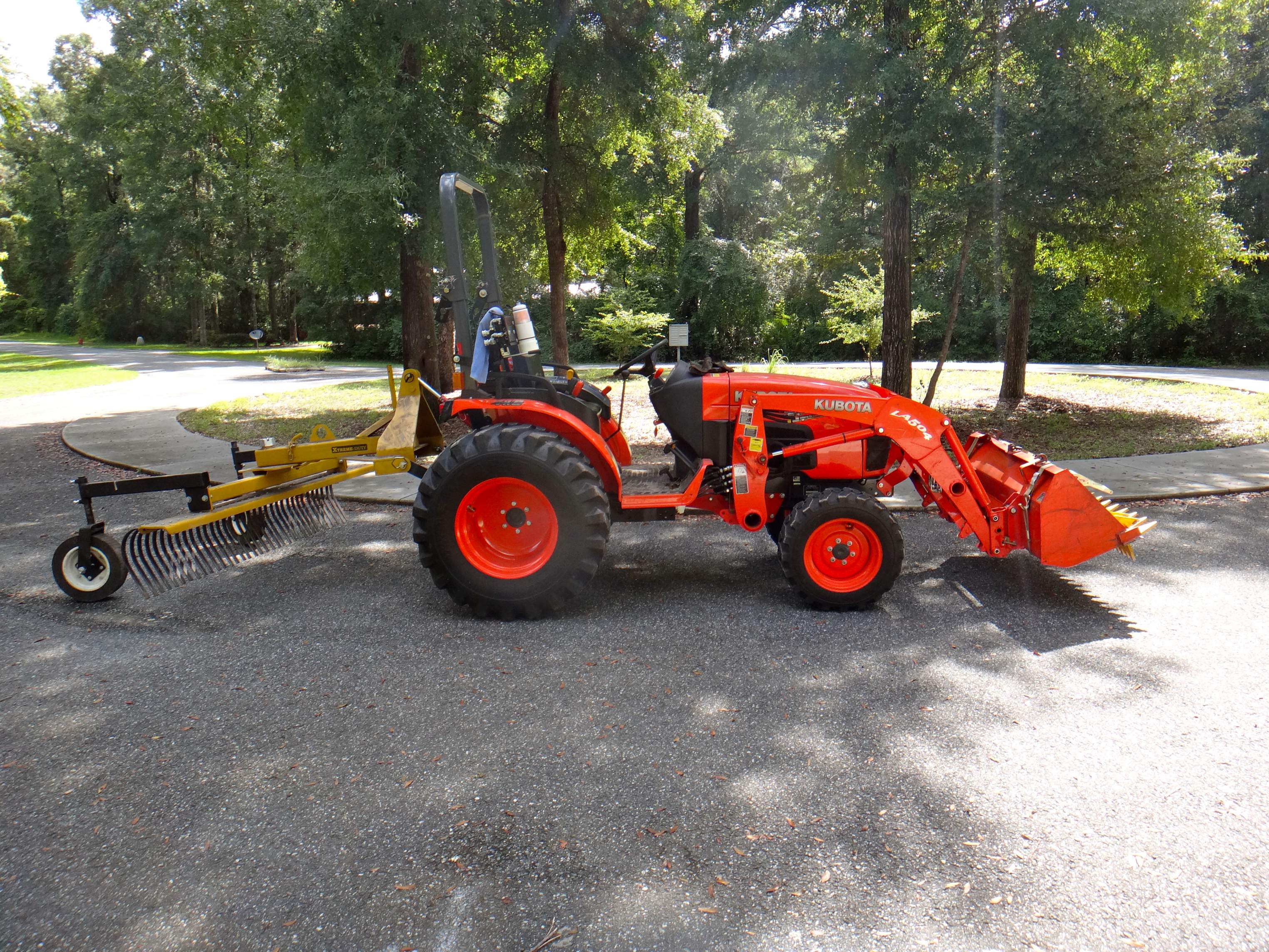

Use the rake un-angled, perpendicular to the tractor, with lifting rod "neutral" and gauge wheels equal height for finish grading. Photo #3
Kubota's often maligned 1/4"-ing, correctly adjusted, is quite helpful pulling a Landscape Rake.
Ratchet Rake on the FEL bucket is handy for grading around poles and trees.

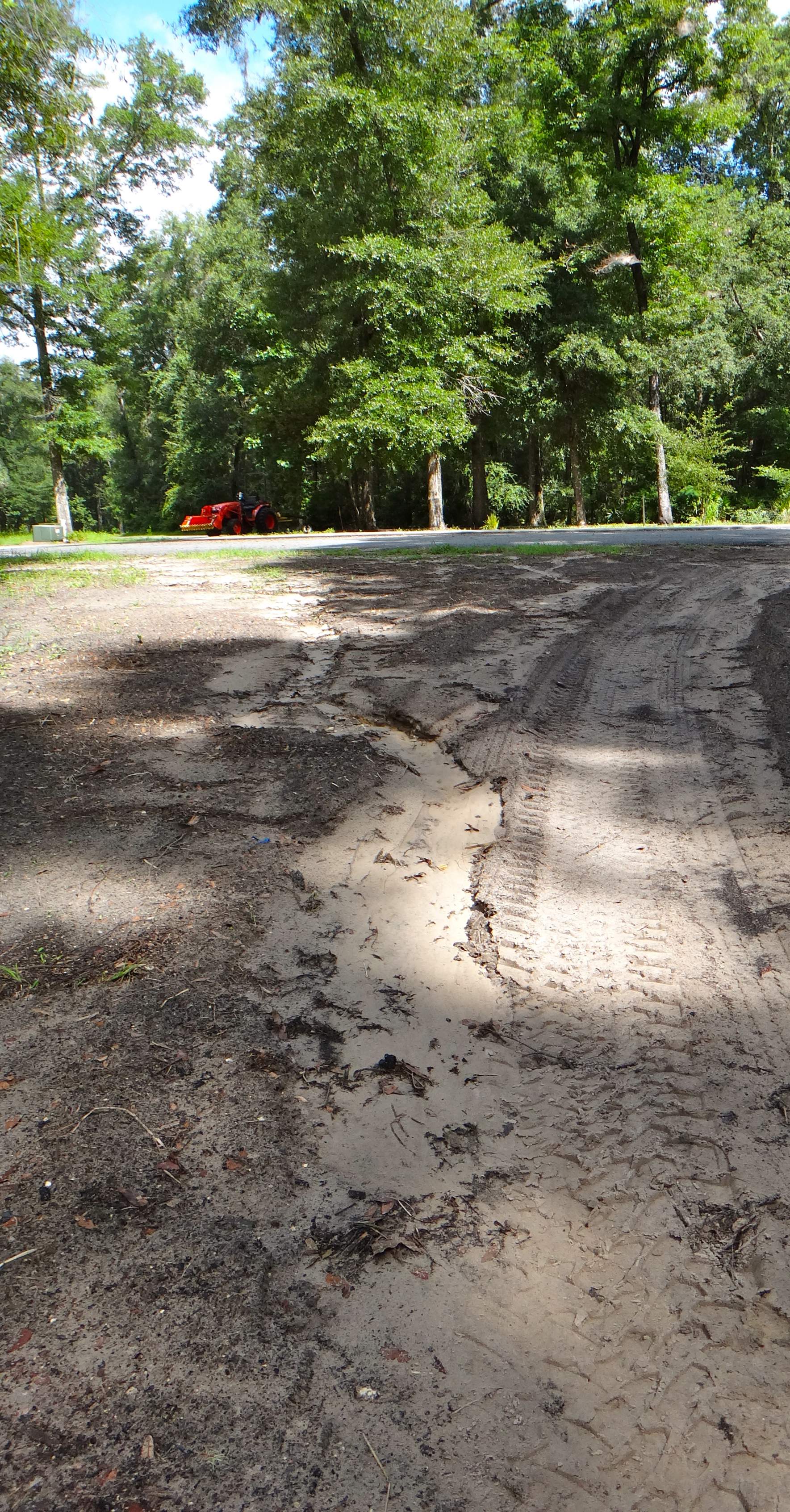

Road bed was liberally sown with Argentine Bahia pasture grass three days before the storm. Some seed is now covered too deep to germinate.
Photo #1 Nascent erosion from recent thunderstorms.
Photo #2 ETA Landscape Rake mounted on 3-Pt hitch; Ratchet Rake bound to FEL bucket.
Photo #3 Final pass with Landscape Rake. For perfection a little hand raking would be necessary.
I created a slight crown in road center to prevent runoff from crossing the road.
