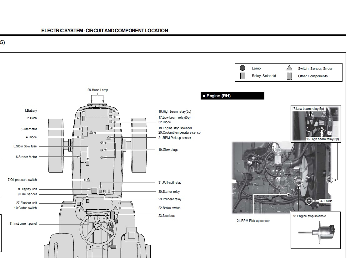

After a couple days where the Kioti manual website wasn't accessible, I was finally able to download the workshop manual.
Looks like the pick up sensor they mention on the manuals is on the right side of the engine, towards the front. Also looks somewhat exposed to brush and sticks that could mess up the wiring, unless the hood covers it.

Yep... There it is! They don't make it easy to get to. It's just above the oil filter and behind the frame. Looks like a single bolt attaching it to the engine. Any thoughts on how to test this thing? Wires look okay and connector seems in good shape. I could just replace it but it's like $100 with shipping, which is fine if it fixes the problem. But I'd be mighty disappointed if I swapped it out and still had the issue.
