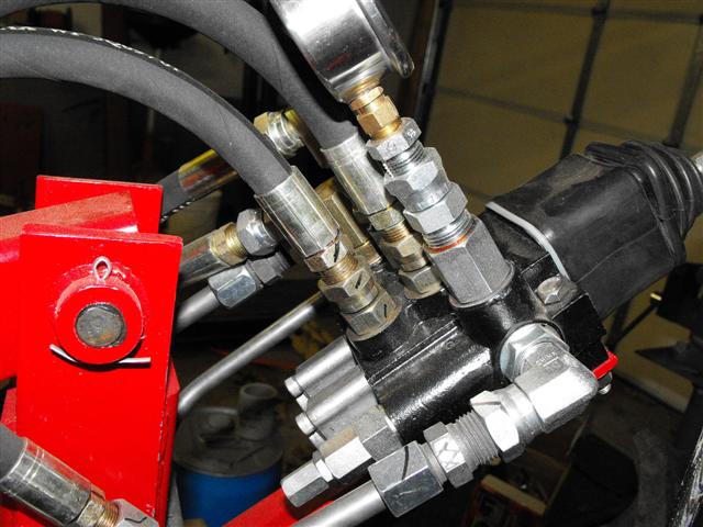

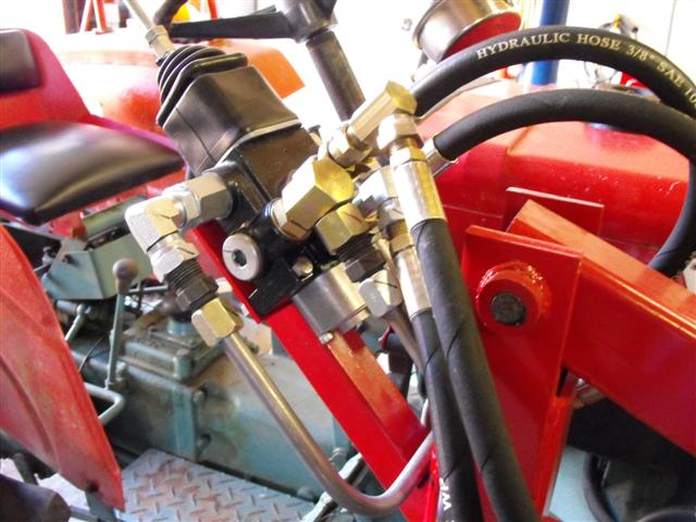

Look at that picture of the valve again, the PB sleeve and hose is connected to the straight through path through the valve. The return is using the top outlet . There is another return outlet on the side by the PB. Now, if the hoses are correct.
If the PB and return hoses were connected wrong, then the flow would pass through the PB port and out the return hose to tank, and the 3pt would not work.
If the 3pt works correctly and will kick in the relief valve, then we can assume it is working correctly.
Where is the relief valve on this valve. It is usually close to the pressure port.
/ Erratic Hydraulics #70
The relief valve is on the input side. When I use the 3pt all the way up I hear a relief kick in and the gauge pressure will remain around 850psi. I don't know if that is because the PRV in the 3pt is kicking in or what. The loader valve is set to 1500psi and will kick in the minute the cylinders fully extend.
This is where I'm not seeing that.....The PB (plug shown) is inline with the center power core but the PB hose connection to 3ph is not (it's showing the return to tank inline with the power core)......
/ Erratic Hydraulics #75
In this picture, I see the steel line attached to the PB sleeve, the return is the 90 degree fitting to the right. The side return port is not used. Both are using steel lines.

?? Which are you referring to as PB sleeve.?? the upper left looks like an adapter fitting to me....
That is correct. The PB port comes straight out of the valve side and I used the top return port hole and plugged the side return port hole. The side hole would not clear the PB 90degree fitting.
This valve has an internal connection between the PB port and the tank return port unless you install the PB adapter (which it has). Then the connection between the two ports is sealed off.
