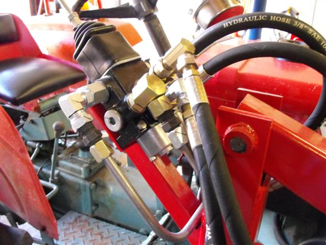

/ Erratic Hydraulics #54
Return line restriction would cause the pump to be under pressure when the control valves were in neutral. The pressure would increase as pump flow increased.
I would get a stopwatch and time the functions at idle, then at full throttle. I actually wear a chronograph for this very reason.
The loader valve has a PB port that goes back to the 3pt and the return line is separate from that line. The return line only flows oil when the loader valve is operated. Otherwise it has no oil flowing in it. I had to make an adapter to use my oil fill hole for the return line.

If the valve is using PB port for normal flow, then he would only have fluid in the return port when using the cyl.
A gear pump will pump continuously, and the fluid has to flow through something.
Picture of the valve and the hoses marked as to where they are connected would be useful.
/ Erratic Hydraulics #59
Here are the photos of the valve plumbing.
