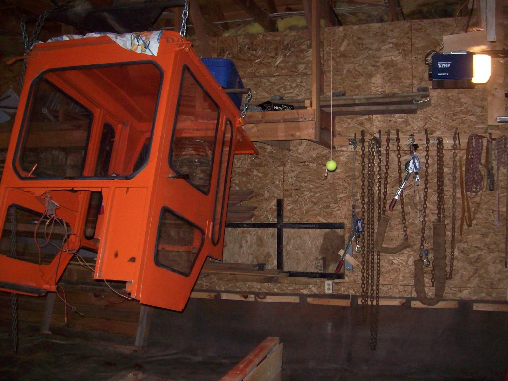

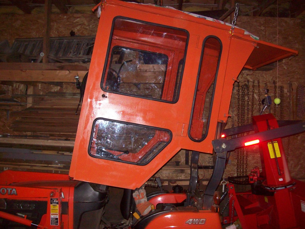

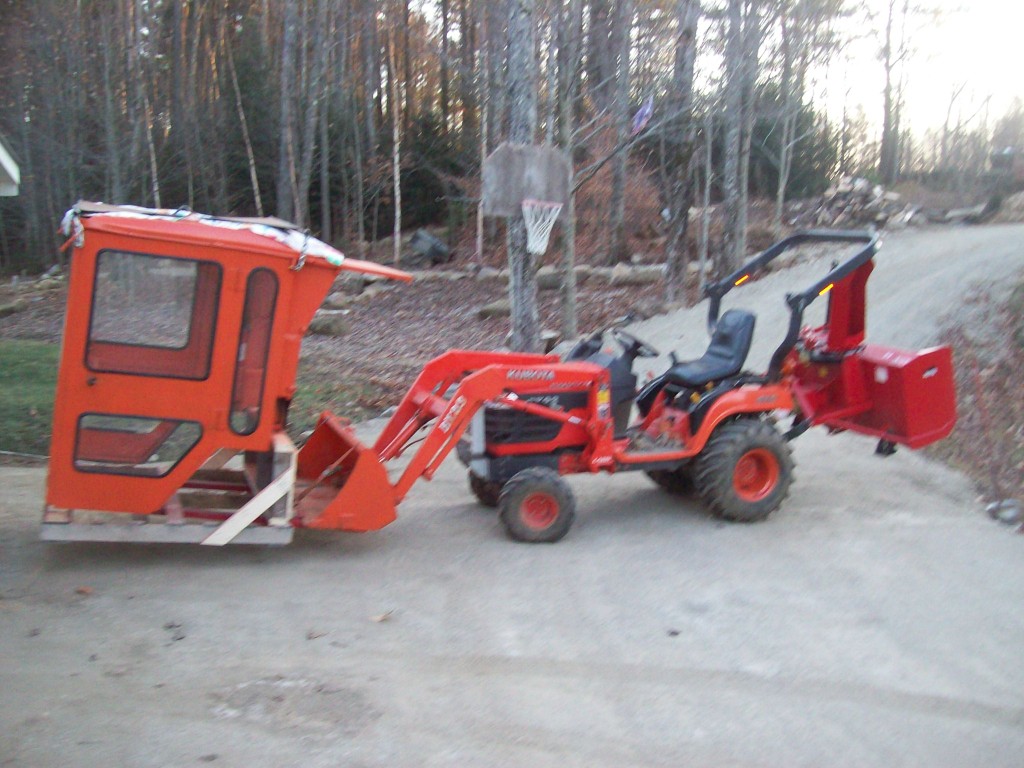

Thought id share.Imade this device to help install/remove my homemade cab.The cab has loops on the corners for lifting on and off.Icut two lengths of thick wall tubing,slightly wider than the cab[to avoid scratching the paint] welded 8 inchs of chain on each.I connected the two and reenforced with some thin flat plate.Welded a loop in the middle for the chain fall to hook to .WELL HOPE YOU CAN SEE IT WITH THESE PICS:D Iused rope to remove what a pain that was.This kept things lifting even

Idont know why the message posted twice ,please delete the other.Ignore the first pic wasnt suppose to be there ,im losing it tonite:DHeres a couple more with a pic of the equalizer

Looks great, I had a very similar setup for the removal of a Jeep hardtop once.
