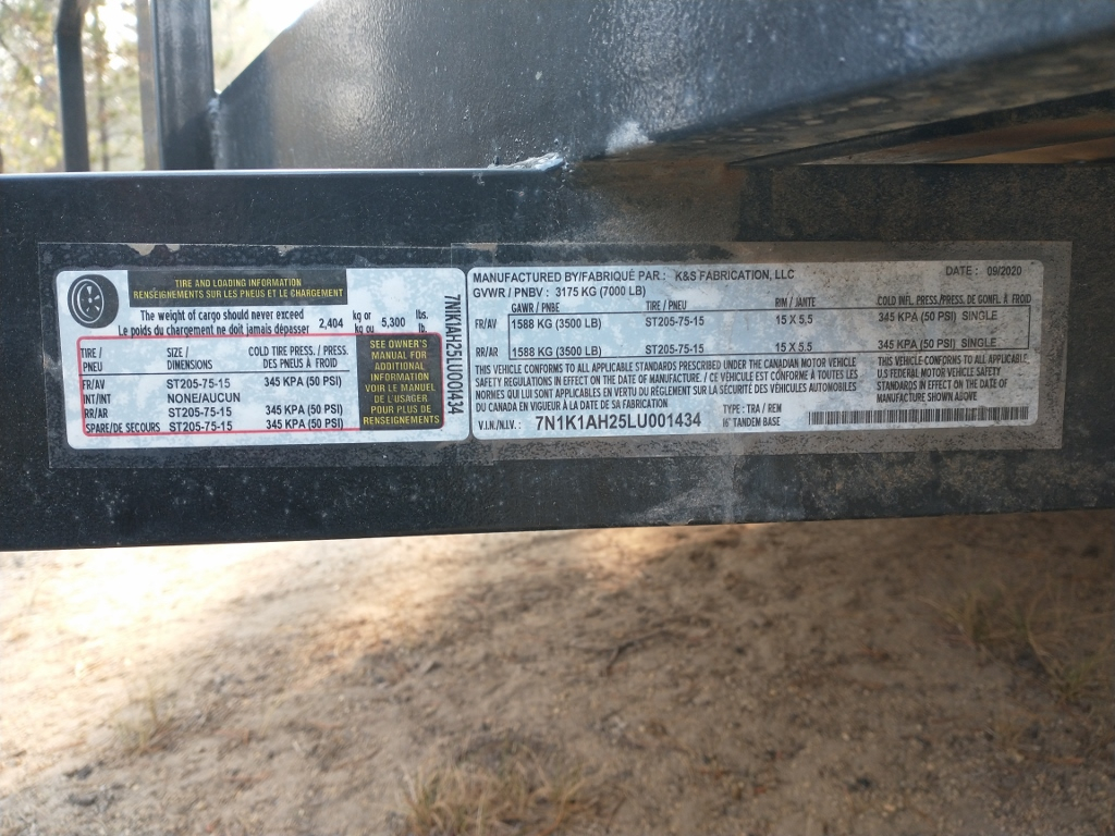

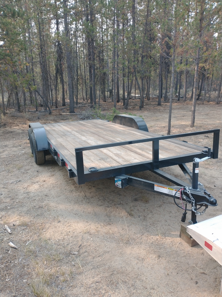

Thanks for all the replies.
I would only be using the trailer to move the tractor very infrequently, so day to day lumber from the hardware store, a pallet of stuff, logs to make lumber, or a couple atvs would be the norm.
I don't know how the trailer is set up, so I'll contact the builder to get a build sheet of options.
I'd not be getting a great deal on it, but my friend has given me more than I could ever repay, so paying what he paid is a no brainer.
I wish it were an 18 footer/#10,000, but it isn't. I have no other use for a heavy trailer, or a vehicle to pull it, so there's where I am.
My tow vehicles are a 92 toyota and 99 ford ranger pickups, so I'd be borrowing/renting a truck when needed.
Thanks again!
Patrick

I’ve been looking at various options and finally realized that a 16 foot, 7K trailer would be more suited for my needs than anything bigger. I can pull it for lumber and/or other supplies behind my Colorado, and on the rare occasion I would haul my tractor it most likely would be for tires or repairs, so I can drop the loader and use my company truck. A 20 foot 12k would be nice, but that along with the truck to pull it would be an extravagance I don’t need.

Some people would have you believing that you need a 14k and Dually to haul a SCUT. But since most Duallys now are over 12k GVWR that also means CDL.
There isnt any room on this forum (according to some) for half ton trucks and 7k trailers.
My opinion....you are within the rating of the trailer. You have obviously figured that out and the load capacity.
But to add to the safety margin......you can "actually" put more than 5300# on that trailer and still be 100% legal and safe.
Alot of MFG's just take the weight rating of the trailer (7k in your case) and subtract the trailer weight to give you a payload. They do this because its easy, and they dont know any better. But in reality.....tongue weight "isnt" considered part of the trailer payload.
So if you put 10% of the weight rating on the hitch (700#)....that trailer is actually legal to haul 6k as long as the 700 pounds doesnt overload the truck.
Reason I mention this is because you may NOT be as close to the edge as you initially though you would be.
Note that this doesn't necessarily hold true in all 50 states; there are some which consider the tongue weight to be part of the trailer GVWR and enforcement can (and will) disconnect the trailer from the tow vehicle and put scales under both the tongue and the axles.
I have no idea if the OP is in one of these states, nor the likelihood that enforcement actively does this, but laws definitely do vary and you'll read anecdotes (including on TBN) about this.

It may be tongue weight, but it is still weight that has to be towed. Therefore, adds to the tow capacity AND you are right, it also adds to the payload of the truck. But it still is towed.

JSTP nailed my developing thoughts exactly. It'll be very rare that I need to haul the entire TLB, and for all the other chores it will be super handy to have. I'm going with this trailer. After it safely hauls my tractor when we move from NorCal to Oregon, I'll be set. Looking forward to some Coos Bay Dungeness and North Umpqua Steelhead.

The problem with a 16ft trailer like that is getting the tractor's weight set properly over the 2 axles while keeping loader edge down flat and against the front rail. I borrowed a buddy's 16ft trailer to tow my CX2510 and with the loader blade flat against the rail it put the weight too far behind the centerline of the axles. To get the weight centered properly I had to set the bucket down on top of the rail. I only had to drive the tractor about 3 miles across town this way but I definitely wouldn't drive it like this any further than that. A panic stop would have been a disaster.
Will your buddy let you load your tractor on the trailer just to test it out?
/ Enough Trailer for my Tractor?? #36
Are you implying it would be a disaster because the tractor would move forward? Thats what proper tie downs are for.
Loader behind the rail, on the rail, tractor loaded backwards, or hell no loader at all shouldnt make a difference in a panic stop if you properly tie it down

I have a 16 footer, too. Around here a lot of people consider it a "pipe" trailer because the side rails are nice heavy 2-3/8 pipe. 7,000 in dual axles, too. BTW, my trailer is 1,000 lbs, so 6,000 payload in theory. No electric brakes. 102" wide. I have used it to haul much - some small tractors, some non-implements. Here are some important points in my 20 year experience chronology:
At around the 10 year mark, the stamped steel trailer hitch failed. This is what you have on yours. I learned that this was the weak link, in that they are limited to 5,400 lbs by design, thus your limit. The "bulldog" wrap-around type are designed for heavier situations. I replaced the stamped steel hitch with another exactly the same, simply due to $$. After more years, I felt really uneasy about that, so I replaced it with a wrap-around.
At around the 12 year mark, I bought a set (4) of electric brakes. Boy, what a difference in stopping and personal confidence. No longer required my 3500 pickup to do all of the braking work.
Around the 20 year mark, I added a "trailer electrical box" to the trailer and wired the trailer into the box and a 7-wire cable into the box that plugs directly into my pickup. I made sure that even with the trailer at a 90 degree bend, the cable does not stress or come unplugged from the tow vehicle.
Tip #1: be sure to always buy ST tires, not LT or passenger. They are designed for the side loads that your double axle design will provide. Also, ESPECIALLY when your load is more than 50% of capacity, be sure that all tires are at max pressure. This keeps them firm and ridged, especially for turns. Failure for a tire to maintain it's shape causes belt separation, then tire blow-outs, regardless of their age.
Tip #2: this was alluded to earlier: be very, very cautious about loaning the trailer. I never do. You can expect that those who don't have a trailer will not be trained, even self-trained, to pay proper attention to what they are towing. They will drag it over curbs or into ditches on right-hand turns, even with a full load, they will not notice that the right tires are off the edge of the pavement on shoulderless roads, they will backup when something is in front of them and not notice or remember the trailer is there until trailer meets their fender.
