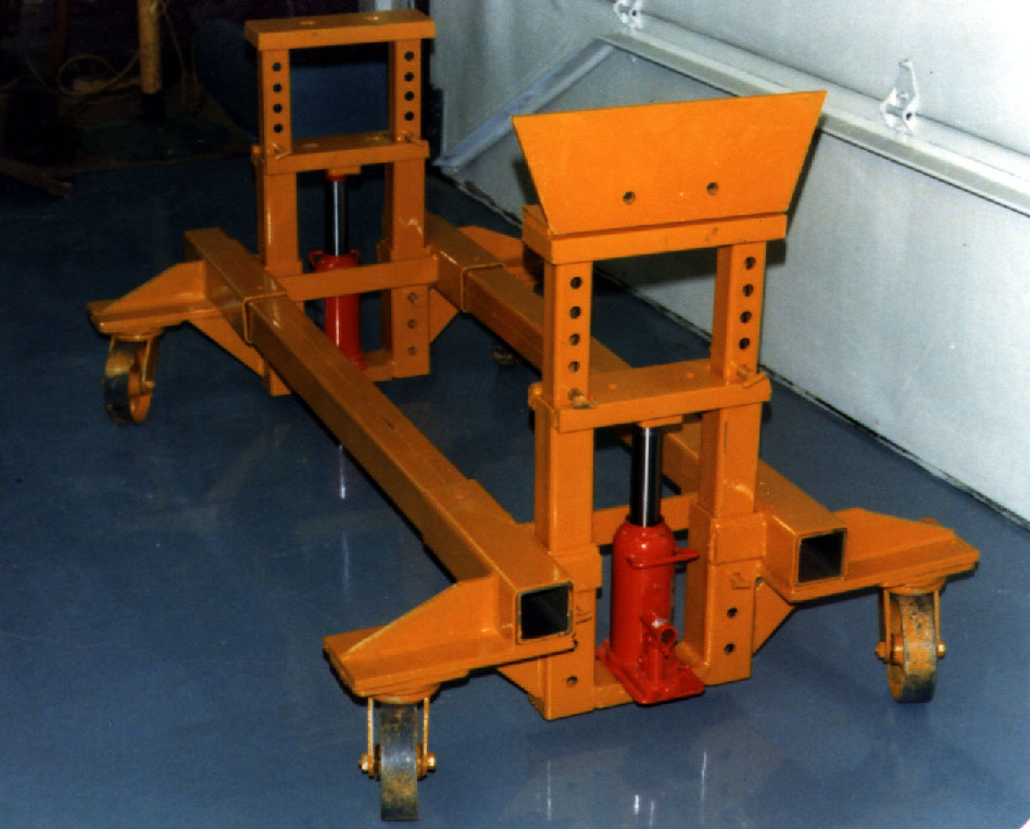

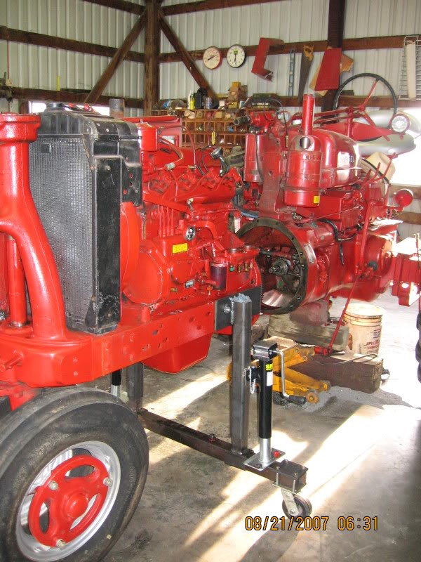

If one has a tractor splitter stand I would think you would have one right there,
the stand I built (do not have a picture of it and a neighbor has it), is a cross between these two pictures, it uses a small Hydraulic jack on each side to raise and lower for fine adjustment and has 4 wheels for stability and it has a diagonal brace for moving the front away from the rear, but only has the single up right working much like the trailer jacks, in the one picture.
one picture is from this site, Splitting stands. - Red Power Magazine Community.
the the other is from this site, Sample Page of Photos on Heavy Duty Shop Equipment: Tractor Splitting Stands: Model HR16

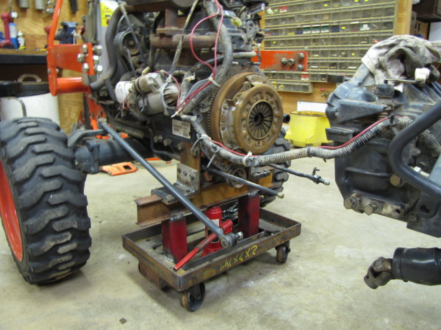

   / engine testing stand #5
This is what I came up with. It's hooked up to a B7800 in this picture. It well also fit up to my L4240 for sure, but should work on about any mid HP and down.

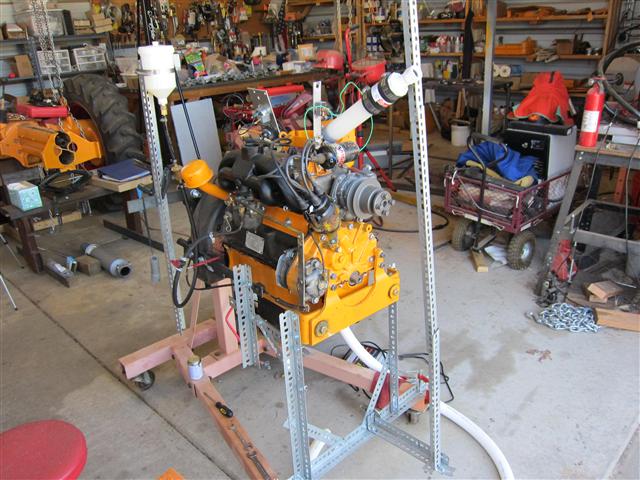

Here's the rig I use for testing my rebuild Hercules engine (4-cyl, gas, ~25hp) from the 1951 Minneapolis Moline BF tractor I'm restoring.
It's just an engine work stand from Harbor Freight, some slotted angle, nuts/bolts and C-clamps. The el cheapo approach :thumbsup:.
