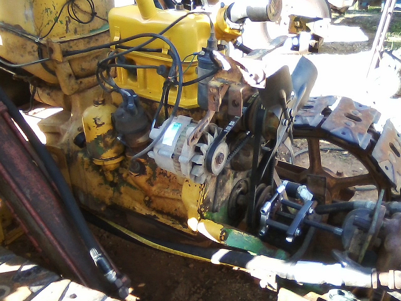

I already know. If you want to disprove it, pull a valve cover yourself. I just did a valve job on the 420 and I'm not breaking new gaskets.
In the case of the intake flooded with oil, I think it had something to do with a sealed crankcase emission system. A hose or port ran from the rocker cover directly to the intake manifold.

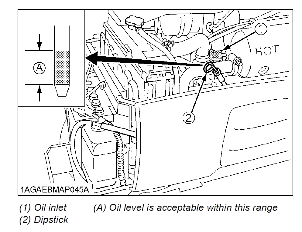

Here is my post from last month. Yes, my OM and WSM all say to fill oil from the valve cover fill port. I discovered a second oil fill port down lower on the block that lets the oil go to the oil pan instead. I filled to fast when i used the valve cover port resulting in oil from filling to fast to enter the breather tube and then into the intake manifold. I did have a partial hydro lok when i first started the engine after the oil change. On 2nd attempt the engine started right up. This is my 1st tractor and only have 250 hrs. on it, so this is all a learning experience for me. Engine still smokes but is slowly getting better. I may have to take it to the dealer to see if maybe a pushrod got bent or valve seal was damaged. Kioti is aware of the problem from filling to fast at the valve cover port, but they should have noted that in their manuals. Thats my story !!

Hi thanks for the advice.waiting for a shop manual.Had a lot to do just to get at 48 mm nut in crankshaft.I have my 9 foot plow hanging on a gantry ,and needed it to lift the fel to get at the crankshart nut. Put a bigger battery in frist and a new cable.tryed a three foot breaker on the crank,will not budge.I have a tarp over the gantry so I can work under it when it snows.Next I will remove glowplugs and inspect with a borescope I bought when they were really expensive, now they are half the price.
/ engine seized or hydraulic lock?
#32
Hi, the filler is under the alternater I have to use a long funnel to get around the alternater,bad place to try to get oil in.
