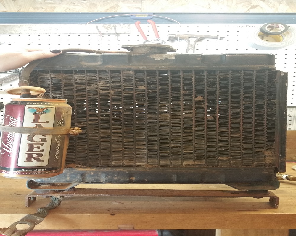

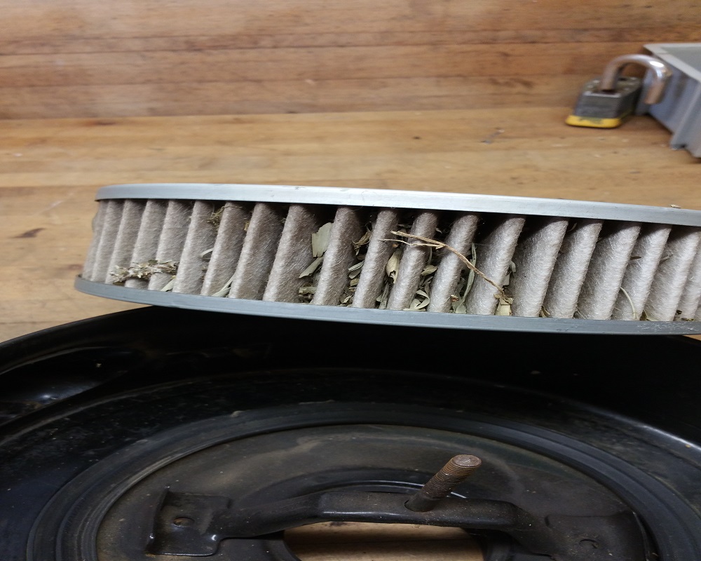

It looks like you found the cause however. Clogged air side of the radiator. What's the coolant side look like. If the PO used hard water, they can lime up an clog. Clogged air filter is also a culprit.
Probably never needed to come apart!
Thanks for the help on the cap Jerry. It is nice to know how to check them now. Yea I think the radiator and air filter was really putting a massive strain on that poor little tractor! You might be right on the motor not needing to come a part!
Here is some pics of the coolant side. It needs to be flushed and cleaned. radiatior 5.jpgradiatior 4.jpg

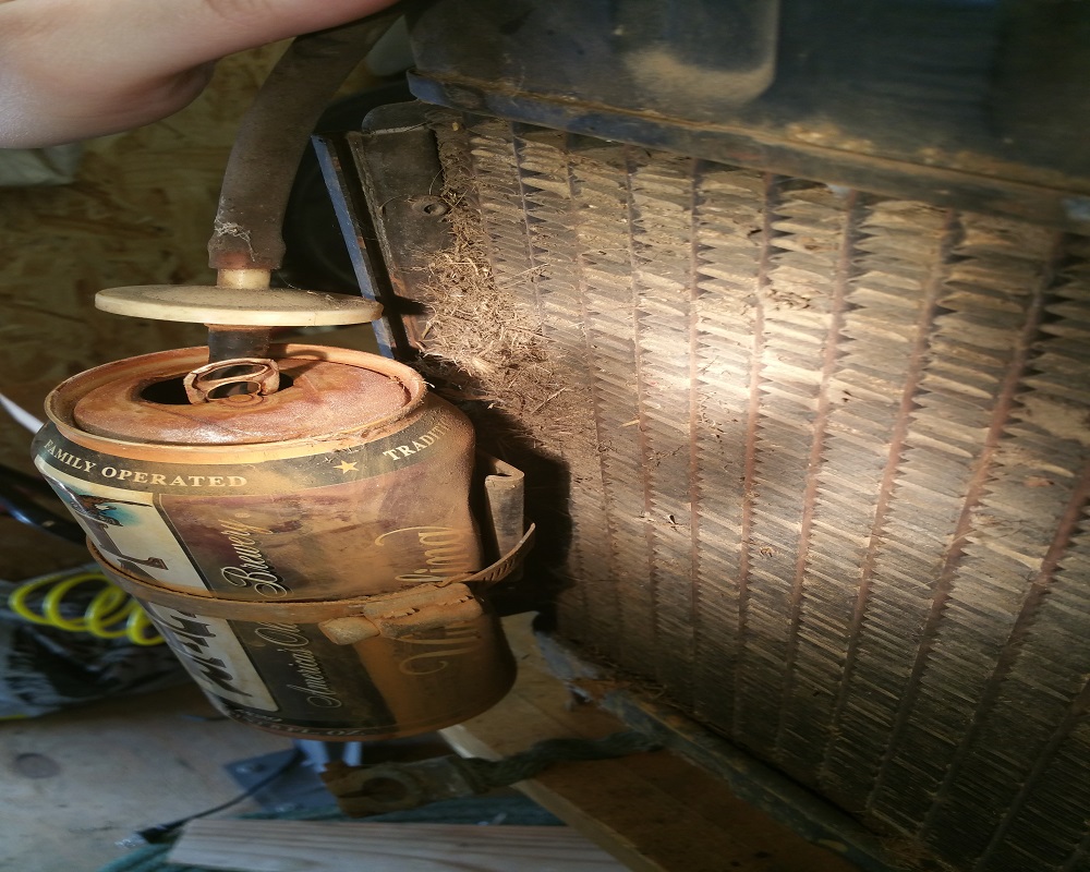

Fancy coolant overflow bottle you have there!

The coolant overflow bottle is very OEM! I am with you on every level when it comes to buying used machines.. This was a great price and I was willing to do some gambling on this one...but you never know what you are going to find when working on a used machine! Thanks for the well wishes. I will try and keep this thread going with how things work out.

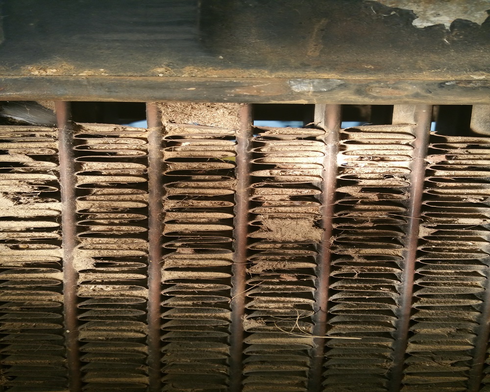

WOW- Can't believe the PO didn't clean or replace the rad before ripping into the engine...
That rad looks badly plugged and almost like Mud in between some of the cooling fins. Can't see how it could do a decent job of cooling the engine.

clean as best you can the radiator flush some water thru it and re install, use new oil and filter and see if she will run.
If- It will run without billowing smoke , excessive Knocking , and no bubbles running thru the coolant/water in the radiator either have a rad shop go thru it or if not to pricey replace it and the thermostat.
This is just how I would approach it , but am CHEAP by nature, this way you are only out the price of a head gasket oil and filter and some RTV sealant and will know pretty quick whether the engine is basically sound or not. If the engine oil in the pan is Milky, I would not reassemble the engine as is.

With the list of stuff you already have on your to-do, that little tractor will be happy as a clam. You can honestly probably skip a bunch of this - your cooling problem will be VASTLY improved just by hosing out that radiator (not too high of pressure). Just let your wallet be your guide. Stuff is way easier to have done when it's apart already, and re-disassembling is a pain. Doing everything on the list so far, except head milling and radiator re-core/replace should be reasonably low cost. Since it did likely overheat a LOT, checking for warpage and liner seating is justified. Two-cylinder heads DO warp if abused enough - even single cylinder sez some of my old motorcycles and lawn mowers.

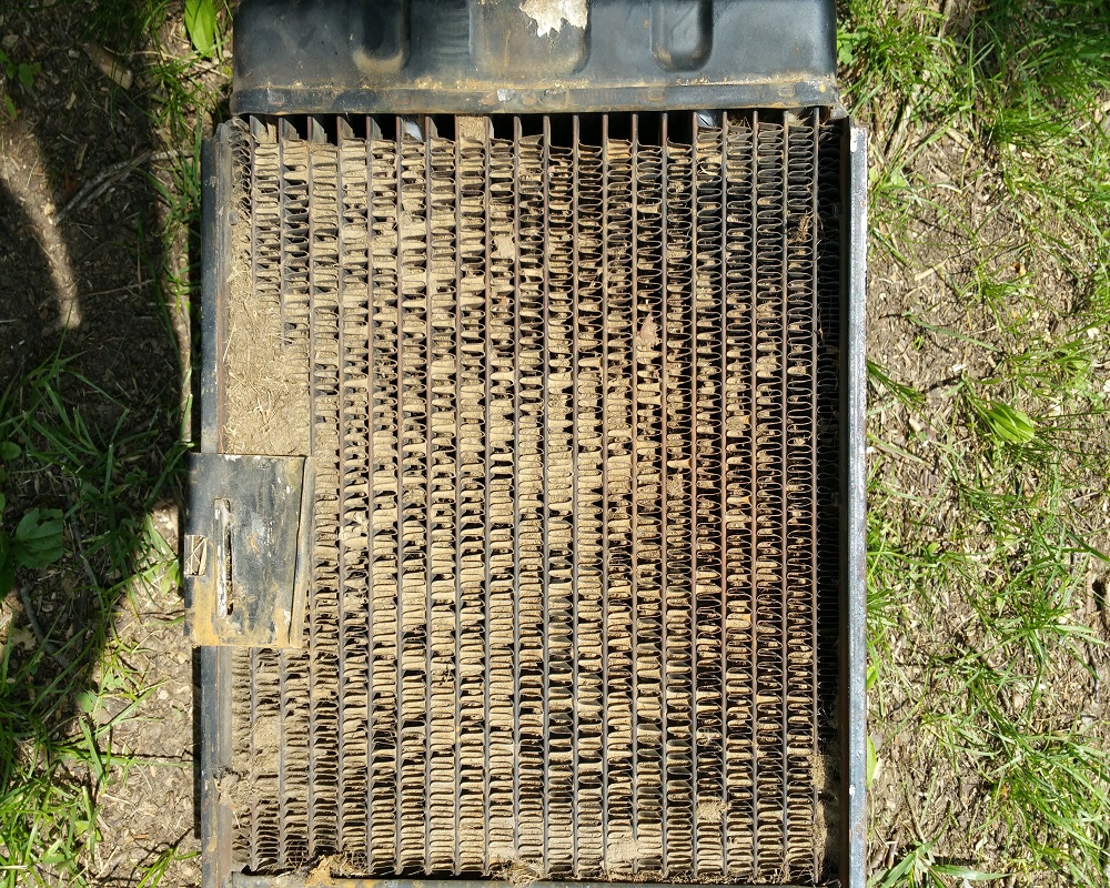

Here is one more pic of the radiator...I think you can see the amount of junk in the fins better in the sunlight . The pics dont do it justice..this thing is packed tight as a tick!

Cylinders look OK in your photos. Oil them with something to resist rust (WD40) then stuff with rags until reassembly. From what I see, there are no signs of overheat damage. An inspection by a proper shop will tell if the head is warped or cracked. Check the cylinder deck with a gauge made for such inspection. Flush the cooling system. Check the radiator/cooling system as mentioned by those more familiar with these engines than I, change engine oil and oil filter after reassembly. You might consider a used oil analysis to tell if there was a serious over heat. Blackstone Labs is a good source for engine oil analysis (no affiliation).
Edit; I just saw your photo of the radiator. Looks like you have found your overheating issue. I pressure wash my radiator from the engine side to the front side to remove all the hidden debris.
