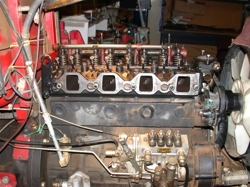

Cyril,
I have read several threads about the injector pump timing and also talked to Chip about it. He said as long as I mark (exactly) how it was assembled before, where the gears line up, and if I put it back together the exact same way, I should have no problems. So that's what I plan to do.
Sounds like you have it covered. Enjoy your week.

Taking all the geared and timed stuff off the front of the engine will be new to me. I suppose I will mark the mating gears tooth for tooth how it sat together before removing them completely.
If it is like all the Yanmars I have done, there will be letters or numbers
stamped into the gears to get the cam/crank/FI timing right. You do have
to turn the crank a number of revs before they line up. I have no idea
what Kama does. It was disconcerting when I opened up my latest
engine when I saw the letters as expected, but also some slots for the
FI pump bolts. These bolts had to be removed, so I marked where they
should be in the slots as best I could. No way did I want to change the
FI timing.
I looked at a number of those Youtube videos about rod balancing. None
seemed to deal with right-left big end imbalance that could exist or be
caused by uneven material removal during static longitudinal balancing.

My goal is to have end up with a good running and very reliable engine.
I don't want to build a "race motor". I'm going to do most of the balancing just because I know the stock motor may not be set up close to what it really should be. I've seen this time and time again on my inexpensive Chinese tractor. You do "get what you paid for" and I'm aware of this. A lot of this is because I don't mind going through with some of these things just for my own satisfaction.
It can't hurt.
I'm still waiting for the new crank to arrive.
I also ordered a gram scale online so I presume it will arrive this week too? I will have to make up that balancing fixture though. I've decided to balance the weight of the pistons and cranks pretty much the way that first video showed. Although you guys are probably right that the results might be indiscernible or even unnecessary, at least I'll know it's been done.
I'll be tearing down the tractor more this week.
Hopefully, I should have some photos by the end of the week some to show the progress. My main goal this week is to at least have the engine out of the tractor and mounted to the new engine stand. It will be a lot easier access to removing the rest of the engine parts. If the scale arrives in time, I can build the fixture for it too.
