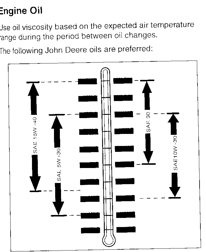

The time for an engine oil change has come, and when I look in the manual I find the attached, highly educational diagram.
It is easy to understand, except for the fact that there are no numbers on the thermometer in the diagram.
Does anyone know either where the numbers are supposed to be on the diagram, or even what the operating range of 15W-40 or 5W-30 is in my machine?

Dave, for summer use use the 15/40 or a straight 30 is my prefered oil for your 110. If you were using it for snow removal the 5-30 or 10 weigh would be the best.

I'll be.. I thought for a moment that you were given a "defective" manual by your dealer! Only to discover that I have the same manual...
They blacked out the temps on the thermometer scale! :confused:
Isn't that "special"?!? Gonna have to take a peek at my Technical Repair Manual and see if the "data censors" were at work editing that as well.

CurlyDave et al,
Does this help?
Joe
/ Engine Oil for JD 110TLB
Thanks Joe.
I printed that out, cut the paper down to size, and it is already in my manual. Looks like the 15W-40 will do the job for any temperature I will encounter in Southern Oregon.

Joe, thanks. Where did you find that chart? Your manual? Dave and I must have the "braille" version...
AKFish,
I located it in lubricant (oil) information from the JD website:
Oil, lubricants, and accessories Features and benefits
Oil, engine, Plus-50 15W-40 and 0W-40
Plus-50 and Plus-50 Synthetic Engine Oils
https://jdparts.deere.com/partsmkt/document/english/pmac/5565_fb_Plus5015W40_0W40.htm
You will have to read down through the page until you come to the section entitled "Air Temperature Chart."
