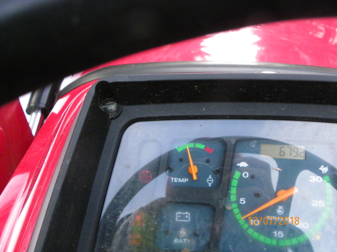

/ Engine Coolant Temperature Gauge 4540/4550 #12
Here's where our gauge on the 4540 usually runs at.
