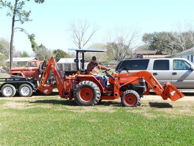

Anyone got any tips on the break in on my new L3400? I wan't to do it right the first time.
