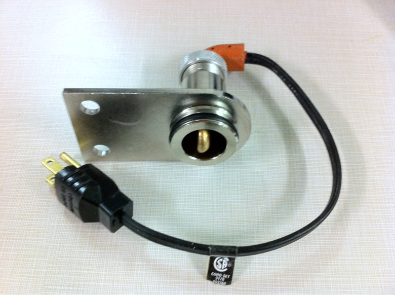

The factory heater is unique in that their is a flange with 2 bolt holes that hold the heater in the block. Their is no room for the heater element inside the engine block so the heater sticks out from he block and the element is inside a tube surrounded by the coolant.
I have never seen a block heater made like this one.

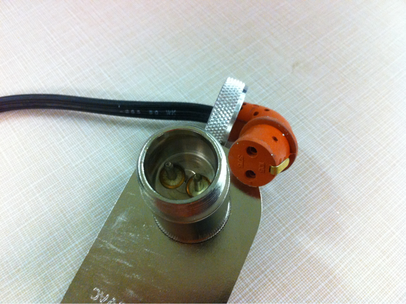

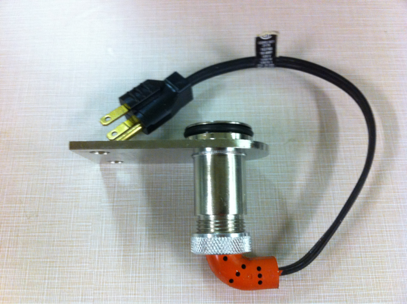

Can I assume this means nobody wants measurements?

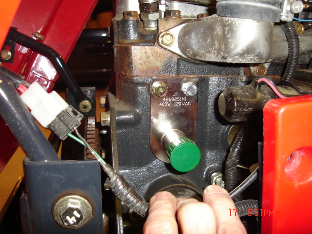

I have a link in this thead, post #2, that explains how I installed mine, :thumbsup:. KC :D :D :D

Kal130, nice pics-- didn't think to get some shots of mine before I put it in.
You may have already read this, but the threads on the electrical connection are the same as a garden hose; you can put a garden hose cap on there to keep the cord safely removed and stuff out of the socket during the warmer months (all 3 of them!:laughing::laughing:).
Thanks for the photo's.
I would sill like the diameter of the part that you insert, and the length of the insertion.

Diameter of shaft. 1.4125"
Depth of penetration. 0.4245"
Approximate OD of O-ring 1.45"
