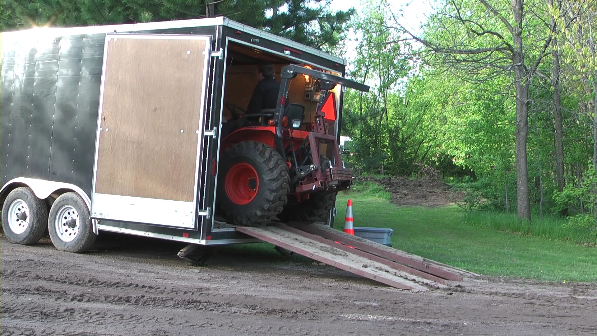

One other thing. If you are thinking about V-nose and need weight distribution bars. Check to be sure they will fit.
I added a couple picks loading my trailer.
Brian

Suggesting a width wider than 7' has more to do with climbing in and out of the trailer when the tractor is loaded. And carrying/storing tools, spare tire, jacks, ect. I keep a two tool boxes, wrecking bars, pieces of woods for blocking, leveling, and jack pads. I always find it amazing how much stuff I find myself tripping over in there.
The ramps I built myself. They are about 7' long, 23" wide, and (I'm guessing) 70lbs each. The ramps have a lip that sits on the tail. Built so a I can use them on anything about 14"-26" high. If notice there is a rail on one side only. The ramps can be pushed together for loading anything else on wheels. By way in pics the left and right ramps are swapped. The mower deck wheel like to grab rails. If you like the design I can post more specs and pics. Or I found a few ramp builder before I decided to build my own.
I bought my trailer off a lot. Got a very good price, but also no options. No tie down points, e-track, additional lights, etc. With the Torflex axles I've next to no movement off anything while towing.
My United is very well built where it counts. Like the frame and wiring. I am a little disappointed in some of the welds that aren't structural. Some the trim and finishing work could've been better. But, YES, I would consider another United trailer.
Something else I haven't mentioned is I am planning shore the last few feet of the deck from below. Since the tail is gets the highest traffic and is the most exposure to the elements. Mine has developed a slight sag under load.

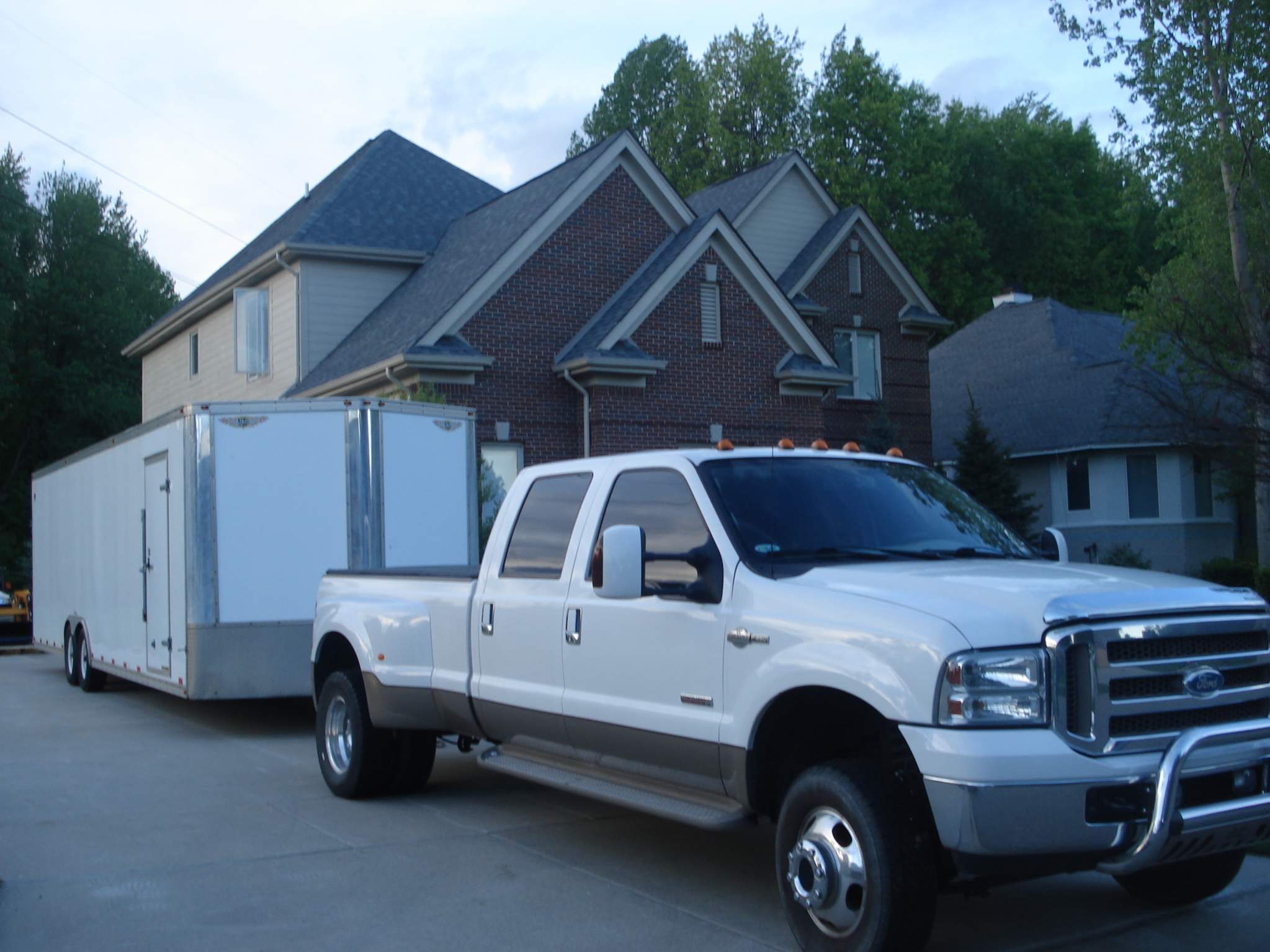

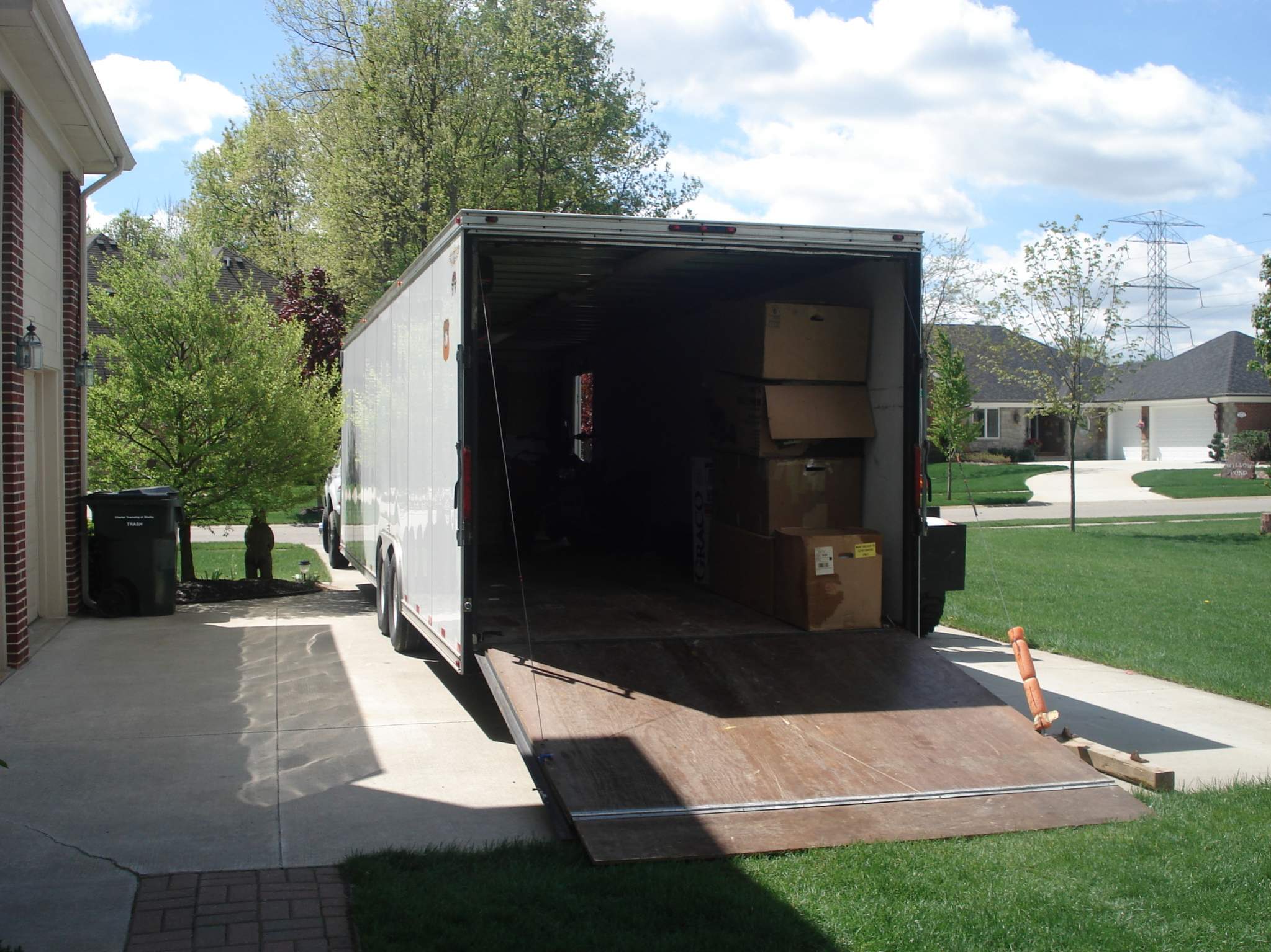

I have had 2 different custom enclosed trailers built for myself. The first one was a TrailBoss 22' x 8' bumper pull. I was on a very limited budget and didn't realize how much weight I was really going to end up carrying. It was rated for 10K with two 5200# torqueflex axles and 10-ply tires. My application was different than yours but the lessons learned should still apply. I used it as a mobile shop, so I had all of my tools, toolbox, solvent tank, air compressor, hydraulic hose machine, benches, welder, generator, nuts, bolts, and various inventory. This trailer was poorly built on top of not being rated for the weight I ended up with. The axles lasted a year, the tires didn't last 6 months, and I was constantly rewelding he wall supports, and poked more than one hole in the 3/4" plywood floor. I upgraded to 6000 lb axles and 14-ply ires, I never had tire issues again, but the axles still only lasted a year. I'm guessing I was carrying closer to 14K in this trailer.
My newest trailer is a Wells Cargo 28' x 8' gooseneck rated for 20K with two 8000# torqueflex axles and 16-ply tires. It is far better built than my first trailer, and had the price tag to prove it. I put all of the same equipment in it, and it is holding up much better, plus I had Wells Cargo install custom cabinets and workbenches. I learned it was better to over build than to under build.
Shop some different manufacturers. For your application I would do more than the 3/4" plywood floor. Wells Cargo offered several different choices of thickness and material, I'm sure others do the same. I would consider adding more floor supports also, especially if their standard is 24". I would probably do 12" centers with tongue and groove flooring. I agree that the barn doors are probably a better choice than a ramp door, even the heavy-duty one. I can see where being able to load material with a forklift would be a big plus. Make sure the door opening is going to be tall enough to clear your ROPS. I don't see a problem with torqueflex axles. I worked for a landscape contractor that had a fleet of 10K# equipment trailers all with torqueflex axles and they were never a problem, and they were always right at the weight limit. My issues with torqueflex axles were simply from me far exceeding their weight rating. I would look at the cost difference between 5.2K and 6K axles. I would also highly recommend a weight distributing hitch also, it is such an improvement in the towing characteristics.
