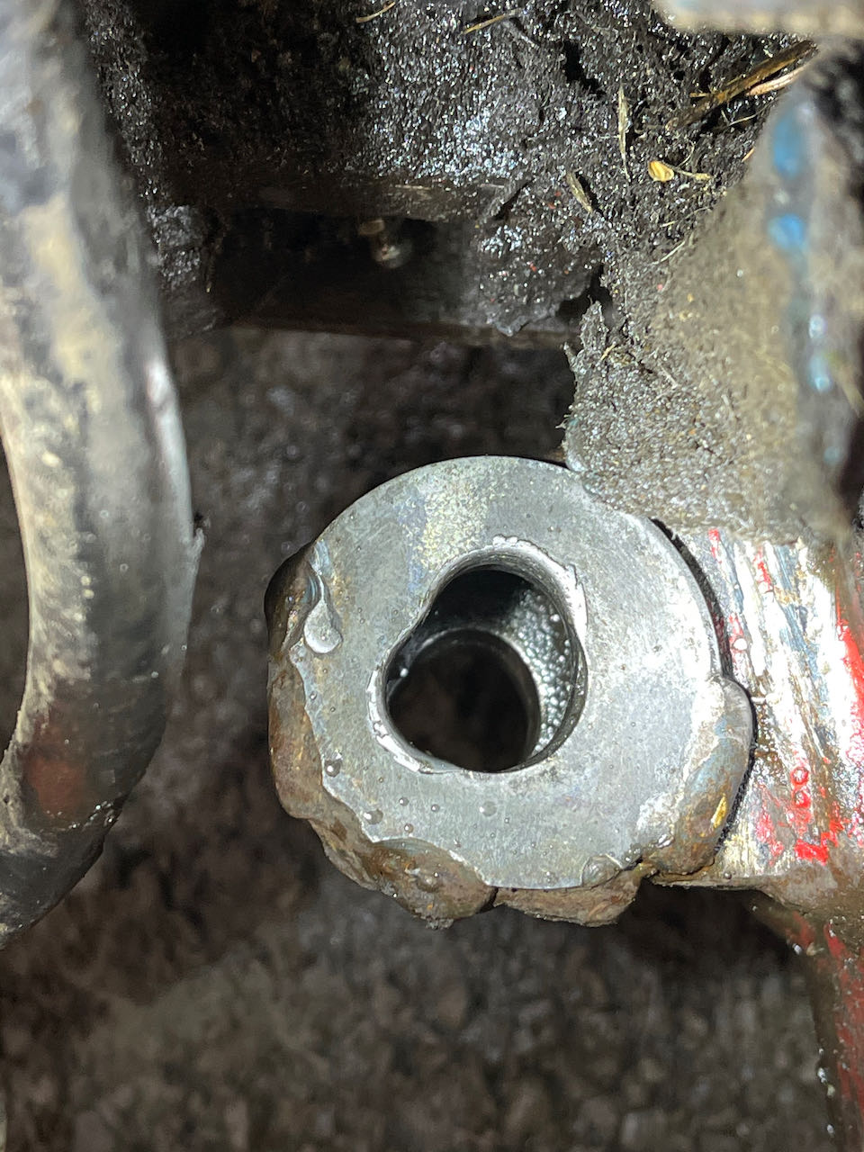

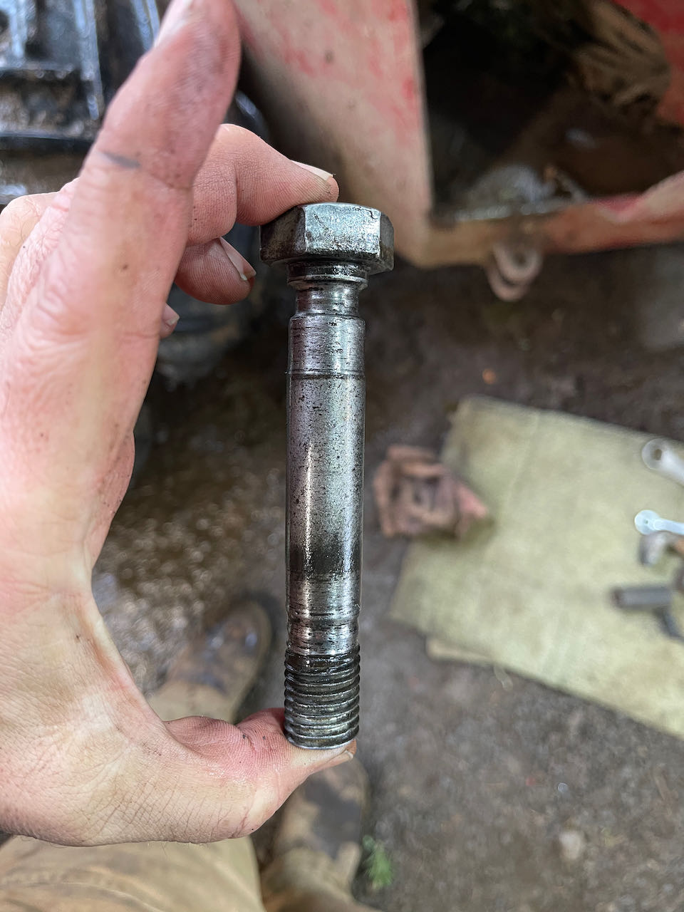

So a few weeks ago I posted about how my steering cylinders where flopping around... I wanted to show you the elongated holes. This is something that my 1850 suffers from in a variety of places. I don't think that this is the best design, but I get why they do it. I will order new ears, or makes some up next time, but for the moment I welded on grade 8 washers and replaced the bolt and that will keep me through the summer.

that shouldn't happen if there is enough lubrication.. it probably ran dry.. the short bearing surface contributed to that too, is that 1/2" that wore?.
/ Elongated Holes #3
It looks to me somebody already welded a washer on top of an elongated hole and that matches the grove cut into the bolt. Just a note, be careful welding on the hyd reservoir when full of oil.
/ Elongated Holes #4
So it appears.
Not enough contact/bearing surface. Needs to be a sleeve or tube.
Grooves in the bolt confirm that.
Drilling oversize and using a matching oversized bolt/pin would be a preferred fix.

It seems like somebody, you?, has already done that quickie fix, but you are putting a great deal,of the hydraulic force on a small area, with the washer taking the brunt of the force. You can see all the wear on the bolt.
New eyes are the way to go. Welding them on should be a quick fix, depending on your tools for cutting metal.
Drilling an eccentric hole like that is tough on the drill and bit, but it can be done. However, it isn't going to leave you with much metal, and I would worry about the strength of the eye if you go over size.
Or drill oversized then put in a bushing to reduce the hole down to the size of the original bolt.

I have used shaft couplings to make bushings. Sometimes had to add gussets each side to reinforce where cutting out for the OD of the bushing doesn't leave much meat. Tack a flat plate on the back side of the elongated hole and use a hole saw to cut out for the bushing.

My bet is that the prior owner didn't lubricate the eyes, they then elongated out, the prior owner then tacked on the washer to hide the elongation and reduce the rattle, and you bought into a previously worn eye that was resting on 3/32" of mild steel, which wore down quickly. Are all the elongated holes ones that don't have grease zerks?
I don't think it was your doing, despite all the wild driving on 45 degree slopes (kidding!). My bet is that if you put new eyes on and lube them regularly that you won't ever have this issue again.

The reason the holes elongated was first was not lubing the joints and second not keeping the bolts tight. The fix is weld up the hole and bore it....... jim
