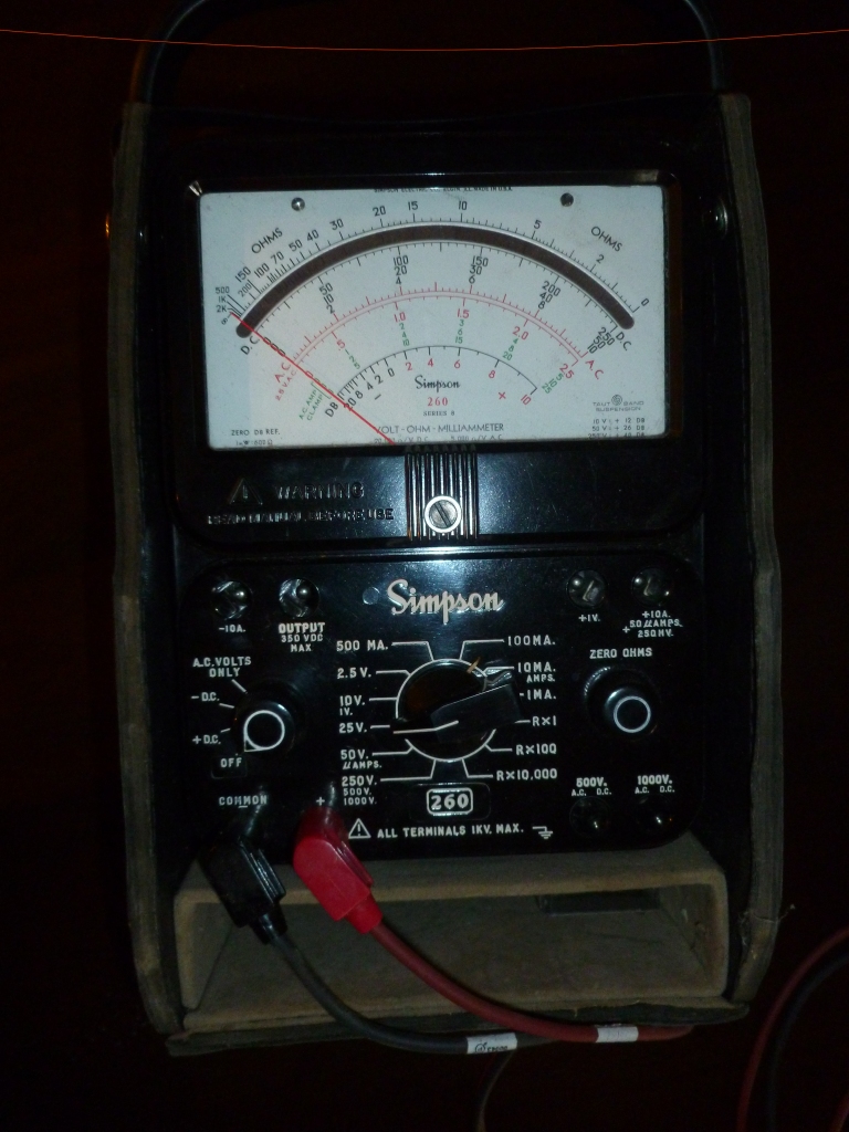

One of my meters is a Simpson model #260. I have owned it many years and recently it quit working. I have changed the battery and checked fuses but no luck. Love this unit but now it doesn't work. Any ideas?

First and obvious thing: If you can't get ANY readings at all, have you verified your leads are working?? It's possible one of the leads could have a frayed connection where it solders to the jack, or the test probe. If you are able to get ANY sort of readings, then the leads are obviously ok. Which leads to a likely defective component on the board inside it, or possibly the meter movement could have gone bad. Only way to tell that is to open it up and start checking things with another meter.

On Simpson 260 be sure to read out your leads to make sure they have continuity? Use your other meter to do it? Sometimes they break inside without showing, then there is the stretch test ? They will stretch at the break? A battery usually brings mine back. Now I need to remember to remove the battery, to prevent leakage from it sitting?

Appreciate all who have provided comments on the Simpson 260 and hope to have it back and working soon. It is a great tool if one knows how to use it properly. Do you think I could locate a user guide somehow, somewhere?
