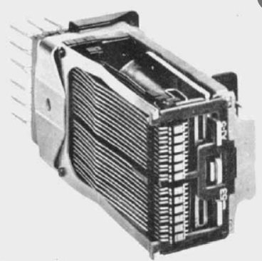

Now there are relays..... This was very popular in early telco crossbar switches . Until most everything went solid state.... Spent many a hour with close association with these. In comparison the average relay found in car/truck/tractor applications are very simple....
Spent some time cleaning those nasty things in the early part of my career. Before everything was solid state. Didn't like it much. We only had two of those PBX's left. Both were NEC (Nippon Electric Corp.) One was the small NA120 and the other was the NA409
