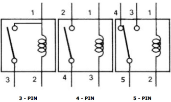

I don’t understand the comments about 3 pin relays being rare. They’re quite common. They’re all over the place. Just Google it. Flasher relays, horn relays, etc. Used all over the place in automotive, industrial, electronics, appliances, etc. In the general case, a three pin relay is just a Single Pole Single Throw (SPST) relay in which the load and coil share a common pin (See picture below). I’ve seen & used both NO and NC varieties. The advantages of a three pin relay are lower relay cost and you only have one common/ground connection out of the relay. Three pin relays are used less often than 4 and 5 pin relays so you don’t see them much in aftermarket because manufactures churn out 4 and 5 pin at such low cost. But for an OE buying large quantities, when a 3 pin can be used, it lowers manufacturing cost.
As for a relay tester, I suppose you could have one for the standard automotive relay form factors (Standard ISO, mini ISO & Micro ISO terminal footprints), but there’s an almost infinite variety of relay footprints out there and I don’t think a universal relay tester would be practical. Even in the ISO relay footprints, there are thousands of non-standard internal wiring configurations that would be cost prohibitive to build a tester to test them all.
picture from this article on relays…Relay article

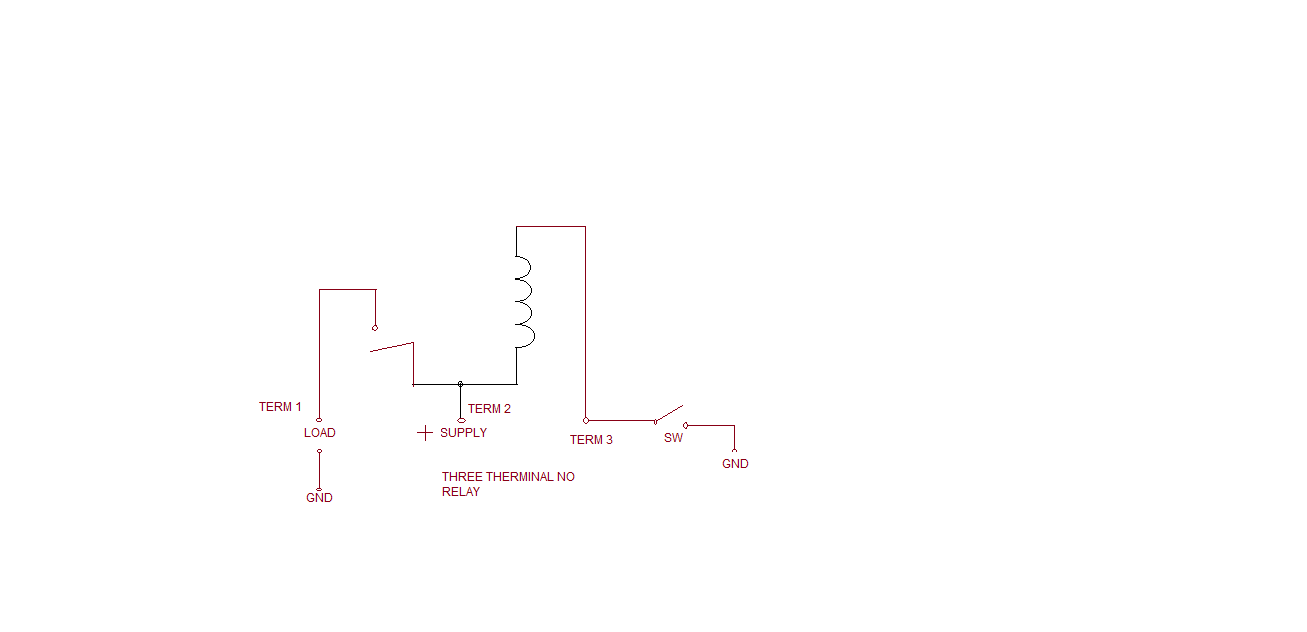

I love relays and use them to control actuators on snow implements. This is the setup we use. In 15 years of use, never had one of these 30amp versions fail. (don't use the limit switches shown here)
