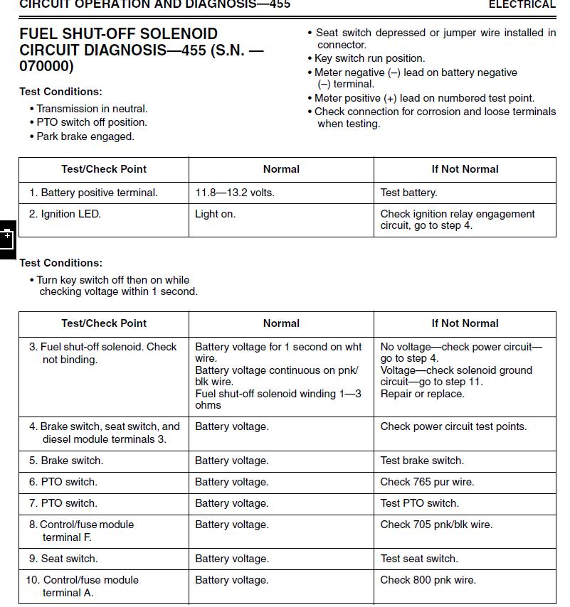

I had to cut around about sixty trees a few days ago and just as I finished the tractor shut down as if I had turned off the key.
There is no indication of power from the switch key... no guages or lights. Seems to me that when I had a problem with one of the safety kill switches I had guages/lights but it just wouldn't start so I'm thinking it's something else. Not positive about that though...
Battery is hot.
Any idea where to start troubleshooting short of the dealership?

Here is a possibility, that it being the fuel shutoff solenoid. You can prolly watch it (or listen for it) to click in when turning the key on.
From the tech manual CD (might be good to get ahold of one, either eBay or the dealer, if you want to do the work yourself), here is the diagnosis procedure.

There's no sign of life when I turn the key on. No lights, guages, or anything. Otherwise I would have thought it to be one of the safety kill switches.
