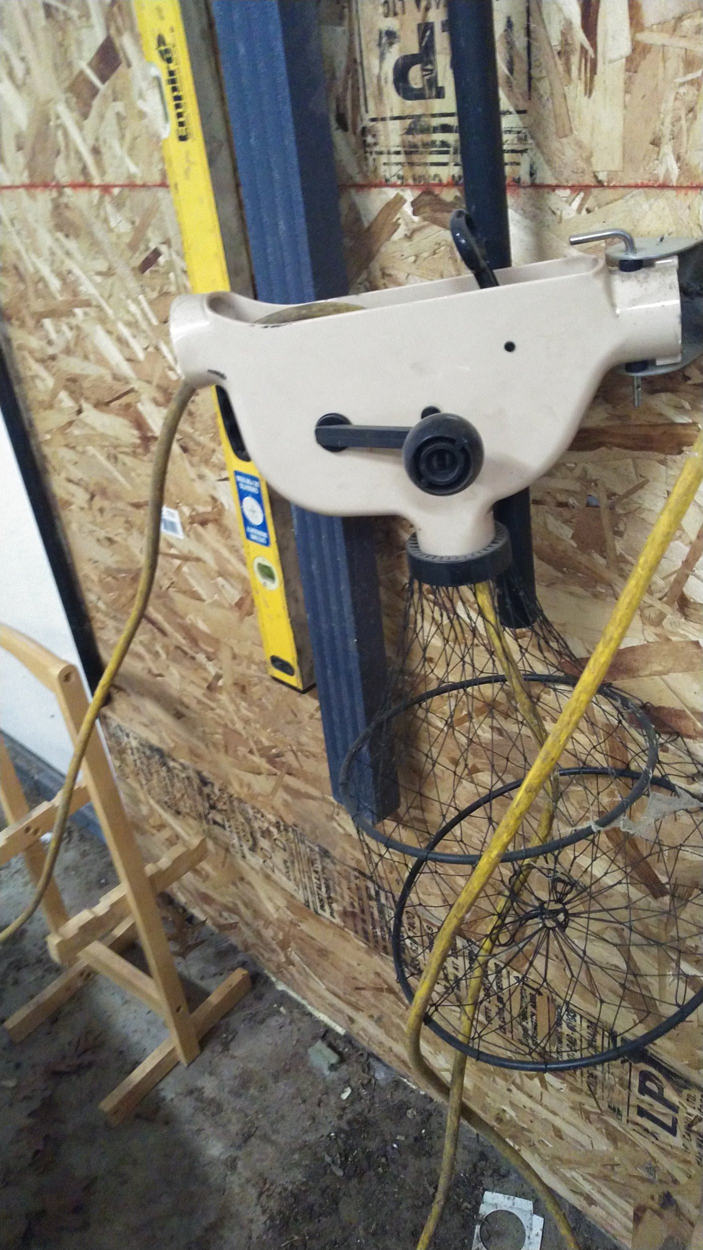

Got this wonder winder as a novelty gift 5 yrs ago I like how well it worked I bought a few more I can store about 100' of 12-3 chord in part it's easy to pull out, put back in, never tangles and take the chord off if it's needed elsewhere. Imo it's not built to be used in higher production environments or a welding shop. I've also put a female plug ends on old broken retractable drop lights. 18-3 but will power a small router or sander no problem. I apologize if already mentioned but when I'm coiling chords free hand I pull an arms length with one hand and put a 1/4-1/2 turn in at as I coil.
