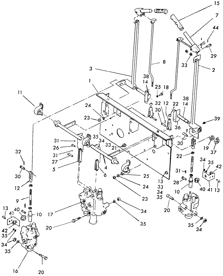

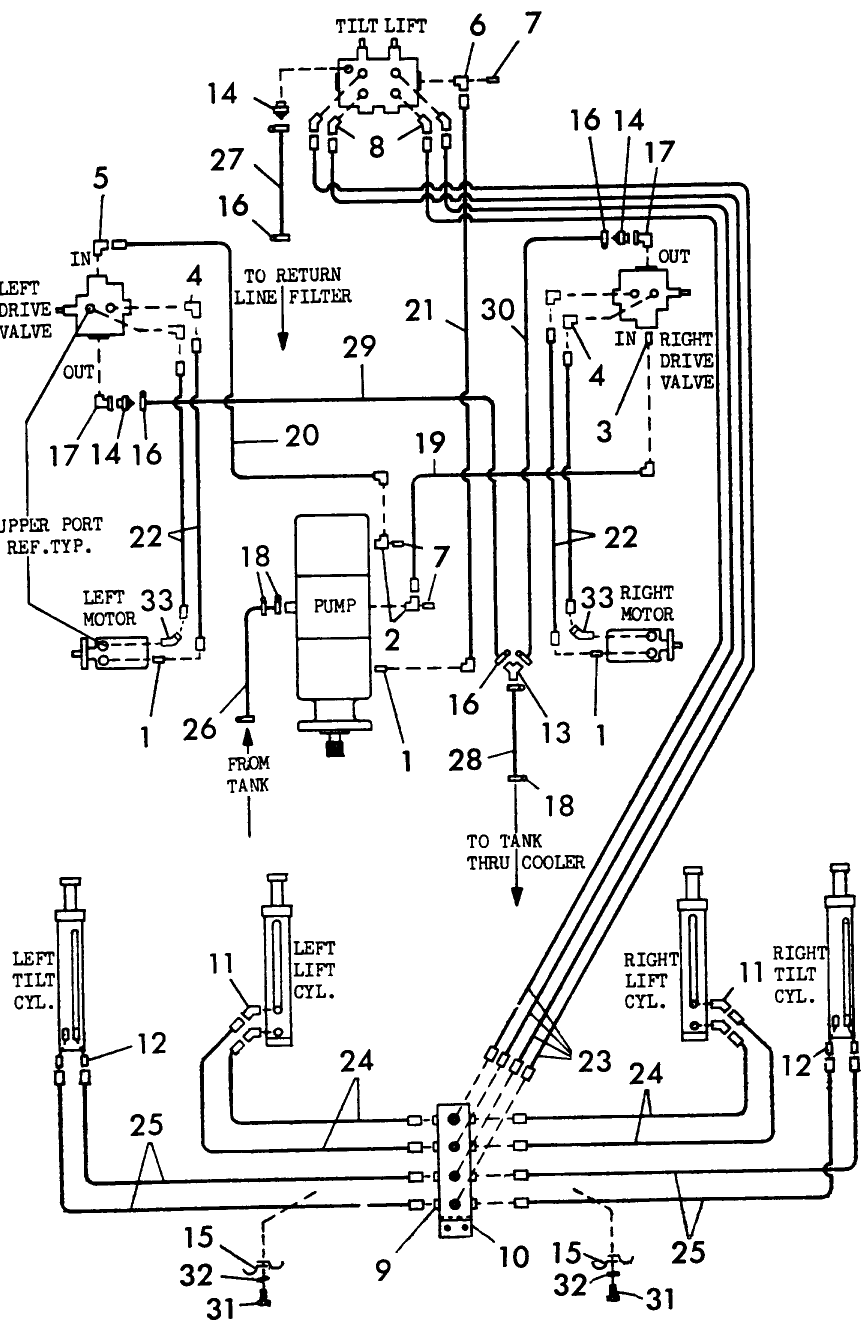

I have a 4 way loader valve. I want to re-do the controls and such on my machine. Right now I have sloppy and somewhat long linkage to the valve. I was curious if I could purchase something that is 12v that will pull or push the valve, that I could connect to a self centering rocker switch. I'd love to replace my handles with a nice pair of grips with a thumb rocker to operate the bucket and loader arms.
Pictures attached :)
I know I can replace the whole valve but I'd rather just add some sort of push/pull solenoid.
-- Joe

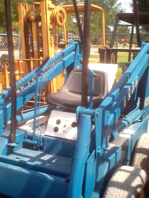

It's a old Ford/erickson skid steer.
I'm trying to make the machine easier to use. It was designed for a 4 foot operator with girls legs. The sticks to drive the machine are in the wrong spot, the linkage to the loader controls is on the sticks. See attached.

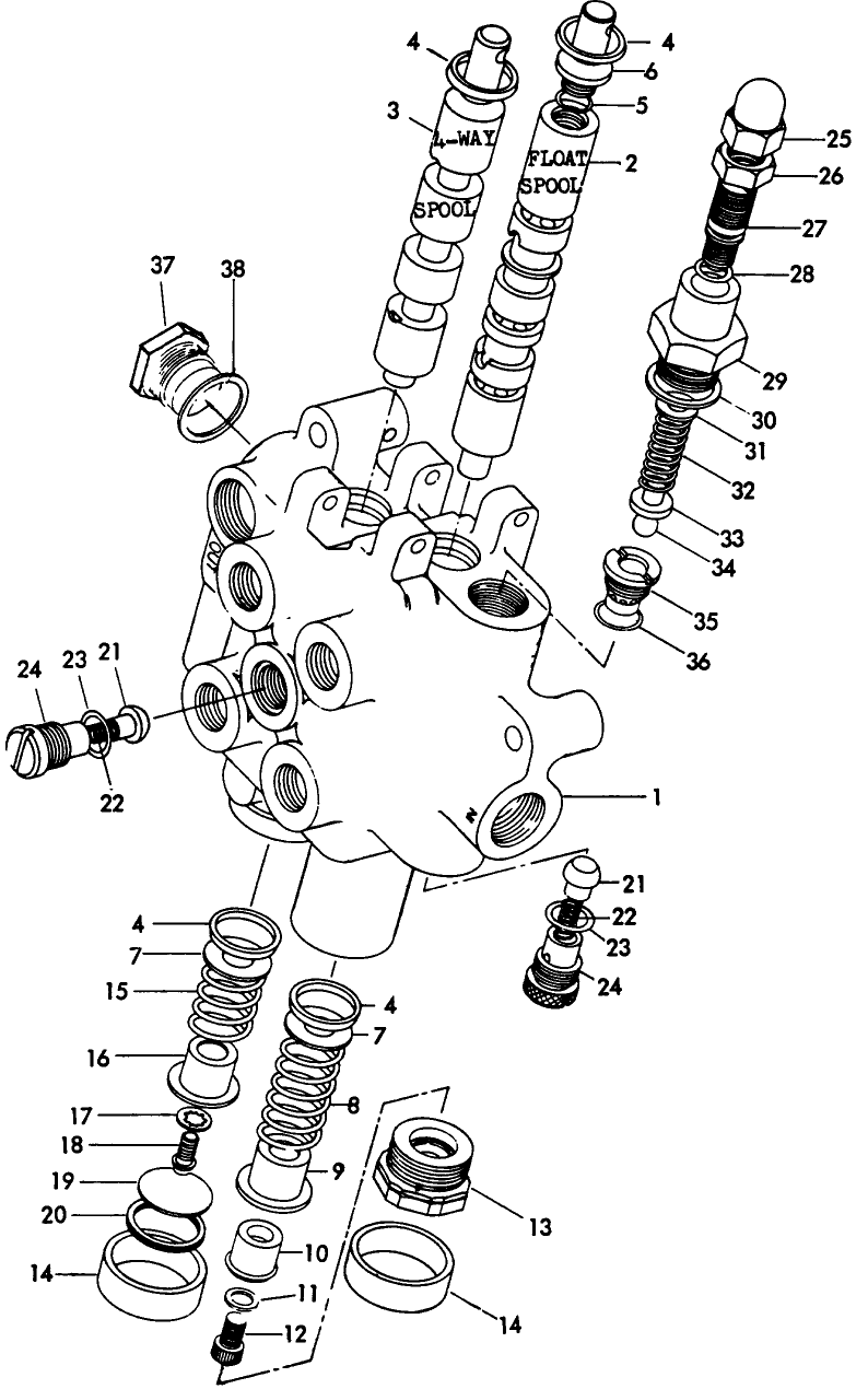

Attached to this is diagram of the factory loader valve. Do you think I could replace this with two valves from Northerntool? A float for the boom, and regular spool for the tilt ?
Northman Fluid Power Hydraulic Directional Control Valve – 16.8 GPM, 4500 PSI, 3-Position, Double Solenoid, Open Center Spool, 12 Volt DC Solenoids, Model# SWH-G02-C3-D12-10 | Power Solenoid | Northern Tool + Equipment
These mount to a block with 3/8" NPT ports. I think my ports are -6AN (or jic or whatever it was called before the aircraft grade).
-- Joe

That sure looks like a regular spool valve to me that would be proportional. I think you are mis-understanding something the manual.

You want "tandem center" spools-they will keep the work ports blocked in neutral (so the loader stays up) and you still need the proper subplates.

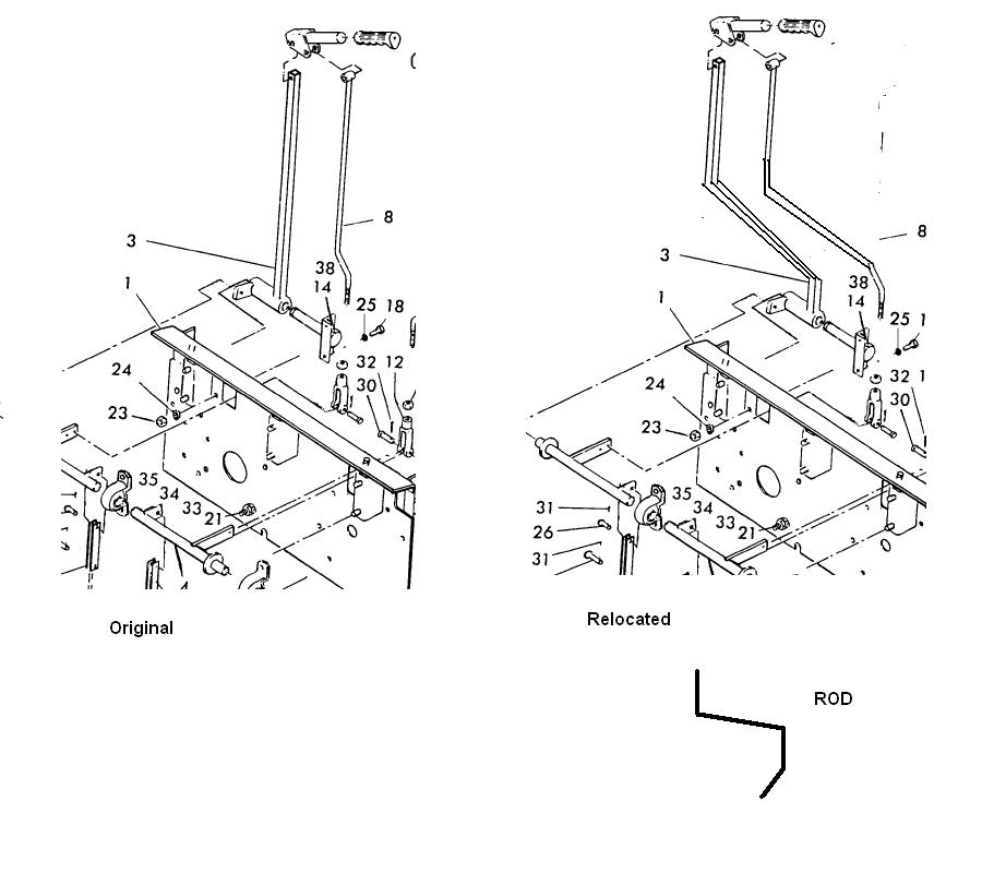

Here is the thing. I'm replacing the sticks anyway because the holes are elongated so the hing effect for the controls is faulty.
While I operate the machine, the sticks crash into my knees making it VERY hard.
I made some new sticks with my bender out of 3/4 stock like the existing sticks. I put a 45* sweep back, and then another 45* sweep up, and intend on welding the sticks as far outside as possible so they will rest right beside my thighs.
Now that is fine, but the linkage for the loader must follow the sticks. I'm afraid that if I try and put the same bends into the rod/linkage for the loader on each stick, it will bind. Please see attached images.
The rod will have to go:
6" to the right
then start going up and back at 45*
Then go up and forward at 45*
-- Joe
   / Electric valve control?
#12
I built new sticks for it, and re-did the linkage. Hopefully the angles will work.
