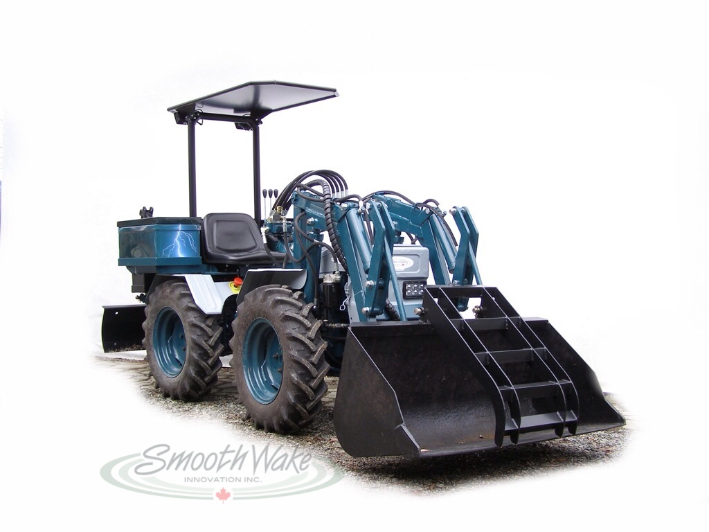

   / Electric Tractors Anyone? #6
A friend of mine engineers electric tractors for "green" customers. You could check out a small unit he did at Moving Forward - Smoothwake.ca and the pictures are of a Pasquali 997 that he converted for logging. He does some interesting things and can be reached at the smoothwake site.
