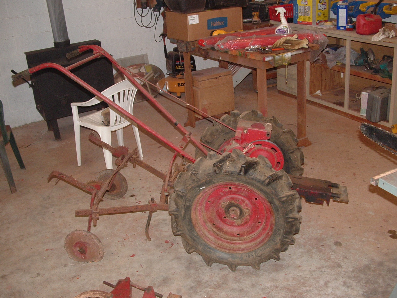

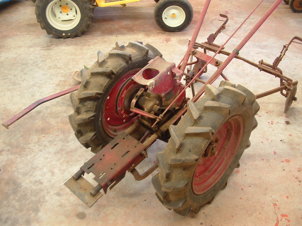

Maybe some more detail will help. I have an old sales brochure that lists the shipping weight of the basic David Bradley tractor with the tires on it and a 1 3/4 gas engine at 238 pounds. The claw tread tires were 6.00 x 16.
42 lb wheel weights were an option for each wheel plus the tires could be filled with liquid ballast. The engines were 1 3/4 hp up to what may have been about 7 or 8 hp in the last years of sales, but most were 2-5 hp machines, I suspect. Most I've seen had Briggs & Stratton engines.
The pulley visible in the photo above the tire that Nat posted is the clutch pulley. Power is transmitted to this clutch pulley and then internally this drives the differential. On the basic models, the speed was adjusted by changing the size of the pulley on the engine. The ground travel speed was advertised as being changable from a top speed of 2.4 mph to 2.1 mph at 3200 rpm by changing the engine pulley. Minimum speed was .7 mph. On some later models, the speed was adjusted by moving a lever that controlled a variable size pulley on the clutch. Also, on some later models, there was a reverse feature and a differential lock.
There was a front mounted 24" inch rotary mower attachment and a 24" reel mower attachment offered. I saw a picture of a wider attachment on another website that appears to be a 3 blade unit, but couldn't find the specs.
The plow, disk, etc. mounted to the rear. The plow had a shipping weight of 58 lbs. The front mounted snow plow had a shipping weight of 53 lbs.
It's not a very wide machine. The tires can be shifted in to 16 1/2 inch on center of the tread to 24 inches on center of the tread. Clearance under the tractor was 11 inches. The claw tread tires were advertised as having a height of 28 inches.
I'm guessing that Nat's model may be the basic model because I didn't see the levers for the variable pulley, the reverse or the cable control for the differential lock.
It shouldn't be too hard to mount an electric motor to the DB just because it's so open and it's belt drive. They also had a ride on cart that connected to a hitch on the drawbar on the rear of the tractor. So you could put the batteries in the cart.
Although I was thinking I'd like to see a Gravely converted to electric power, the DB should be easier to convert.

/ Electric tractor #77
Thanks for the info.
The 238 lbs is a good deal less than the 350 lbs I used for the motor power estimate. If I go with the same traction coefficient of 0.6 and 2 mph speed the ideal wheel power consumed with the machine at the limit of slip would drop to a tentative 840 watts x 238/350 = 570 Watts. This would still need to be factored up to cover any loses in the mechanical transmission to get an indicative motor power output. So a 750 W motor might do it rather than a 1000W unit, it's easier to get 24V motors at the lower powers and a 24V system, needing 2 x 12V batteries might be wee bit easier to package than a 36V 3 battery arrangement but there's not much in it. I'd look at how much cost I'd save with a smaller motor and if it wasn't much I would still be tempted to try the bigger one - more capacity to play with if the sums are wrong.
The availability of weights and wheel ballast confirms traction was an issue, and the availability at the time of 7 or 8 Hp machines makes me wonder how all that power was used - and if I'm missing something, it has been known!
On the +ve side a lighter machine should mean lower current draw as the wheel torques can't rise so high, and this will prolong the duration of the batteries.
If the IC engine speed was 3200 rpm, then this is helpful because the max speed of many electric motors isn't going to be much different from this and perhaps the existing transmission elements might be used as is. This would need to be checked once a motor was selected and its actual specs known. Strictly speaking an electric drive wouldn't need a clutch as the controller could take it from zero to full speed and reverse without mechanically disengaging the drive. But it may be too much trouble to muck about with.
Hmm... who's going to have a shot? ;) I guess we would never really be sure until one was converted and set to work.
Ian
