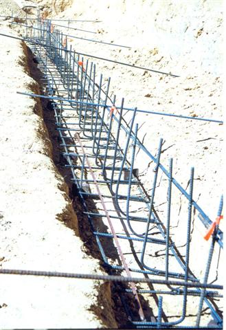

Hi Sparkkky!
Grounding seems to stir up more controversy than most subjects doesn't it? I'm curious, have you ever ohmed out the earth ground systems you installed to ensure it is 25 ohms or below per the code? I don't know of any inspector anywhere that has ever required that resistence be verified, even with single driven electrode systems. In my area, the AHD requires two rods be driven and calls it a day. The fact is, even though the two driven electrodes meet the code, in most cases, the resistence will still be 100 ohms or more, especially in sandy, dry or rocky soils. The bottom line is that the driven electrode system is the least effective grounding method, but it is the cheapest and hence the most widely used. Yes, I am guilty of this as well, especially when re-wiring an old house when expense to the home owner prevents better options.
So, what is the most effective grounding system? Some might say a metal underground water pipe, but widespread use of PEX & PVC piping have just about eliminated that. Article 250.81 lays out several preferred grounding systems. Note article 250.83 states that if none of the electrodes specified in 250-81 are available, then the electrician may resort to "made" electrodes. Well, most electricians go straight to the inferior methods, usually the driven rod as the primary choice. And in most cases, (all cases in my experience) the AHD says you have met the code.
For my money, the concrete encased electrode specified in article 250-81-c fits the bill perfectly. See attached photo. Now, which system would you really rather have? A 5/8" x 8' rod protecting your home, or a 200' x 12" concrete encased system?
Now, please understand that my intent is not to criticize anyone. My intent is to show that there are far better ways to ground your home and protect you, your family and your appliances from power surges & ground faults. Meeting the minimum standards passes inspections and moves you to the next phase of construction, but it is not the best protection available in many cases.
I hope I haven't bored you folks too terribly, as I find grounding discussions more stimulating than most folks. /forums/images/graemlins/laugh.gif

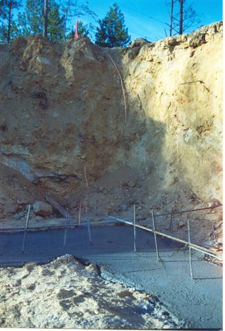

Another shot of the concrete encased electrode conductor in the poured footer. Note in the first picture before the pour, the electrode is in direct contact with the steel re-bar.

It is good to hear that ground resistance is tested in some places. Have you ever gone back and retested after a year or two? I know that resistance can be decreased with rock salt and water, and that the electrode must be re-treated periodically. What about during drought cycles?
As you can see from my photos, the soil under my house is sandy. No way I would trust a driven rod alone to protect my home, plus it doesn't cost much more for 20' of bare copper conductor in a concrete footer. I put 50' of 1/0 bare copper in mine. Small price to pay for peace of mind IMO.

Me too Sparky. When I would do re-wires, I would call the inspector for the area I was servicing and find out exactly what he was looking for. Makes life a lot easier that way.
You are right about the planning. Not too many general contractors ever think about bringing the electrician in when the footing is being dug. In most cases the electrical bids have not yet even been given in the foundation phase.
/ Electric Sub-Panel Installation #39
I agree that the re-bar electrode is far superior in some areas of the country. AND it is now required in the 2005 NEC® if re-bar in the footings exist.
