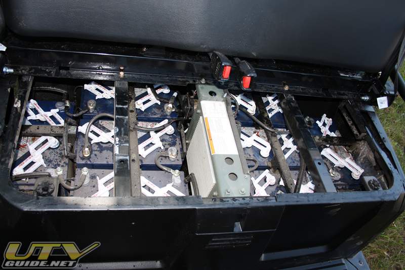

Can your electric Ranger handle water crossings. Polaris says not deeper than the floorboards, the motor is not waterproof.
It's obvious with combustion you have air intake and exhaust issues. Is there a fully water proof compartment to hold the batteries? No, they are under the seat.
If not, how deep can you get before there is shorting or worse? I'd guess around 18".

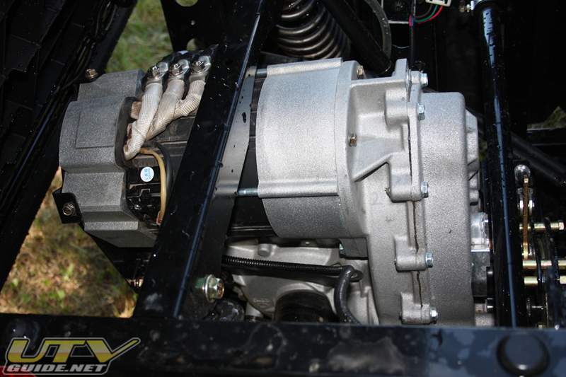

It may also be worth noting the location of your transaxle vent.
   / Electric Polaris Ranger
#64
Yep, I think the front differential vent would be the same as all the ranger mid-size models.
I'll have to check on the rear. I have not read anything about it being a problem, on the Ranger Forums.

Bought mine yesterday, supposed to be delivered tomorrow. XFax, I sure hope I have as good of an experience with mine as you have evidently had with yours! I relied heavily on your good experience in making up my mind between the EV, Kubota RTV400 or 900, and Kawa Mules. In the end, we both just REALLY wanted the near-silence.
Planned to buy new, but the local Polaris dealer had a "demo" that just sounded and looked too good to be true (and probably is). He asked $6k for it. He allegedly bought it through a Polaris factory dealer-only auction. 2010 model. 38 hours on the meter. :confused: Supposedly used by the Polaris engineering department for in-factory jaunts/errands. My hunch is that the engineers disabled the hour meter. 38 hours in SIX years???
But everything I inspected looked quite good except for the batteries, which the dealer had just replaced with non-OEM "blems". Don't even fit the hold downs correctly. I figure for the price difference between it and new, I can buy two or three sets of batteries. Tires pretty good, a bit of corrosion/rust but just in a few spots on the battery sub-tray. So hopefully everything else holds up well. It sure runs and rides great. I sure see what you mean by the TORQUE! That sure seems like more than a 30hp motor.

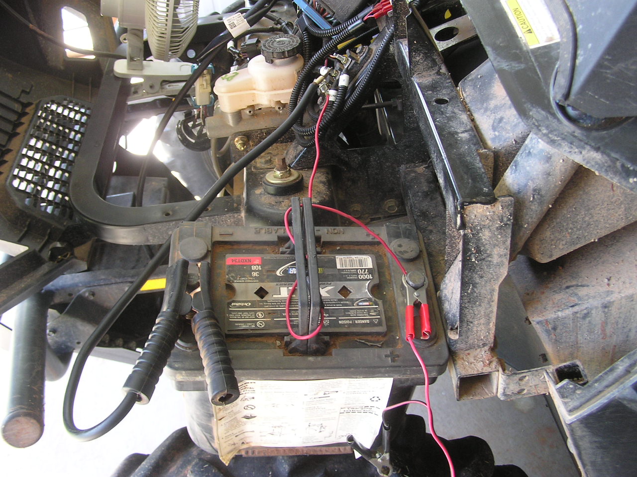

First thing to check, see if the original battery charger has been replaced with the new style, it will have two cables coming out of the side, not one.
Second thing, change the charging algorithm from 73, to 11 or 71, to prevent boiling the water out of the batteries: Algorithm - Page 3 - RangerForums.net - Polaris Ranger Forum
Check the electrolyte level once a month, I use a 60 cc syringe with a short piece of vinyl tubing on it to add water.

Thanks! It does have two cables on the "output" side. The one ac line input on the opposite side.
I'll change the algorithm today. We won't ever be in a big hurry for quick charging.
I found that the charge status indicator on the dash is out. The one on the side of the charger is working fine, and there's voltage to the dash indicator, but it doesn't light. Looks like about $60 on-line!!! I'll try to convince the dealer to buy me one.
