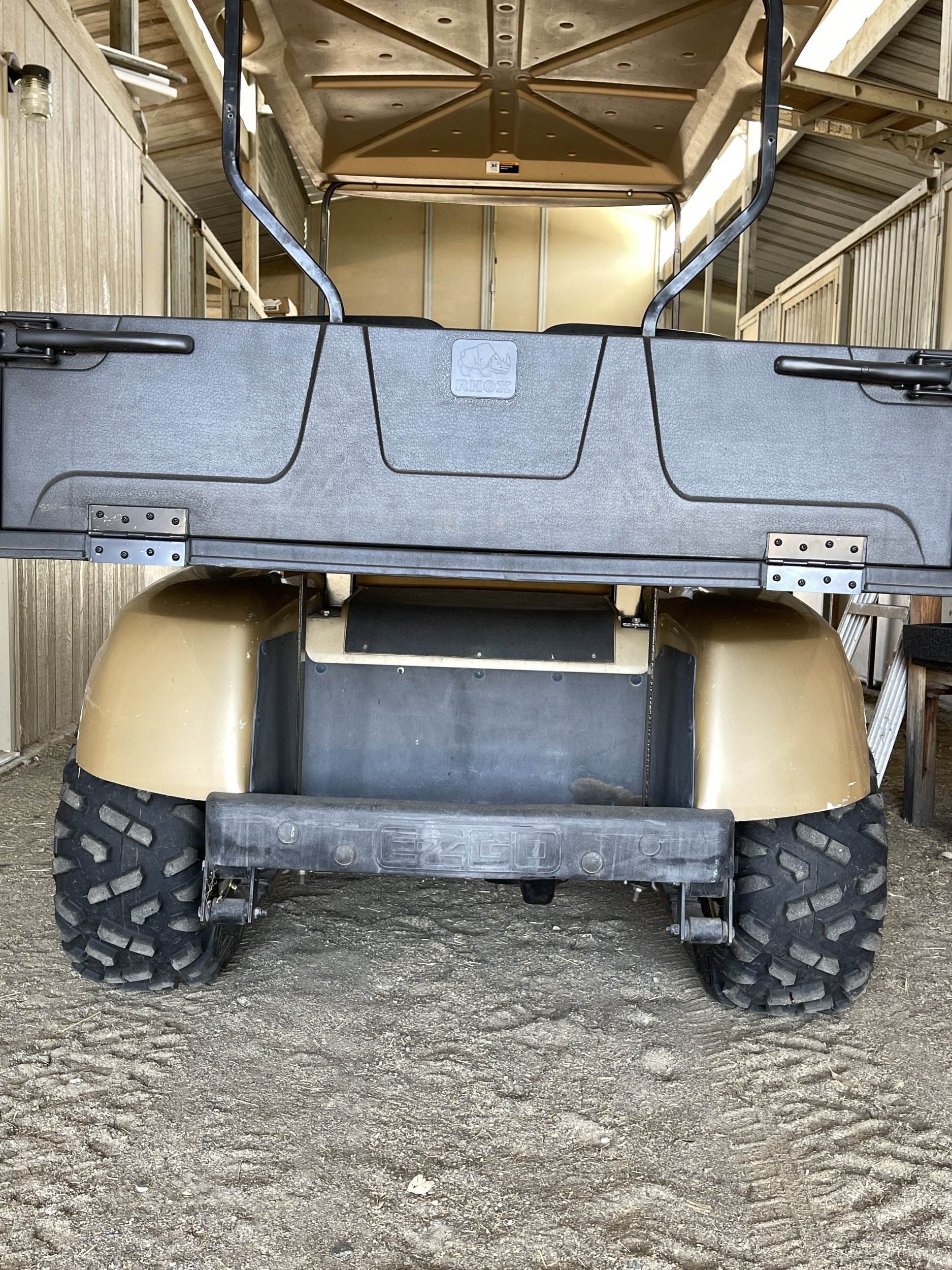

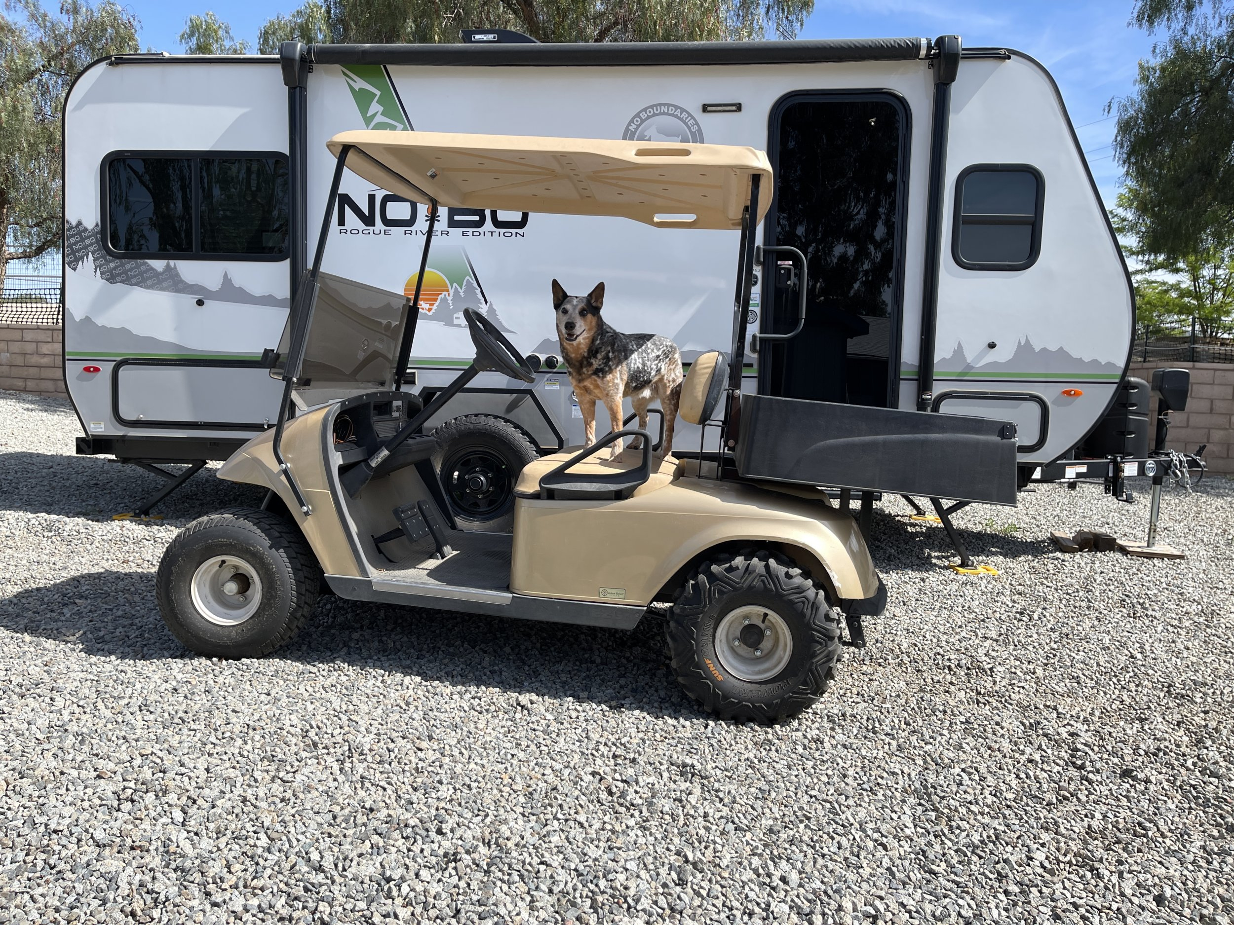

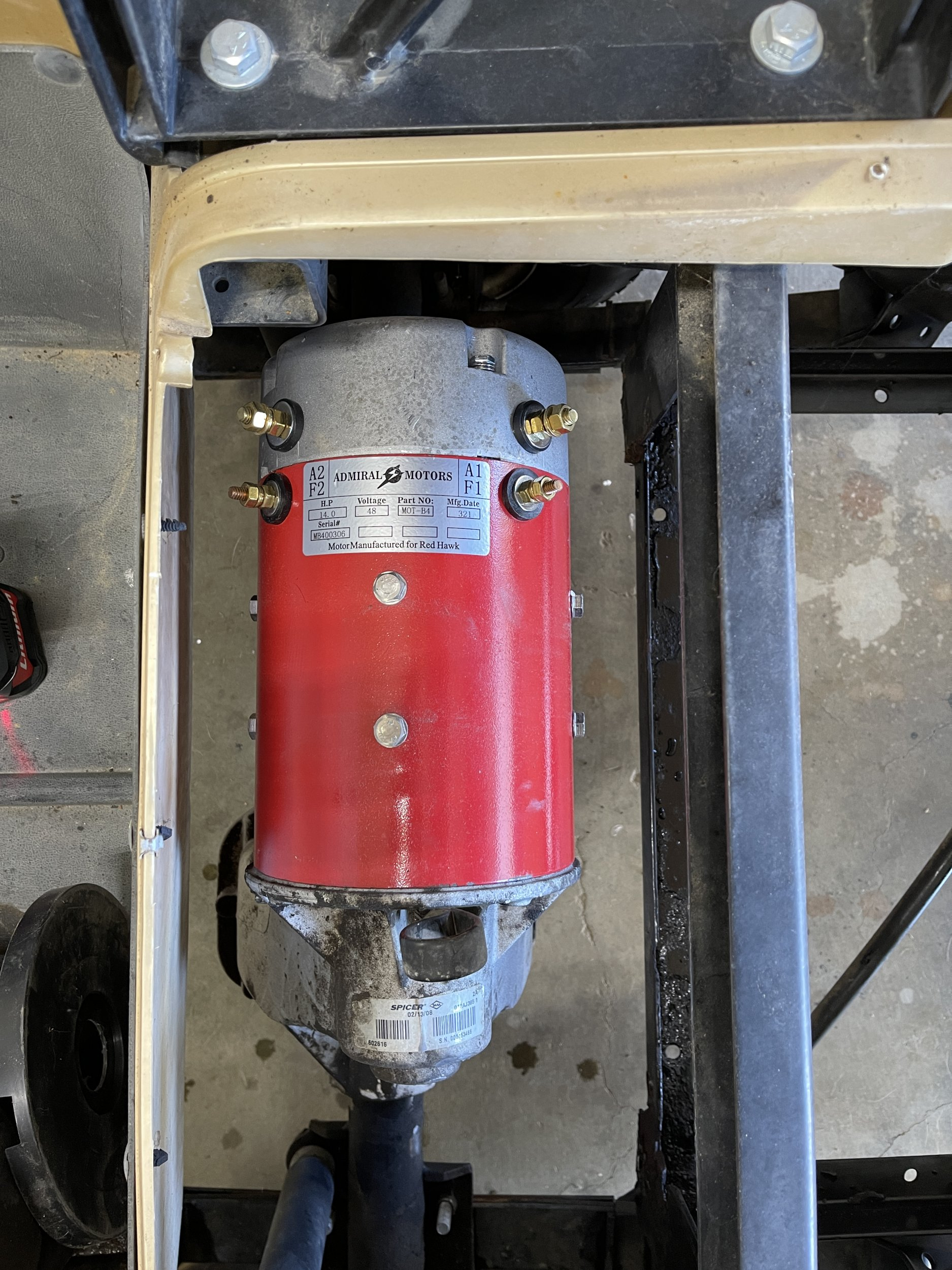

Just buy a golf cart (EZ Go) and call it good. Much cheaper.
Ezgo 500 amp control, 14hp long stack motor, Lithium 51V Battery goes everywhere I want to go for less.

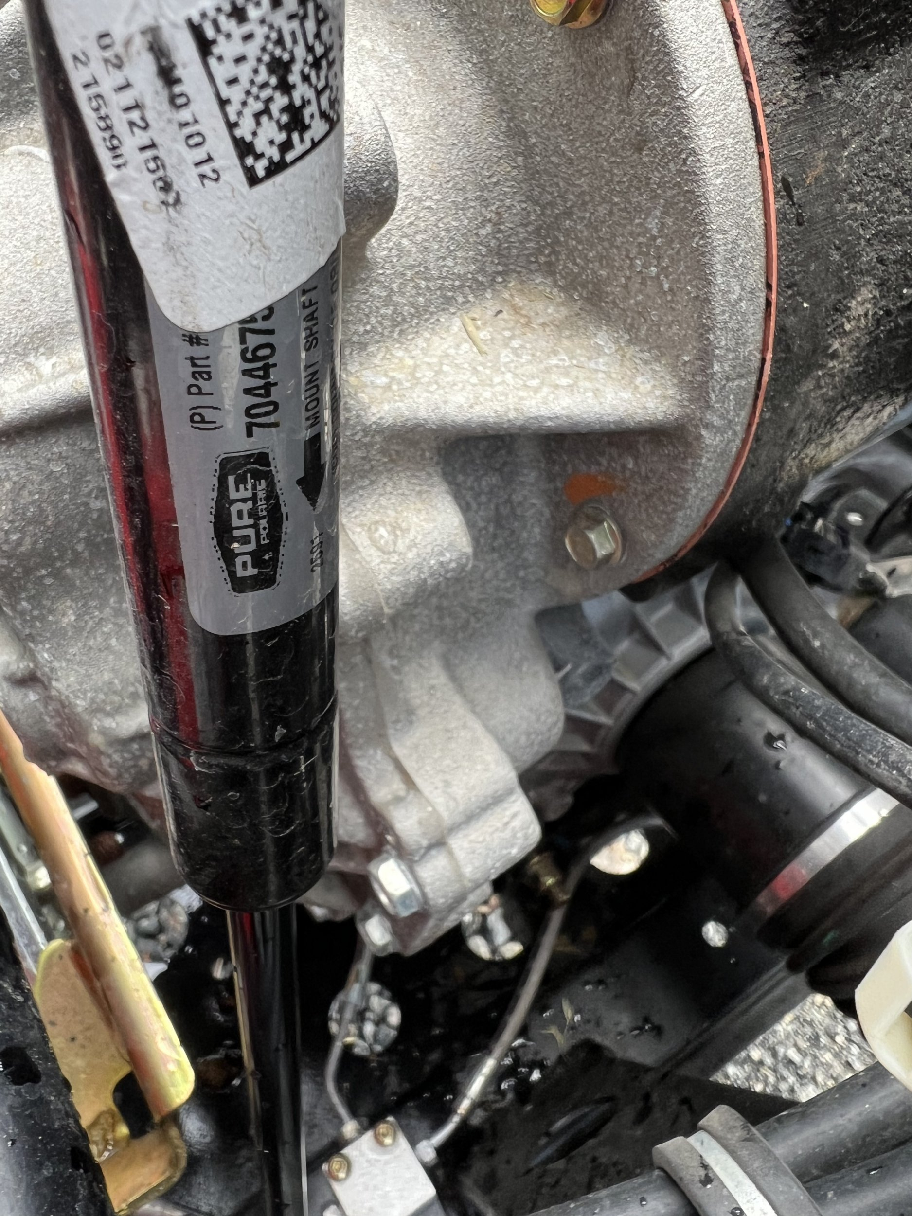

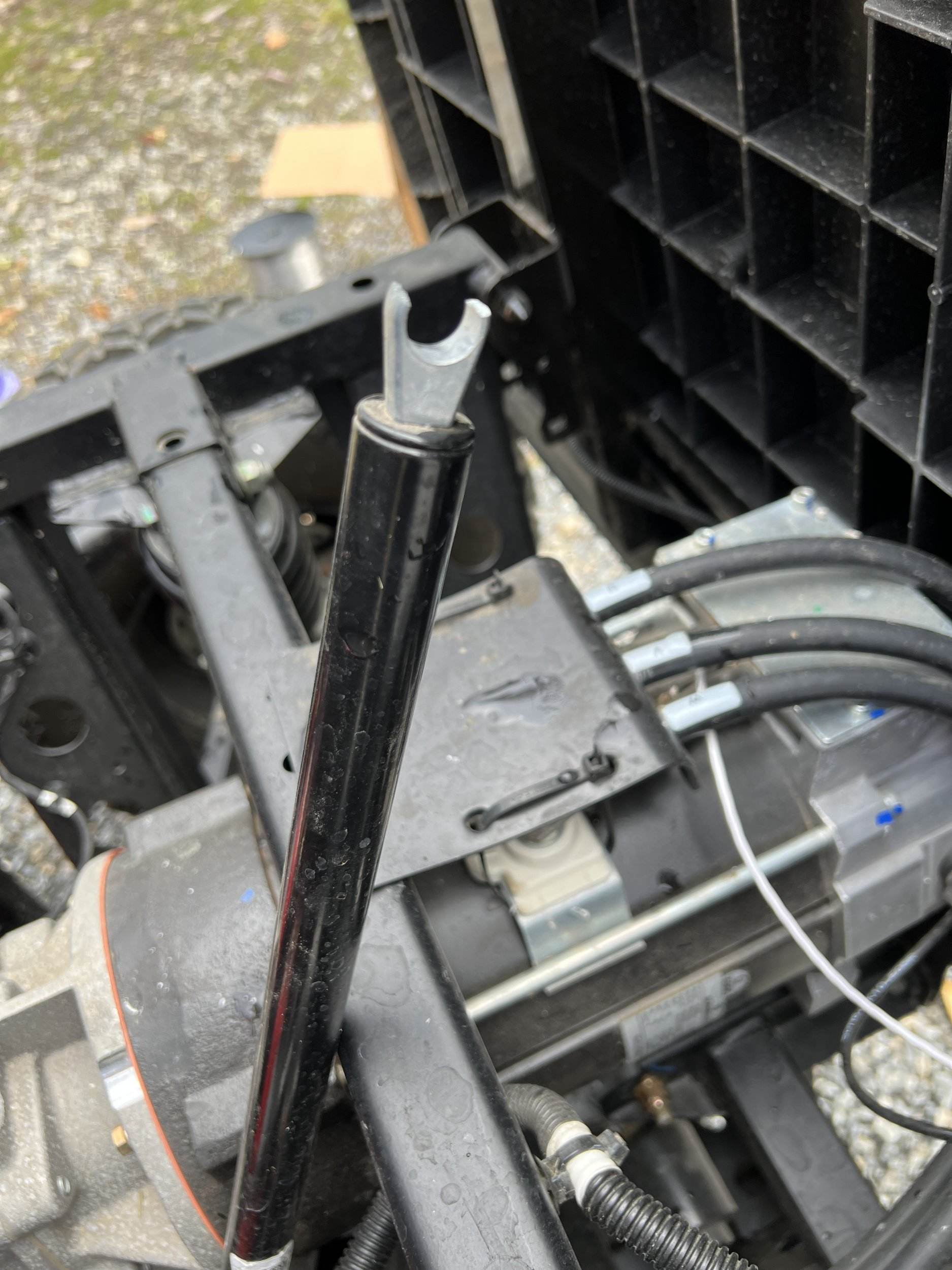

I'm feeling a bit salty with Polaris. The hydraulic lift broke on my EV dump bed. They ordered the part at the local dealership and are insisting that I bring the vehicle to the dealership to install this part which has two pins.
It's going to cost me sixty in fuel to haul my trailer over there and more importantly, I just had back surgery and cannot drive for at least two weeks.
First, that was some cheesy metal to snap off in under a year and second, that's just poor customer service.
Other than that, it's been a good year, but it's developed several creaks that greasing all the points I can find doesn't address.
Off to call Polaris.

Odd break for a casting that's mostly in compression. If the casting doesn't look defective, then maybe the cylinder is still pulling after the bed is fully down on the frame. In that case, the next cylinder may fail too.

The part number is 7044675. It is $64.99 from the manufacturer. I'd spend more than that in diesel and time hauling it over the mountain to have the part replaced.
Once I realized that Polaris will not budge on the warranty "rule", I did a quick Google on the part.
And look here... An aftermarket fix.
And it adds a limiting cable.
We already drilled a hole in the end and Jerry rigged a solution while waiting on the part.
Not sure why I was so dead set on American made at this point.
Bunch of drones repeating the line of had to be installed by dealer.
Super unimpressed with Polaris.
