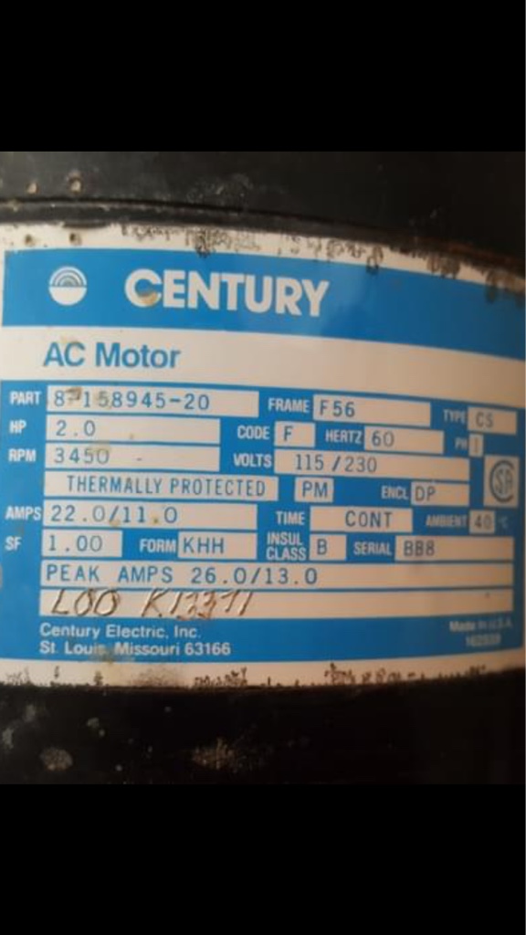

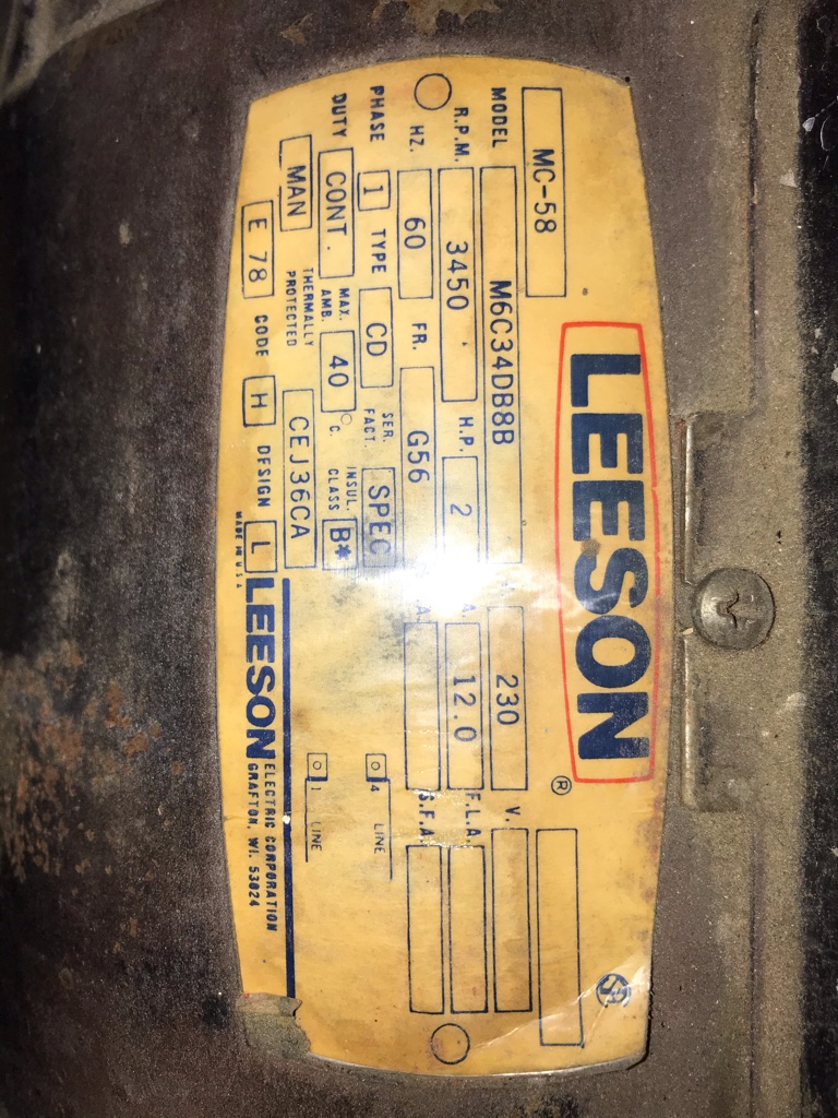

I have two motors available for around 100 bucks that I’m thinking of using for a electric splitter project with an 11 gpm pump.
For those who know,
Which of these two motors would be the “better” motor all other things being equal?
This is one of those “play with it” projects.
Lenny
/ Electric motor questions #2
The Leeson is probably a better quality. Other than that they are equal in output.
/ Electric motor questions #3
They’re both 3400 rpm 2 hp. I’d take the leeson with everything else being equal. But you probably need more power. An electric will handle a high toque load better than a gas motor but I think 2 hp is still undersized.
