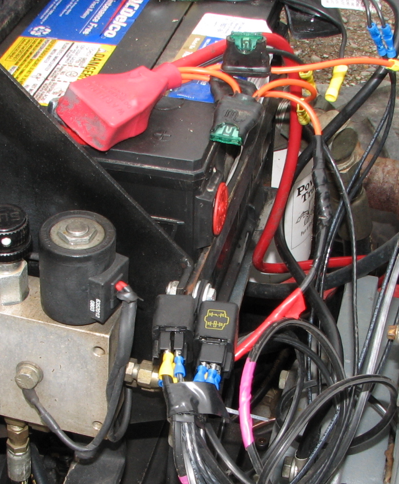

I have an electric fuel pump sitting on my bench waiting to install. I was just going to tee it off the wires to the cooling fan, hope it doesn't get above the fuse limit.
I guess I really should install a relay that is triggered by that wire, with power (through a new fuse) from the battery. Unfortunately the engine compartment isn't the best environment for electrical installs. Need some sort of closed up box to keep everything from getting dirty.
/ electric fuel pump on 425 #5
You mean you do not want it to look like this:
Ken
/ electric fuel pump on 425 #6
That picture is from 2007 and I have had no problems. 12V relays bolted to the battery box and blade fuse holders on some of the wires.
Ken
/ electric fuel pump on 425 #7
You gotta 'splain what all those wires are to. I rewired for higher power lights (relays) and some other little things but it is all buried under the dash. One day I wil ltake that wiring diagram that was made up for us and apply it... simplify and improve the PT Wiring mess.

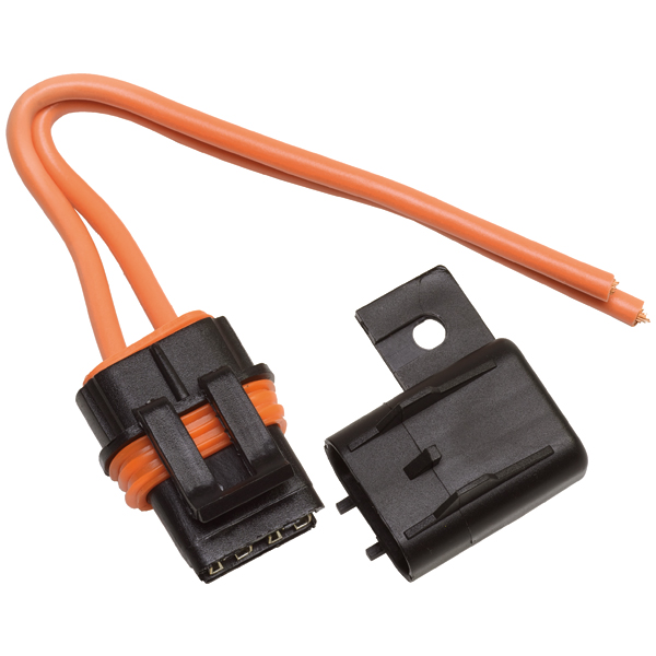

/ electric fuel pump on 425 #9
FWIW: I tend to use marine fuse and relay holders that are waterproof (and dustproof). I hate running down intermittent circuit issues due to oxidized or grounding issues.
Cuts down on corrosion at the fuse as well.

Those are neat fuse holders. I have never seen ones like those. Mine have lasted 10 years but if i need to replace them, i will.
Ken
/ electric fuel pump on 425 #12
Well I did a slipshod installation of an electric fuel pump. Spliced into the wire that provides the oil cooler fan (and the extra side fan that I mounted). No blown fuses yet.
This fuel pump:Amazon.com: Airtex E117 Electric Fuel Pump for Onan Generator Set: Automotive
This pressure regulator: Amazon.com: Mr. Gasket 971 Fuel Regulator: Automotive
So far it is working well. I needed to do it in a hurry because my lawn was getting tall, and my old mechanical fuel pump was dying, so I tie-wrapped the fuel pump to the inside of the back of the expanded-steel engine cover at about the level of the air filter. One hour of use later, I am happy with it.
Maybe I will spend some time to put in a fuse/relay box and wire and mount it properly. But more than likely, I will leave it tie-wrapped in place for at least a year....
