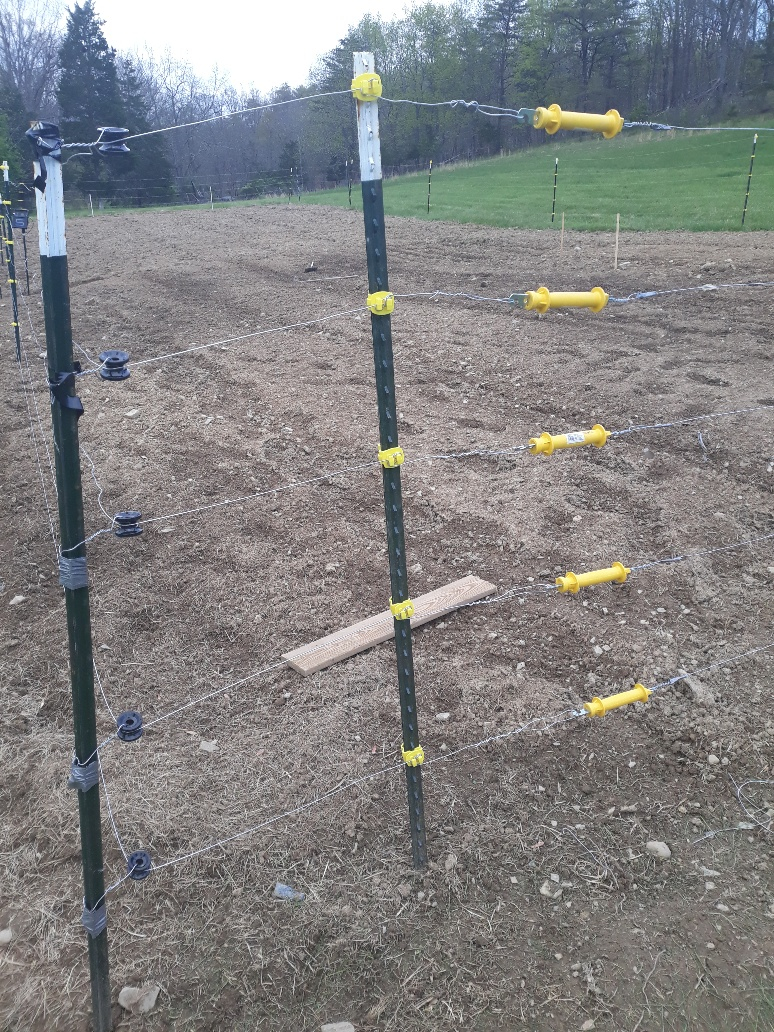

I bought this one - after I kept losing or misplacing several others. It seems to work - and it also provides information on how much the charge is - unlike the ones that just light up. So far so good.

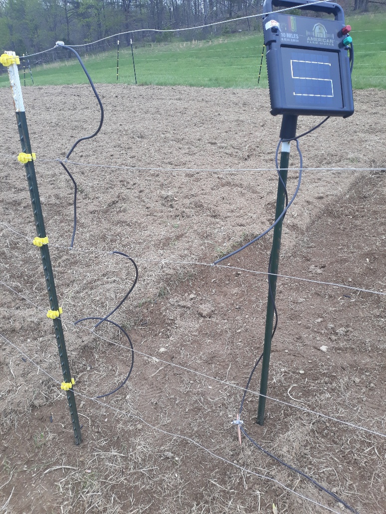

No neither one is clicking. I did take the battery out of the Zareba and put it back in. So, I know it is hooked up. But did not look at the other battery but guess I should. But again, neither one is clicking. Oh, it lights up the battery must be connected,.

I just brought it in the house and banged it around a little. (how I fix most stuff) Believe it or not, it is now showing voltage & shocks to the touch. But the shock is not real offensive to me. Just touching both terminals, not like standing on the ground touching it,. and a deer has four feet on the ground. Will put it back on the fence tomorrow and see what it does.

Neither one of these click. The lights just flash. I don't think these are designed to click, like others I have seen. I never checked the battery voltage. The tractor supply one is working now , the light blinks and it does shock some, but not as hard as I Remember getting hit by electric fences over the years. It does light up the tester now.
/ Electric Fence? #52
If you are grabbing directly on to the terminals of the solar energizer that thing should light you up to the extent that you wont even want to walk by it. something is wrong with the energizer.
