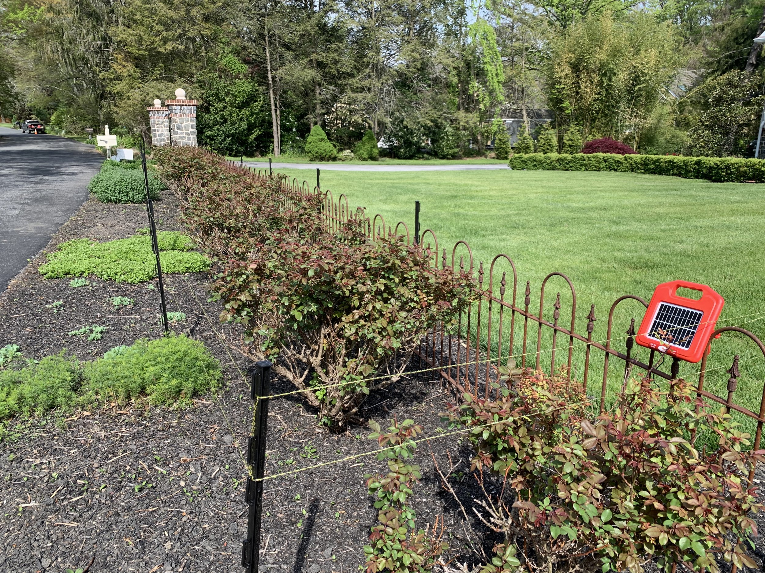

I used a 3 wire 4 ft tall electric fence for about 11 years around the big garden down below. Only troubles I had was with controllers going out until they made electronic ones. Had a utility battery, small solar panel and controller.
Went I brought the garden up to the house in raised beds, I fenced the back yard with the same fencing. Hooved rats would regularly jump it and get into my raspberry patch, not so much the raised beds.
Finally went to 2 rows of fencing like in the picture with nylon ropes: 2 ropes with a single outside. Worked to keep the hooved rats off the daylillies and camellia all growing season. When last winter's snows came, the rats got in and destroyed the camellias. Saw some hooved rats early this spring in the raspberry patch again. Shot one of the 3. Found my battery dead. With one shot rat and battery charged, no more have shown up. The wire fence around the rest of the back yard is like the nylon rope fence now. Some of it is still 3 wire in the one row but with the single wire outside.

Only time they got in down below with 3 wire 4 foot tall fence for 11 years was when one of my controllers went out or a battery because discharged below 6 volt.
The only time they really get in up here with the dual fences is when I let the battery go below 6 volts. Or in the snow when it shorts everything out.
