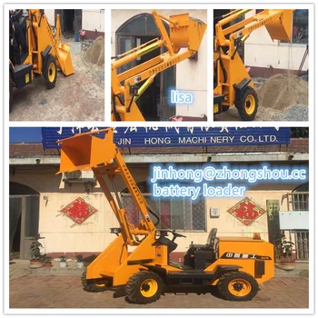

A hydraulic drive machine has to be the worst application for an electric motor,,, WAY TOO much energy is lost,,
The machine needs to be gear drive first, and foremost,, because you have so little stored energy to start with,,,
Intermittent operation of the hydraulics will be marginal,, current electric/hydraulic power sources have VERY low duty cycles,,
The Power Trac is truly a design that needs LOTS of energy,,,
Of course, you could go back to the roots of the design of the Power Trac,, and pull a 6KV power cord,,
If I wanted an electric one, I would drive to the town Power Trac is located in,,
and,, buy a used battery powered one for a few thousand dollars,, it might need new batteries,,,
Of course,, it might be a little low to the ground,,
EST-1030-Electric-LHD-powered-through-a-trailing-cable-Courtesy-of-Atlas-Copco_Q320.jpg
This one says it is battery powered,, but, that looks like an engine on the back ?? :confused:
