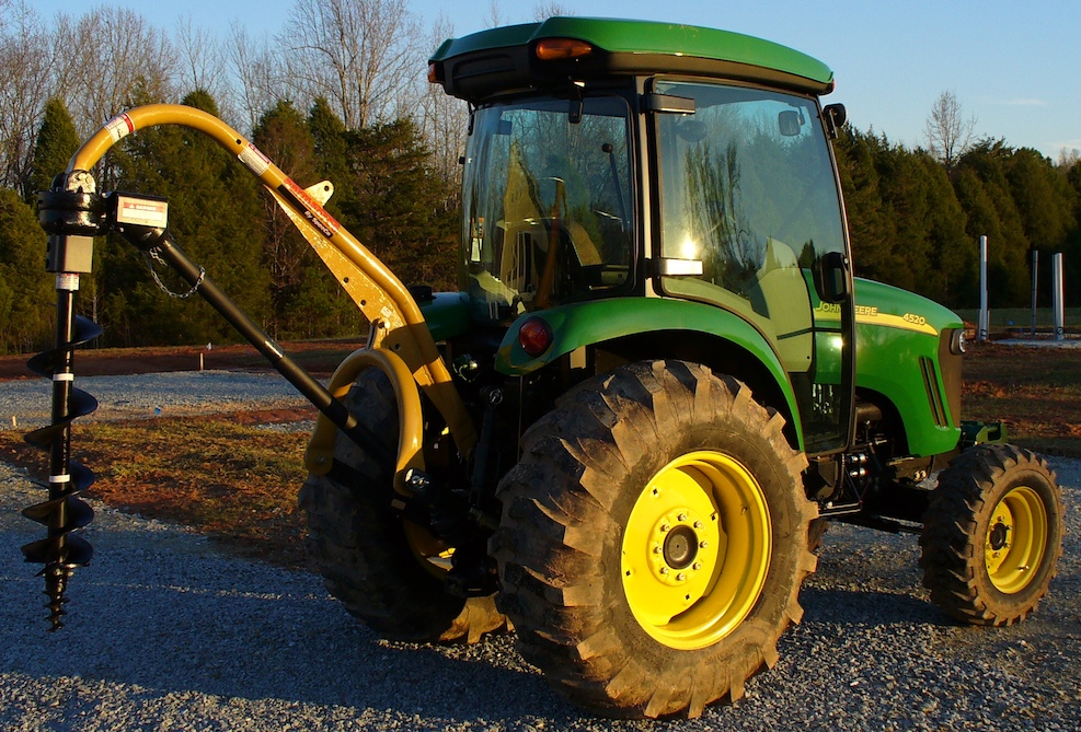

Update: Got PHD on tractor, played with it a bit. Since the predominant opinion was that slower is better, left PTO in normal gear (Not e-pto) and ran tractor down at 1200 RPM. Digging in the North Carolina red clay was easy, tractor didn't bog down. Speed was not a problem, I slowed it down more than anything by how fast I would drop the rig. Didn't even try the e-pto since the control on the low speed was great. Might do a test hole sometime with e-PTO
Had to pick up the RPM at the end to try to get the dirt out of the hole, and it's an odd dance of higher RPM and lifting the PHD while being sure not to get all the way out of the hole. Still had about 6" of dirt in the bottom, suspect that's just technique I'll have to work on.
The auger would "auger in" by about 2-3 inches, then pop up at this low speed. Might try a few more RPM once I get the hole about 6" deep and see if it still augers in. Not a problem. Tractor size/weight/HP made it all easy. The tractor was in charge, not the PHD.
Thanks to everyone for their advice, it was right on the money. It was a great discussion and good data on E-PTO vs. Normal PTO. I still want to get the torque curves for the engine. Maybe I'll ask my dealer. Now if the ground around here every gets hard again, I've got about 50 holes to dig.

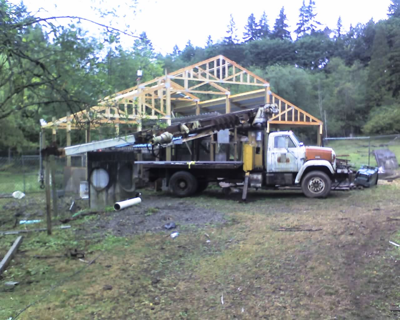

I like my drill here next to the barn I'm remodeling.
