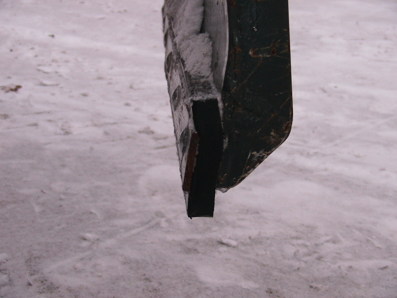

If you look at the picture that shows the side view, you will see that the tire's cross section varies significantly as you move from the thin sidewall (3/8") to the thick edge of the tread (7/8") to the relatively thin center of the thread (1/2"). I didn't realize that this would be so before I cut it, and I was kind of upset at what I wound up with, but the thick section actually seems to keep the rubber edge from rolling under the moldboard. It also gives you something of a cusp on the cutting edge side. I like your idea of the backing strip - if I notice the wiper starting to flex back too much I'll try that out.
Another thing - the section of tread was actually only 6" wide, not the 8" I had intended. I'm keeping my eyes peeled for a wider tire to get a full 8" section that I can flip over to get a second edge when the first one wears out.

I finally got a pic of the "sandwich" of my rear blade, the rubber edge, and a special retaining strip. Because I did not use my cutting edge I am able to leave less rubber exposed and I believe it will be stiffer because of it. I got to use it a bit today for the first time and more snow is predicted. I am so excited. I even cleaned off our front deck with the tractor. :eek::D:D:D
