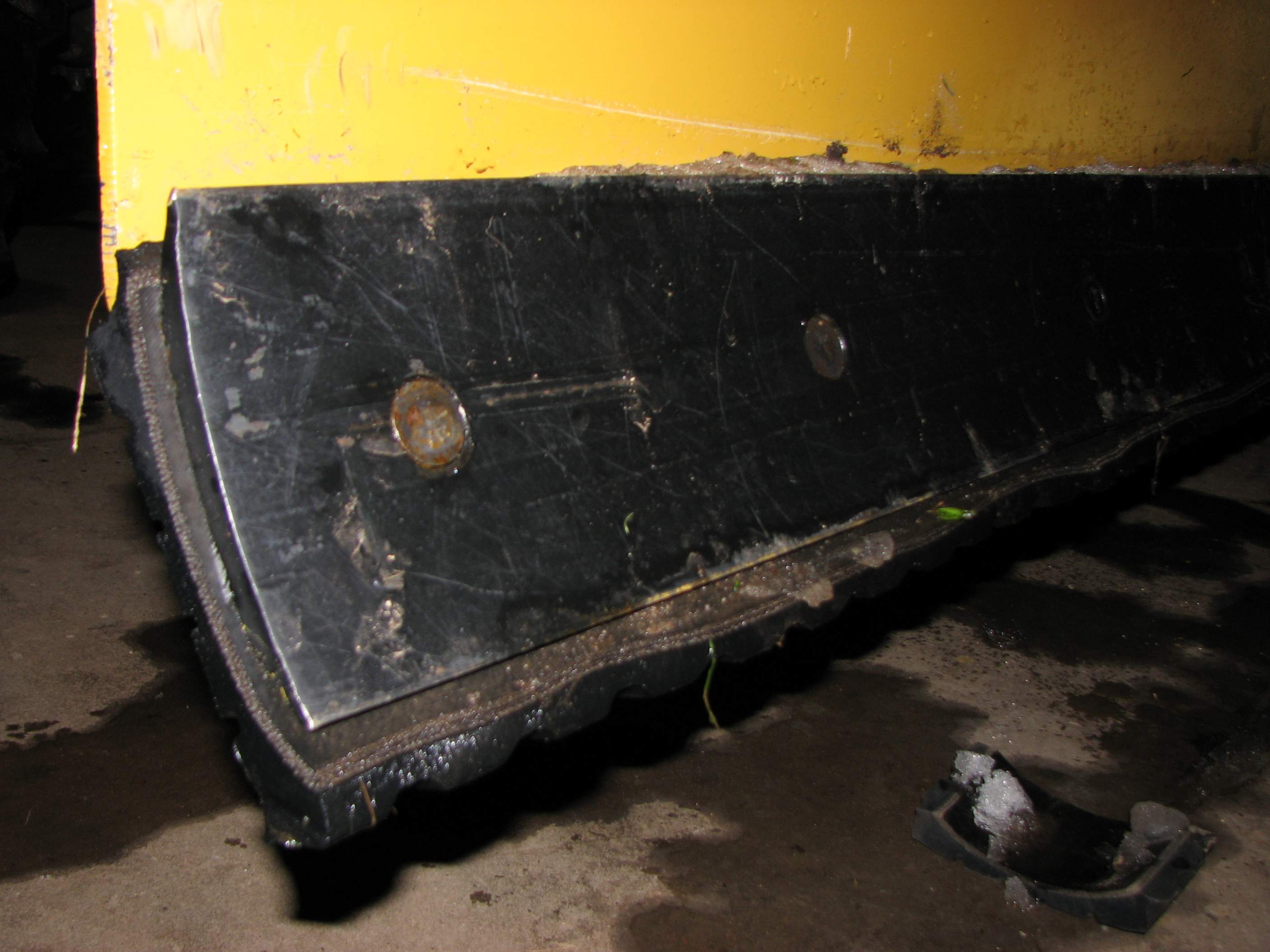

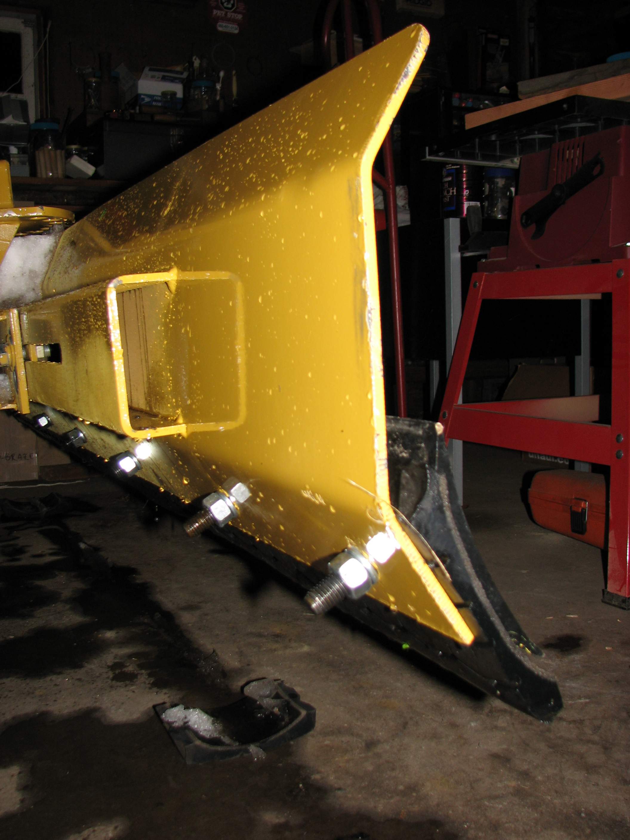

I got interested in doing the squeegee thing to my new 7' rear blade after reading this thread, but couldn't find any substantial belting at the local TSC, so I gave up and went home. That afternoon, The Plant Manager asked me to move the old tires up in the loft over the garage down so we could put them out for trash pick up. I said "are any of them big"? She said "yes, ones pretty big". So I drug down the tires to the street, except for the big one, which measured about 30" in diameter. Cut the sidewalls off with a reciprocating saw and slit the resulting loop of tread to get an 8x80" strip of 1/2" thick rubber. Took the cutting edge off the back blade and used it as a template to locate the bolt holes with a marking crayon. Drilled eight 5/8" holes through at the marks with Grampa's old brace & bit then ran out to the hardware store for 8 5/8-11 2" grade 8 plow bolts. Made it before they closed. Bolted everything back up and it looks great.
Total cost: about $28.
Satisfaction: priceless.

how about a picture of your "creation?" I suppose that with a tire that there would be less of a tendency for the bolts to pull through the rubber, because of the plies in the tire. But in my opinion you probably should have a backing plate to "sandwich the rubber. Maybe you used your cutting edge for that.

It was a sandwich job: tire tread between the moldboard and cutting edge. That's why I needed to get longer plow bolts.
I have yet to figure out how to post pictures, but I'm working on it ... So far I have some pictures on a Picasa site. Next chance I get I'll try uploading.

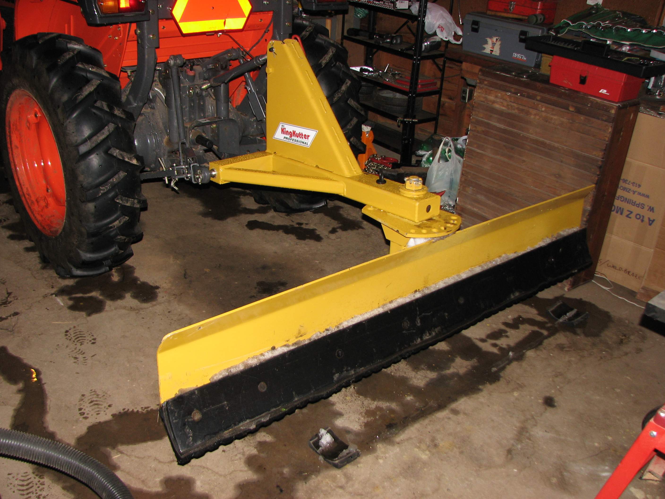

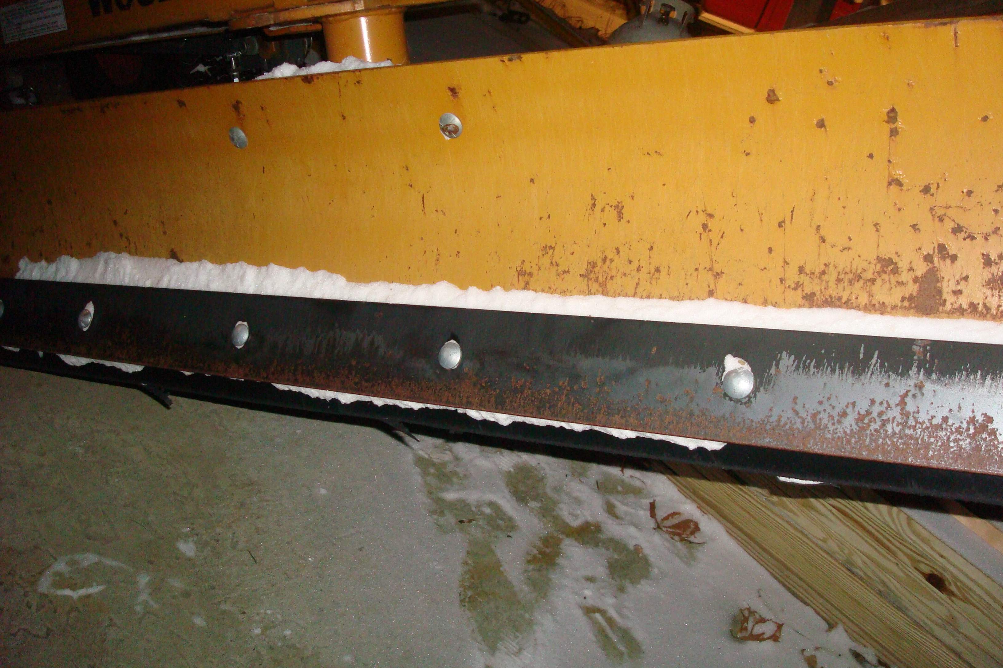

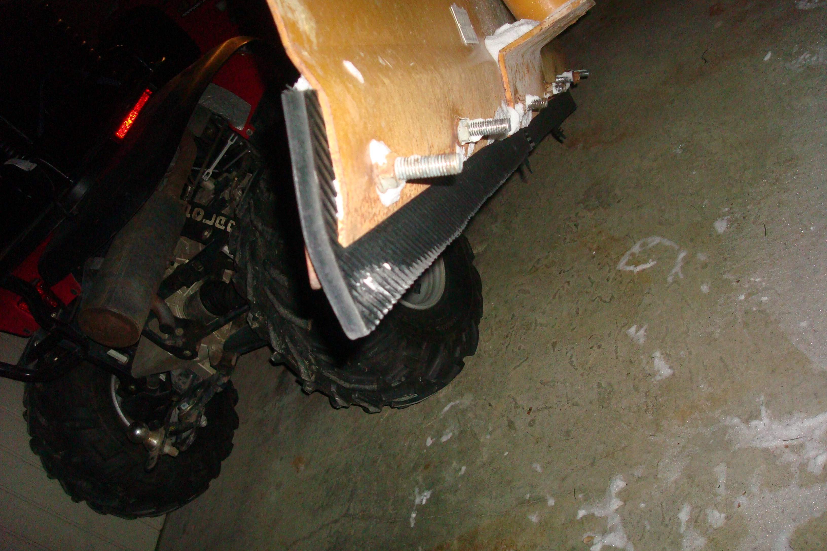

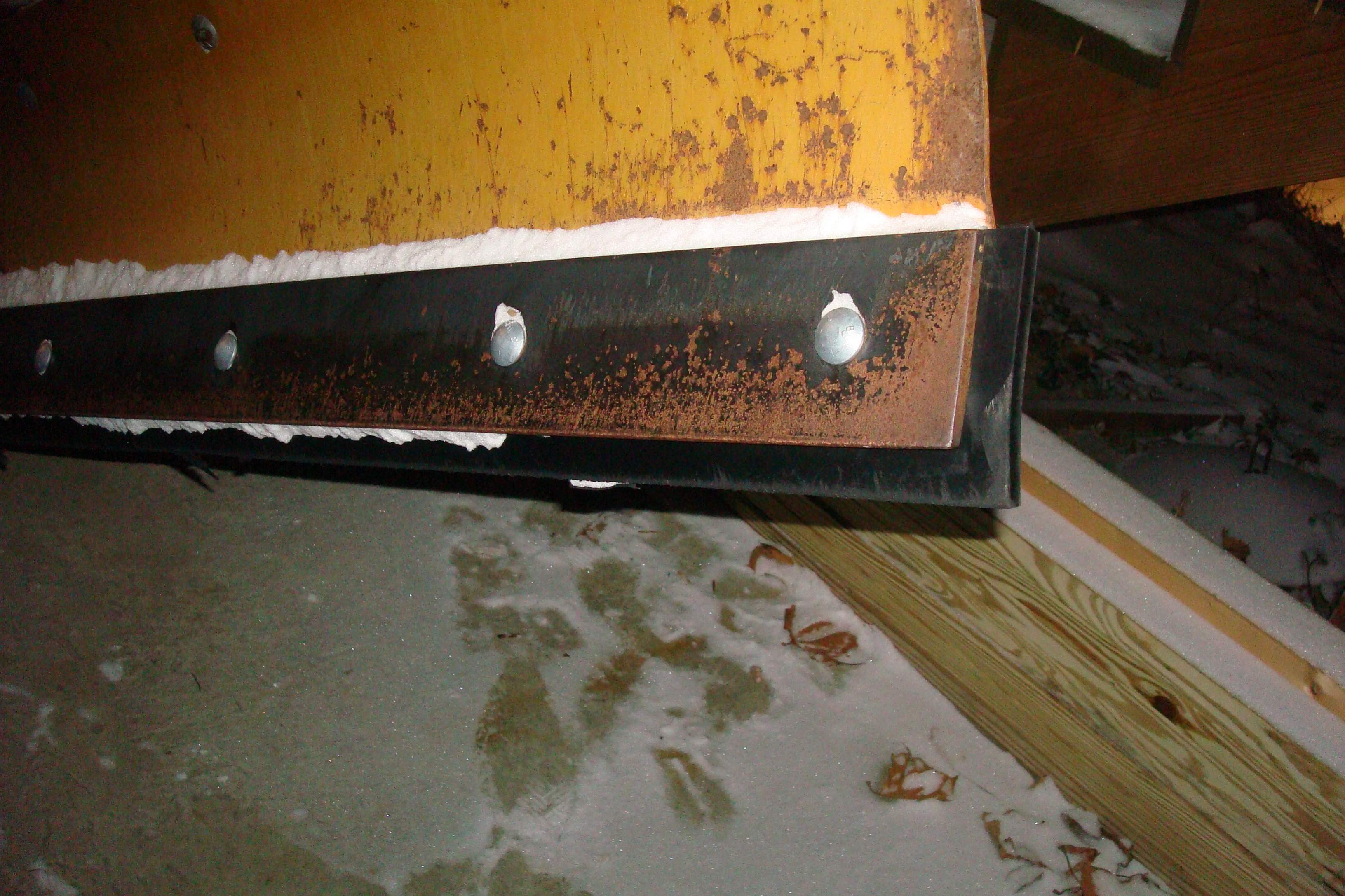

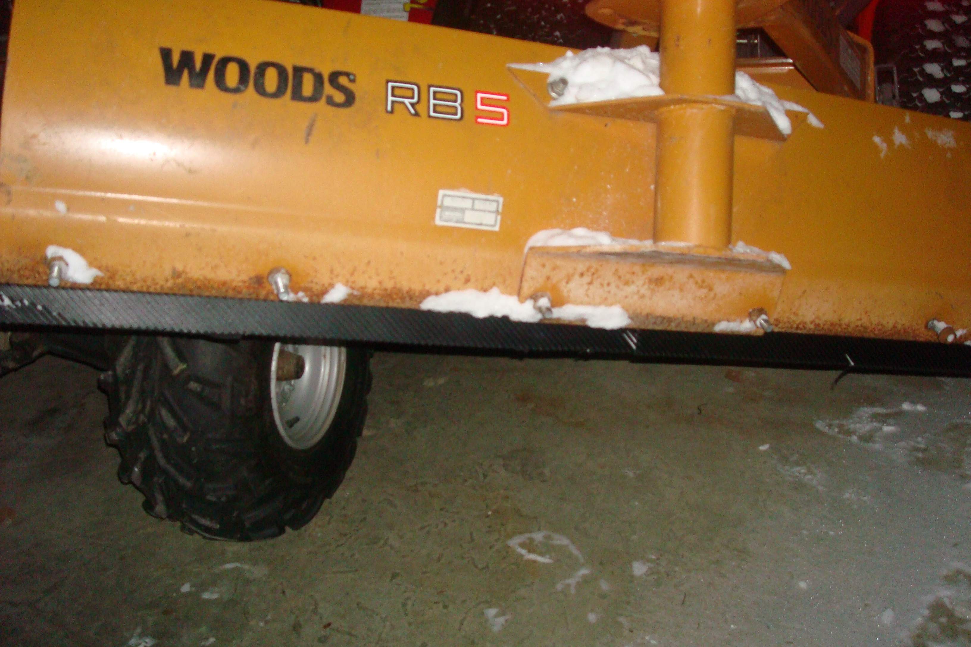

Here is how mine ended up. still have enough mat to make another one. Please note that you end up with two pieces to get the width but it does not matter since it is sandwiched between the steel.. I cleaned 7 drives this morning. very little wear so far.

Thanks for the help with pix posting. Used the blade a lot in the past few days and it worked out well. No apparent wear so far.
-Jim

Very nice Jim. That is taking what you have and putting it to a very good use. Did it seem like th erubber bent back enough to allow the metal cutting edge to ever hit the ground? I am curious be cause the rubber must extend a long way below the mold board to clear the cutting edge without support.
On mine I made a special retaining strip that was the same length as the mold board and therefore the rubber extended only as far as the original cutting edge. I need to post a picture to show what I am talking about.
