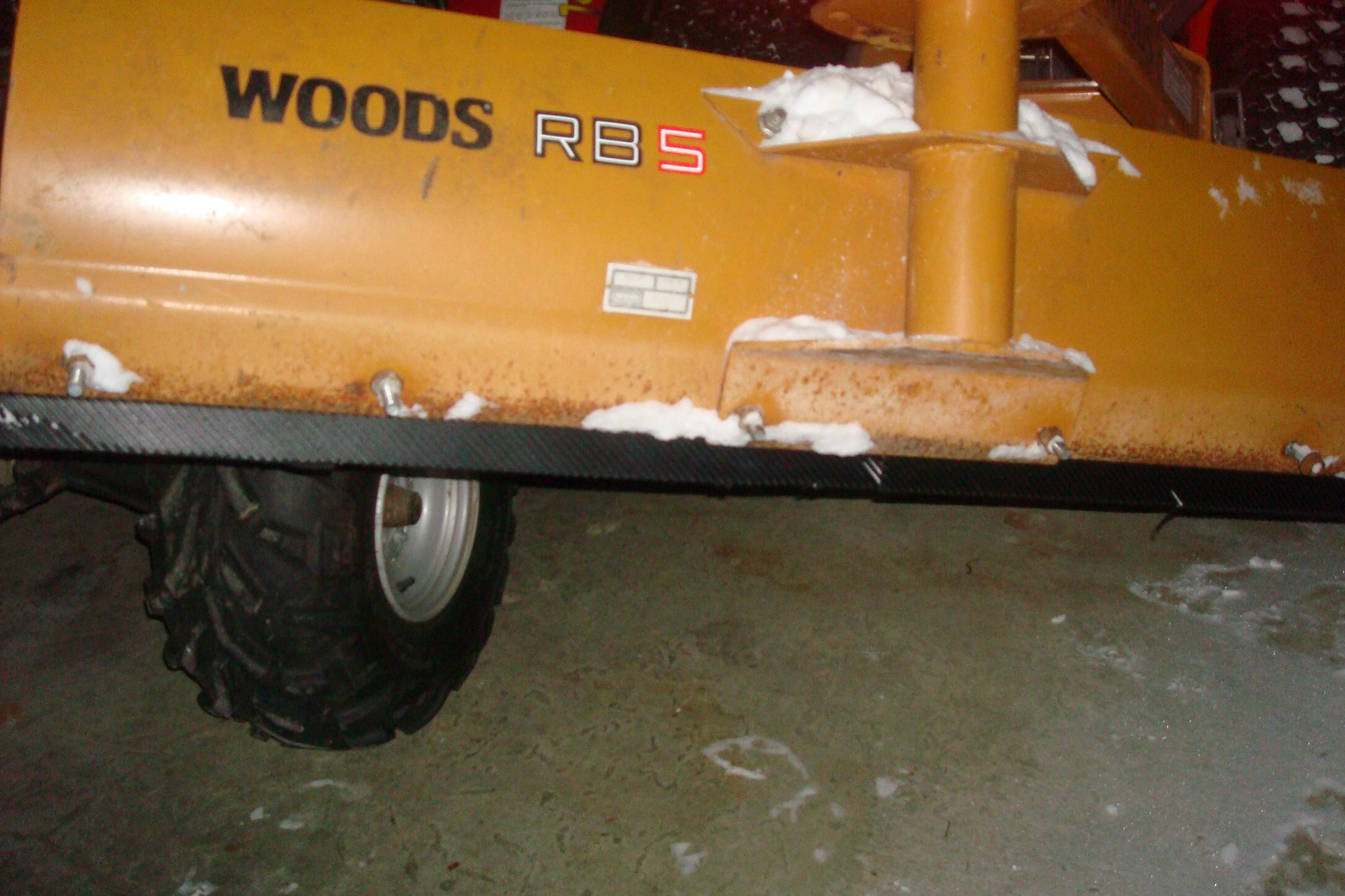

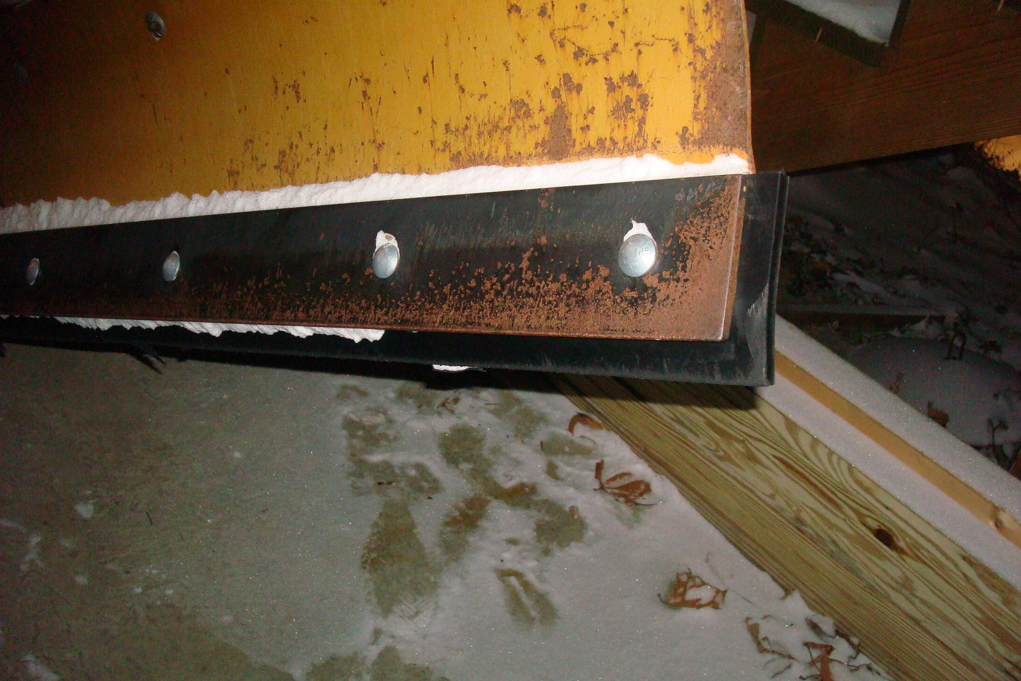

Here is how mine ended up. still have enough mat to make another one. Please note that you end up with two pieces to get the width but it does not matter since it is sandwiched between the steel.. I cleaned 7 drives this morning. very little wear so far.

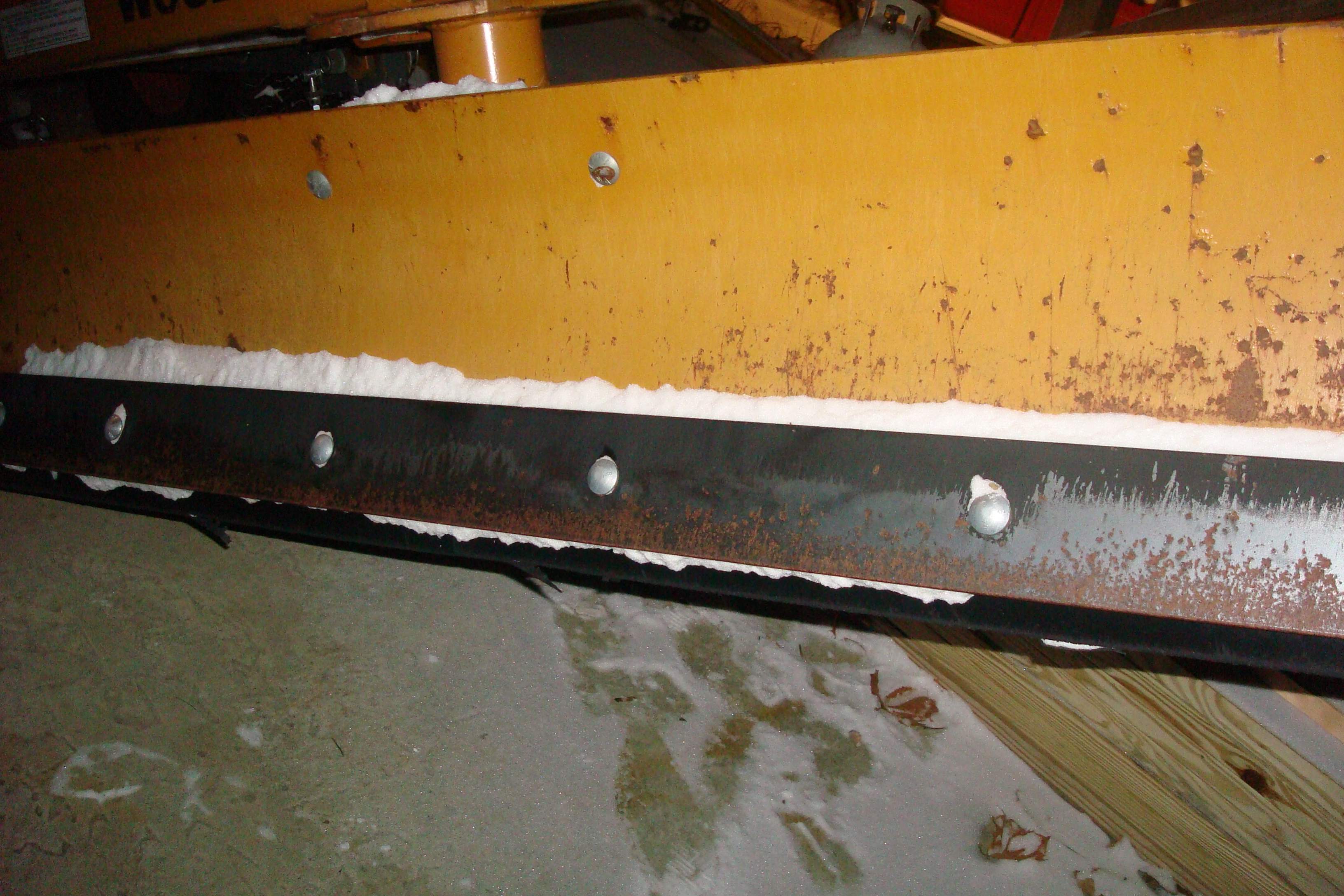

Thanks for the help with pix posting. Used the blade a lot in the past few days and it worked out well. No apparent wear so far.

Very nice Jim. That is taking what you have and putting it to a very good use. Did it seem like th erubber bent back enough to allow the metal cutting edge to ever hit the ground? I am curious be cause the rubber must extend a long way below the mold board to clear the cutting edge without support.
On mine I made a special retaining strip that was the same length as the mold board and therefore the rubber extended only as far as the original cutting edge. I need to post a picture to show what I am talking about.

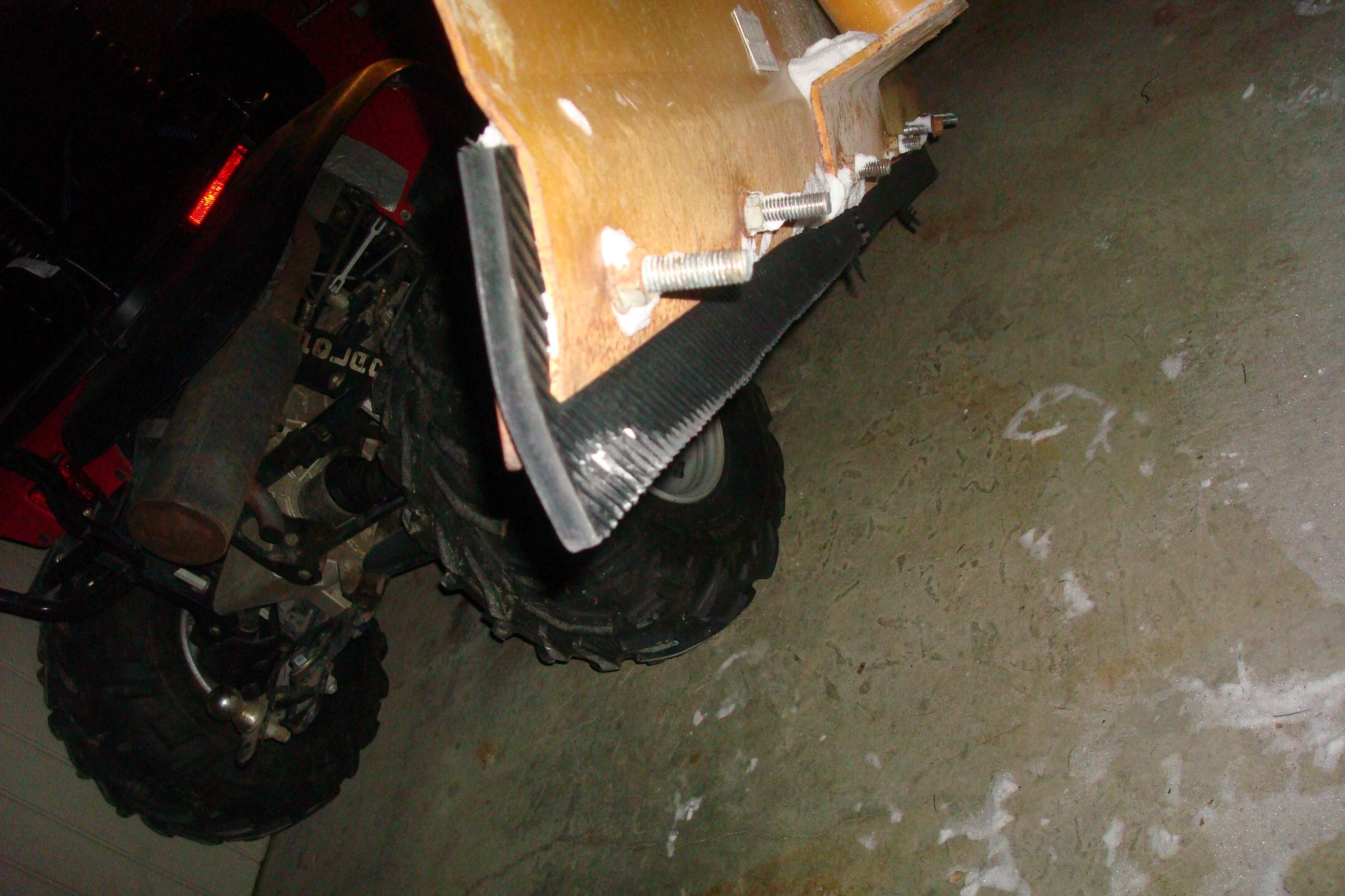

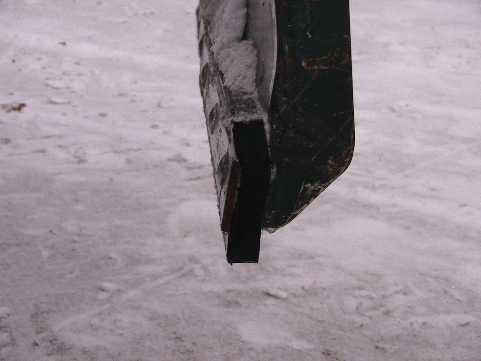

It was just a fine pitch hacksaw blade. A coarser blade would have probably worked a lot better. This tire wasn't steel belted, so next time I want to think about what kind of tire I'm cutting before I select the blade. To get a straight edge (I didn't do so well) I picked a feature on the carcass, just where the tread runs into the sidewall and sort of tried to keep the kerf on it as I went around. My attention span is not long and I found myself wandering all over the place, but it was close enough for a first pass.
Mike-
Thanks again for the help. Now I'm posting pictures all over the place. You may end up regretting this.
If you look at the picture that shows the side view, you will see that the tire's cross section varies significantly as you move from the thin sidewall (3/8") to the thick edge of the tread (7/8") to the relatively thin center of the thread (1/2"). I didn't realize that this would be so before I cut it, and I was kind of upset at what I wound up with, but the thick section actually seems to keep the rubber edge from rolling under the moldboard. It also gives you something of a cusp on the cutting edge side. I like your idea of the backing strip - if I notice the wiper starting to flex back too much I'll try that out.
Another thing - the section of tread was actually only 6" wide, not the 8" I had intended. I'm keeping my eyes peeled for a wider tire to get a full 8" section that I can flip over to get a second edge when the first one wears out.

I finally got a pic of the "sandwich" of my rear blade, the rubber edge, and a special retaining strip. Because I did not use my cutting edge I am able to leave less rubber exposed and I believe it will be stiffer because of it. I got to use it a bit today for the first time and more snow is predicted. I am so excited. I even cleaned off our front deck with the tractor. :eek::D:D:D
